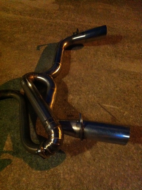

2 Attachment(s)
Attachment 16464
Attachment 16465
Here's mine. Stainless. About $100 in material and too many man hours.
Do you notice exhaust flow favoring one tip over the other?
Hardrock4445 09-29-2012 10:11 AM
By doing just a "hand" test no noticable difference. Was going to do a center split but didnt have time for the multiple bends. This took long enough as it was
NotSoJDM 09-29-2012 11:51 AM
Your tellin me lol. There's about 14 hours of fab time in mine.
I just have noticed my passenger tip has lots if carbon build up in it. The driver tip is nearly spotless inside lol.

I could decrease fab time by using mandrels instead of pie cutting the bends.
Might consider this.

proficience 09-30-2012 01:00 AM
Originally Posted by NotSoJDM (Post 466993)
Attachment 16464
Attachment 16465
I dont see why you have that massive bend section... Couldn't you have run it directly to the Y ?
