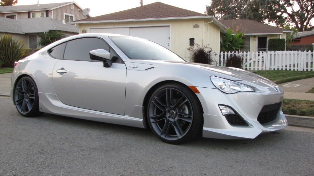

86 FRS 09-28-2012 03:29 AM
Lowering Spirngs with a FiveAxis kits and Wheels
Hey guys,
I ordered the FiveAxis kits and Wheels, it takes a month or so to get it. I wanna drop my car also, but which lowering springs best?
Im kinda debating either Eibach Pro Kit or Tein H tech, both are about inch drop.
thanksssss:thumbup:

alex345 07-16-2014 11:41 PM
Awsome Rims! What size are those and name!
