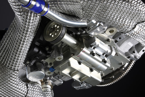

Floggin Tires 09-28-2012 04:15 PM
BRZ GT300
Attachment 16415
http://www.ft86club.com/forums/showthread.php?t=18391
