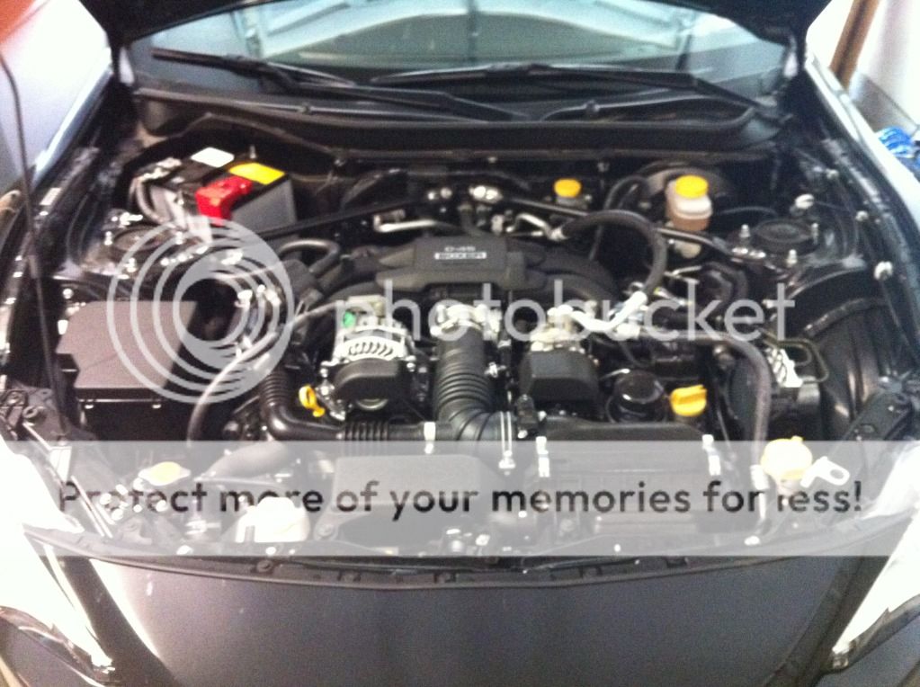

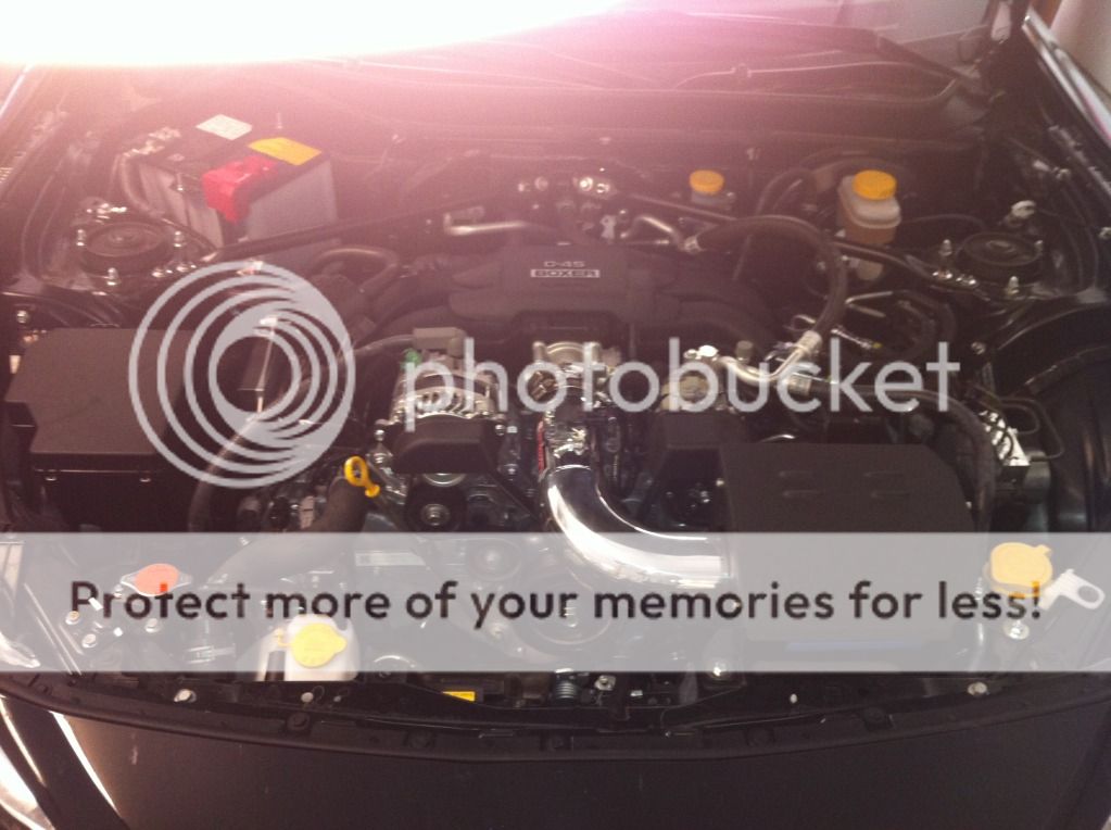

Despite having an impacted wisdom tooth removed yesterday, I went ahead and installed my new Injen intake as soon as it arrived today via UPS.
After installing, I unplugged the battery for 15 minutes. (Resets the ECU supposedly.) Then I started the engine without touching the accelerator, letting it idle unsupervised for 10 minutes.
So, it was ready to go... I hop in, put it in reverse to back out of the garage, and almost stall. Low engine speed throttle response seems to be all but gone. There's a dead spot in the pedal that wasn't there before installing the intake. Thinking that the ECU may adapt sooner or later, I took it for a drive and accelerated 0-60 several times. It does seem to have a little more pep higher in the rpm range, but down low it remained the same: Sluggish and worse than stock.
Sounds nice, but i'm contemplating removing this and opting for a drop in filter instead. That is, unless there is something I can do to make the ECU adapt or something.
Sorry for the lame photos; my Casio Exilim decided to go into its crappy standby mode instead of turning completely off, resulting in a dead battery.
http://i900.photobucket.com/albums/a...ps36e86b2b.jpg
http://i900.photobucket.com/albums/a...ps8eff221c.jpg
Opposed 09-20-2012 02:49 PM
I would still give it a couple drive cycles. After flashing my car with two tunes, I too had a weird dead spot in the throttle. But after a couple days of driving, the response went back to normal.
BuBlake 09-20-2012 03:01 PM
That's good news! I'll keep my fingers crossed. I won't be driving much soon because I currently cannot eat, am on some strong pain killer and the left side of my jaw looks like Quagmire's from Family Guy. lol :bonk:

VSGTS14 09-20-2012 03:30 PM
it takes the computer a few times to adjust for air/fuel. i still wouldn't put any parts on this car without tuning.

BuBlake 09-26-2012 02:18 PM
Ugh. It died on me twice today on the way home from the gym. This is dangerous, as i'm losing braking power when approaching lights and stop signs. I guess i'll have to get the Visconti tune... :D
As for anyone else looking at this particular intake, I recommend looking elsewhere unless you plan on getting a tune. My car had no idling issues until I installed this intake.
Anyone know if the Greddy intake has the same issue with stock tune?
audioenvy 09-26-2012 02:58 PM
If your car is dying, I would double/triple check to make sure there's not something amiss with the install.
That said, Visconti has been testing/tuning several different intakes. Has even one of them shown any measurable gains yet? (Even with his tune?)
