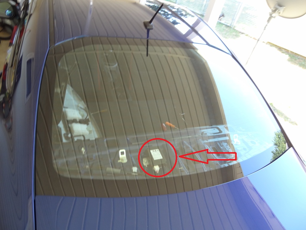

the thing back there is the wireless transmitter for keyless entry and i was informed by my service manager
Attachment 15694
smbrm 09-20-2012 11:21 PM
I have seen documentation that describes it as dual function, keyless entry and TPMS receiver/ecu In addition to page 252 of: http://www.ft86club.com/files/BRZwiringi.pdf
