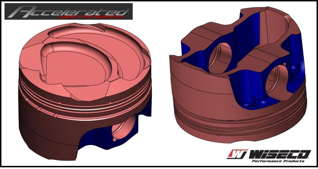

Wiseco - Accelerated Performance Turbo Forged Piston Set
http://www.ft86club.com/forums/showthread.php?t=12956
Originally Posted by Don@Accelerated (Post 342574)
Accelerated Performance is proud to announce another new product for the FA20 Engine.
I supplied Wiseco with the parts required some while ago to make piston sets for the FA20 Engine.
This particular piston drawing will be the turbo variation of an off the shelf Wiseco Piston and something in the 10-10.5:1 Variety.
There will be off the shelf versions and custom AP Spec Versions of the pistons.
The AP versions will use advancements we have learned from our on and off road racing programs.
We are looking to create something very similar in strength to our Toyota 2jz pistons sets.
I would suspect that each piston will be strong enough to supply 300hp per cylinder.
Obviously thats far more than this engine will be able to hold for a long time if ever.
Don
