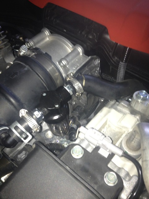

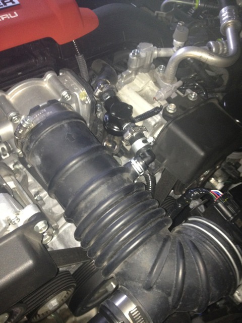

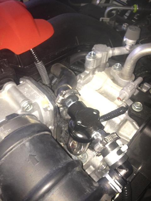

So I was seeing Crawford take apart a fa20 with 5,000 miles and I saw how dirty the combustion chamber and pistons were. So I decided to create a temporary solution to oil being pulled into the engine through the PCV.
I will check it in a few weeks to see if it's collecting oil and keeping it out. I report back progress
Attachment 14766
Attachment 14767
Attachment 14768
::: disclaimer :::
I do not recommend this mod to anyone. Which is why I didn't make this a DIY. This is soley for purposes I still don't understand. Good day and dont do this to your car!

I used one of those on my turbo RX-8. It seemed to work well at catching oil. It just doesn't have a lot of capacity.
gmookher 09-09-2012 09:10 AM
thats undersized for our application, and not the right device; I get that its temporary; but I wouldnt have posted up a picture of that home depot hackery..I used a Moroso solution thats bit more than temporary and may be worth your look

F3dzo 09-09-2012 10:59 AM
Fair enough! I am open to any and all comments.
I don't track or race my car by any means. I just want a VERY cheap and quick albeit solution. If it gets full or starts to melt after a few days of use then it comes out. Not looking for looks on this mod. It looks like a blackhead on a teenagers face, I know.
I'm checking it after every drive. I'll pay attention to the concerns of you guys on hear. Plus I added a little disclaimer in my OP. cheers!

celica73 09-12-2012 07:27 AM
I just spent the weekend at the race track with no catch can, rather than sitting in front of the computer debating the merits of a catch can.
I had more fun than y'all.
The home depot solution is a good one to monitor the problem. When it doesn't fill with oil after 3 weeks I suppose it won't seem so undersized. That separator can probably flow 150 cam at 90 psi, so it won't have a problem with a little flow under engine vacuum.
Oh yeah, my car didn't blow up at the track, and the dipstick didn't show any significant oil loss.
