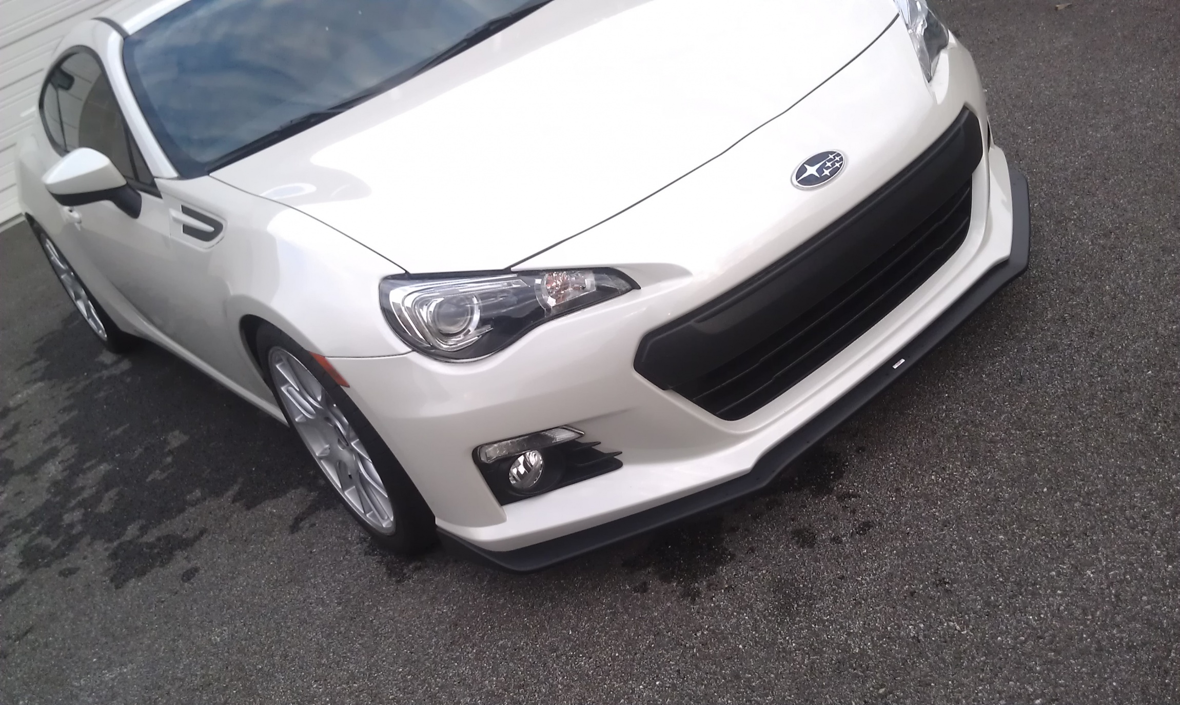

Racecomp Engineering 09-04-2012 09:19 PM
2 Attachment(s)
Attachment 14440
Attachment 14441
Ooops ! kinda big !
STI front lip spoiler.
Myles
ayau 09-04-2012 09:40 PM
nice lip! where did you guys order it from?

Racecomp Engineering 09-04-2012 10:44 PM
we source these from Japan. We have 1 extra in stock at the moment.
