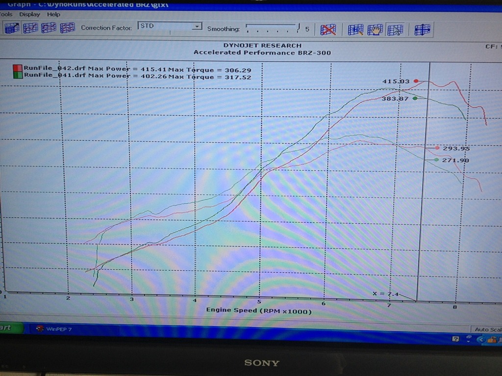

New HP record. Will post graph!
See graph below.
Current configuration Change:
E85
Deatschwerks 900cc Injectors
Deatschwerks 65 Fuel Pump
Garrett 3076
We are testing clutch options with exedy. The configuration now holding is listed below. We have slip starting around 250-260ftlbs. We will need to upgrade the cover as well. For someone only wanting a 93 Octane 300hp setup, this clutch would work great.
Its very cost effective.
Exedy Lightweight Flywheel
Exedy Hyper Single Clutch Disc
Stock Clutch Cover

Visconti 08-26-2012 08:42 PM
Attachment 13728
Needs more clutch!

Looks like a larger turbo? HP looks to be coming much later.
