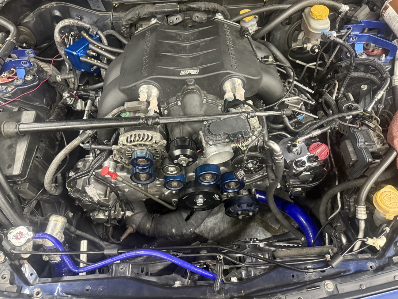

A background of the build: 2013 Scion FR-S manual 98900k miles
IAG closed deck 12.5 to 1 built short block
GSC titanium valves and springs
lifter retainers
killer bee oil pickup
oil pan baffle
5W-30 euro full synth oil
1050 cc injectors
greddy light weight pulleys
verus AOS with cooling integrated
HKS spark plugs
Harrop supercharger with the 70 mm pulley
Perrin crank pully
X clutch chromoly clutch kit
Cusco motor mounts
4 bar map sensor
CSG flex fuel kit
upgraded fuel pump with trap door
Running on E85
ARP head studs
Jackson racing dual rad/oil cooler setup
Mishimoto fan shroud and hoses
FBM thermostat

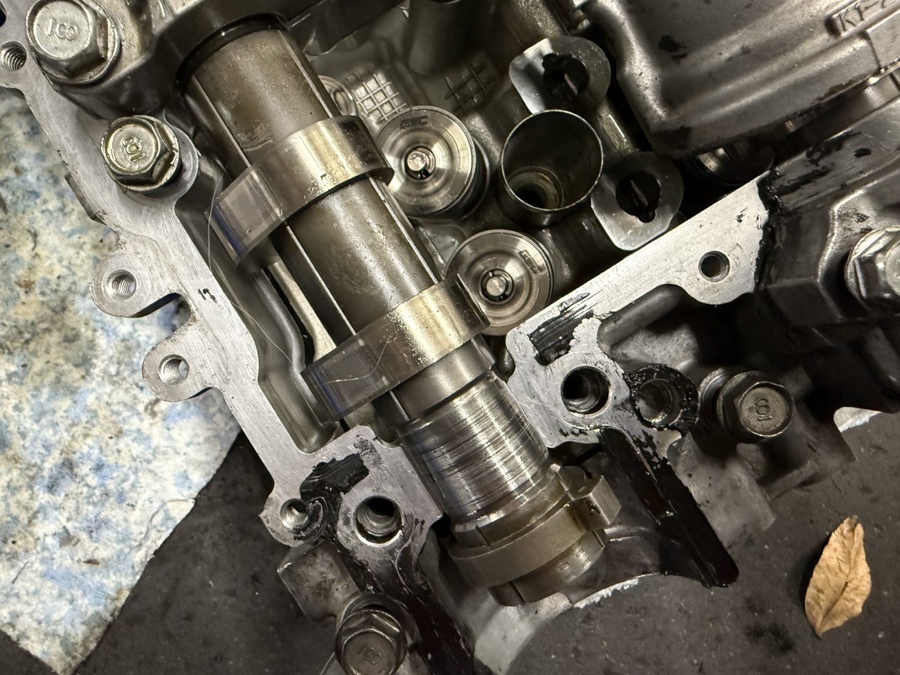

We found that the wiring harness had started to go bad along with the mass airflow sensor, replaced both and proceeded with data logs. We then ran into cooling issues at high loads, fixed them and proceeded with the data logs. I found that after I introduced the supercharger there was a very small leak coming from the cam cradle and was already planning on installing the lifter retainers per the tuners suggestion. When I took the heads off I noticed on the passengers upper cam journal there was scoring, bad enough that I could feel it with my nail. I did some research and found no similar cases and proceeded to reseal the engine. Car drove great with no major issues so we set up a date to do a dyno session.

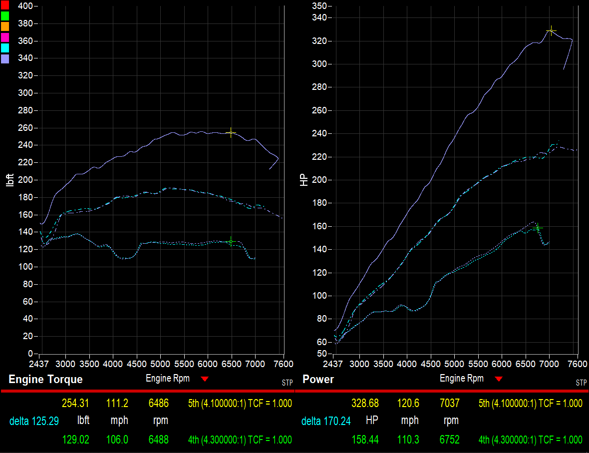

We proceeded with the dyno session with me stating that I would buy the fluid damper crank pulley and install it ASAP. First few pulls were looking good, but on top end we were getting random dips. The tuners deduction was that the engine was vibrating so much that the timing was being pulled back at high rpm.
Now on pull 6, we were getting a great power graph but the moment we hit 7600 rpm there was a 1 second metal on metal boom. The tuner immediately shut the car off and we looked at the data. We found that when we hit redline the car misfired 80 times in cylinder 4, the tuner stated that he had never heard a sound like that and the engine builder stated that it sounded like a piston kissed a valve. That noise ended the dyno session, not only to prevent further damage, but because I was 175 miles from home.

Update: Found aluminum in the oil pan and continued to disassemble the long block. What I found was that a valve did indeed float, no damage to the piston, no bent valve.
What was found was that all but the drivers side intake cam journal had substantial scoring due to what I believe to be loss of oil pressure(sprockets failing). I ended up buying new heads, cams , sprockets, valves, springs, bearings and cradles.

Ill add pics of the damage asap.
