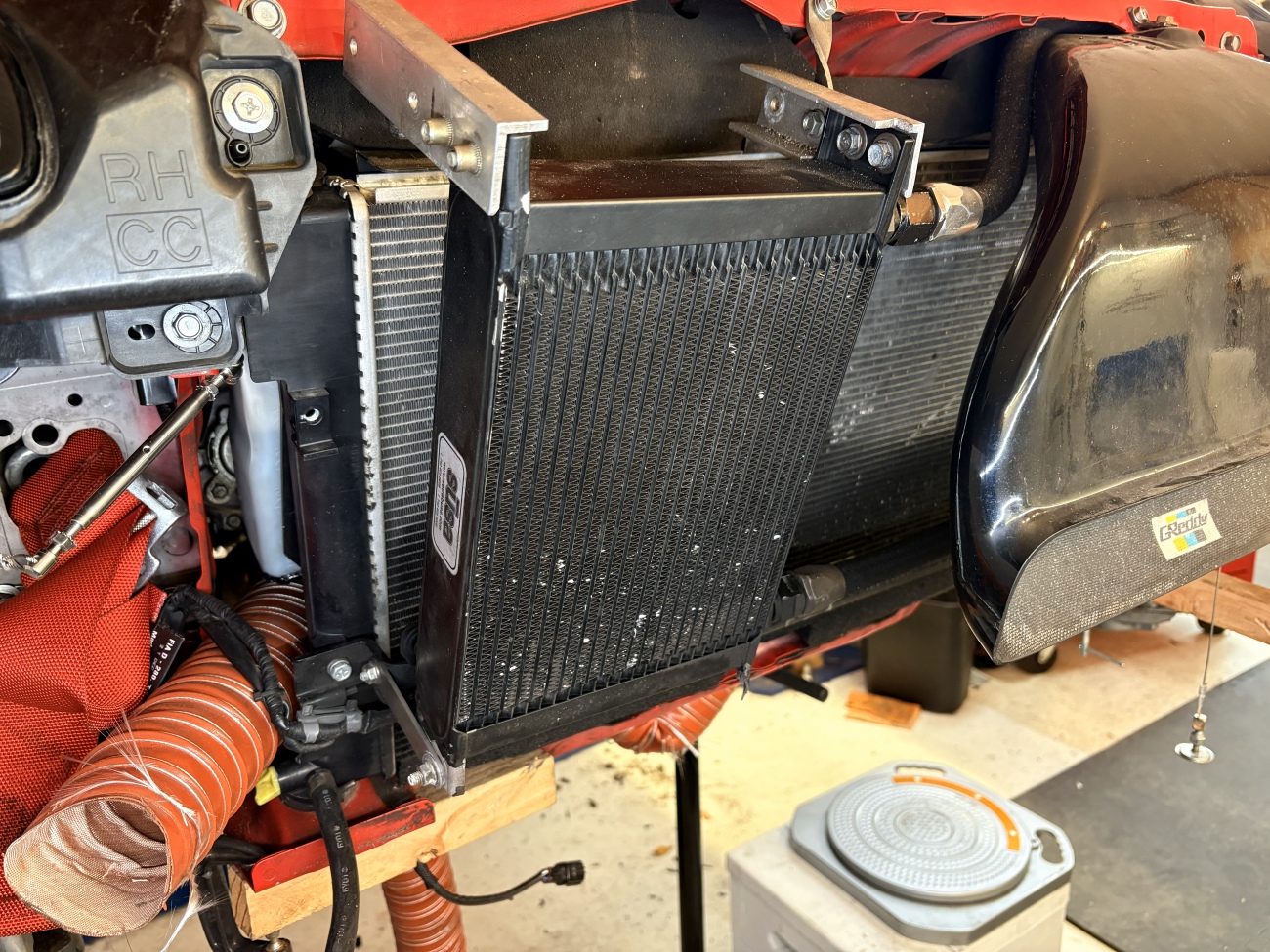

About cooling: I have an oil cooler in the front. It's on the right, lower side of the radiator area. I have a snorkel for the CAI that comes halfway down on the left side.
Attachment 228310
There's no purpose to fans when racing and moving. There's the rub: when moving. Sometimes I've had to sit in the pit line for five minutes or longer. It's not good to get caught not running and hold people up when it's time to go.
I've removed the right fan and I've cut away almost all of the fan shroud that restricts airflow. If need be, the one fan will come on.
I plan on posting pictures as I get it all back together.

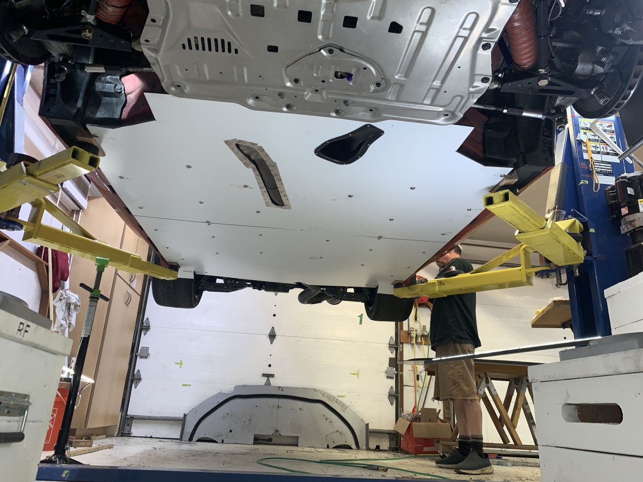

The belly pan and new splitter are done. Old splitter in background.

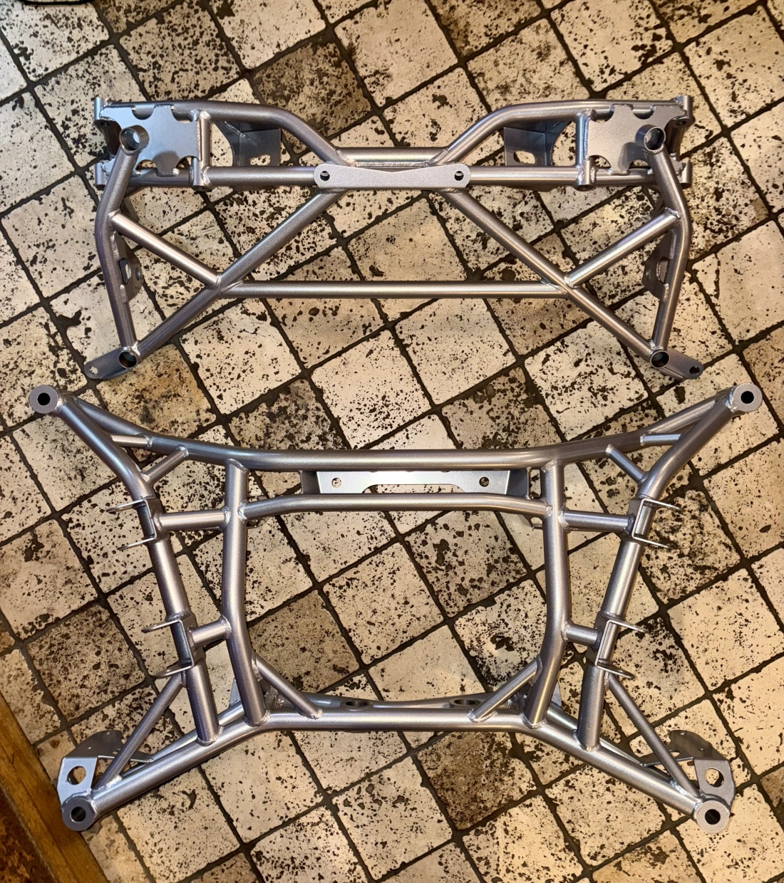

TSS Fab subframes got powder coated and are going in.

Pictures of TSS Fab rear subframe installed
4 Attachment(s)
My bad. I don't know what the weight savings are, other than to say that they felt dramatically lighter.

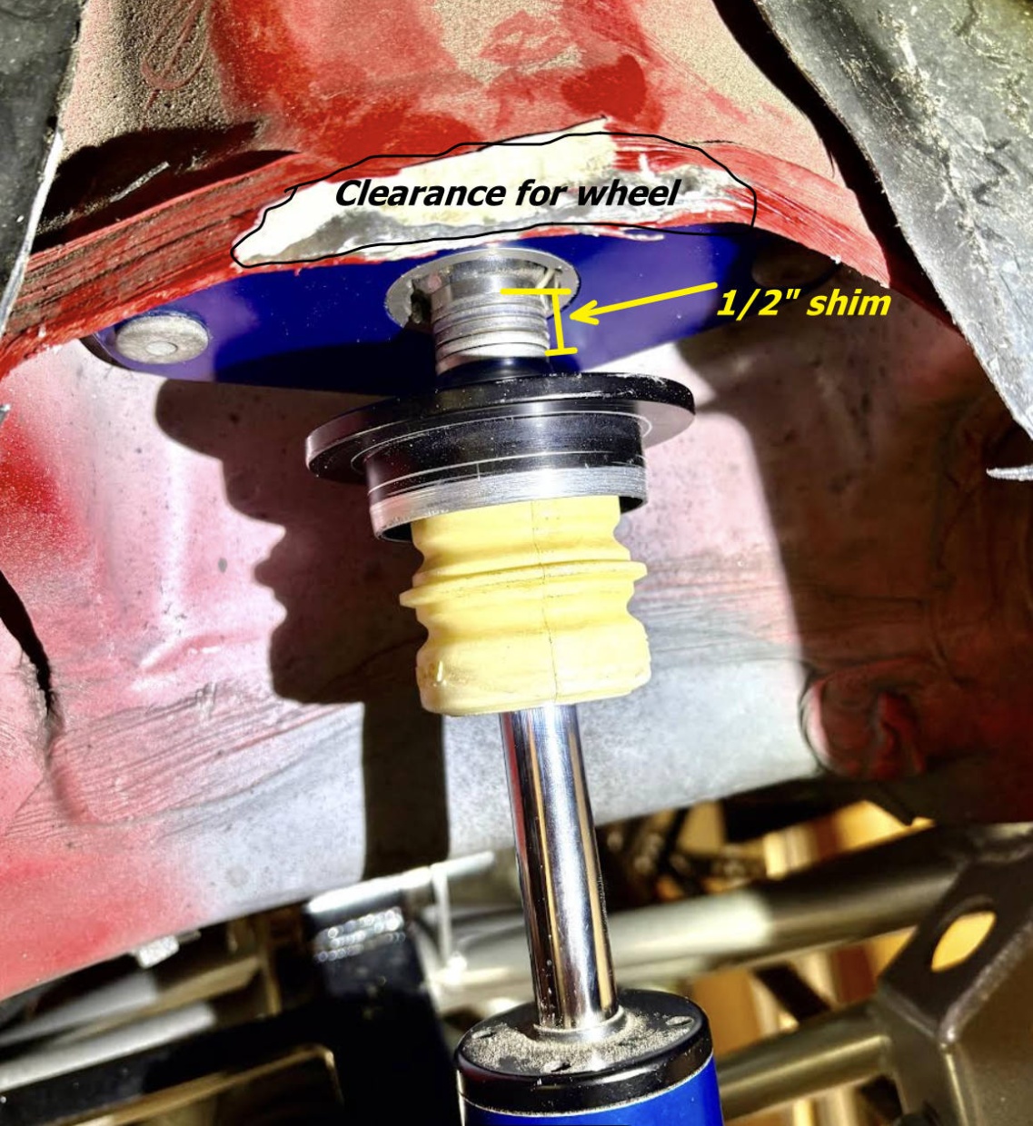

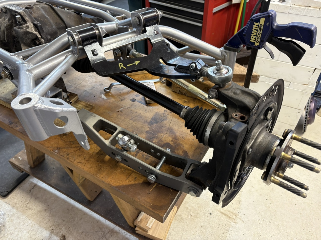

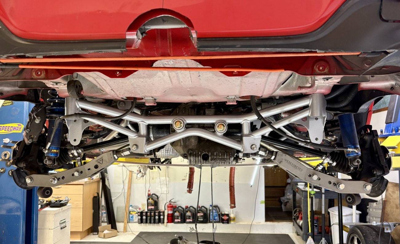

Here's some pics of the rear. I ran into an issue with the Pro Car Innovations CA-GR86-RU, rear upper control arms hitting the unibody frame as I fully compress the suspension. I have the same issue with stock or Cusco's arms.
I think I'm the first to use the TSSF subframes.
Also, the JRZ coilovers came from CSG, which are supposed to be specifically for my BRZ are not very appropriate for a fully lowered BRZ road racing car. In the front especially, and in the rear, I've had to make shims and spacers to move the shaft down and get the 60/40 (or more) compression travel I need. Lowering the car eats up compression travel!
For the rear upper control arms I had to notch a spot in the unibody frame where the RUCA was hitting. I cut a slit in the sheet metal and used an air hammer to move the metal out of the way. I'll weld the area back together when the time comes. Now I have virtually full travel with about a 70% compression of the bump-stop before I have any interference.
Attachment 228281
Attachment 228282
Attachment 228283
Attachment 228284

I also put a 6mm Maxmetal full belly pan on and am working on an aluminum diffuser.

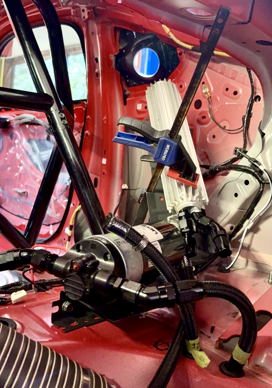

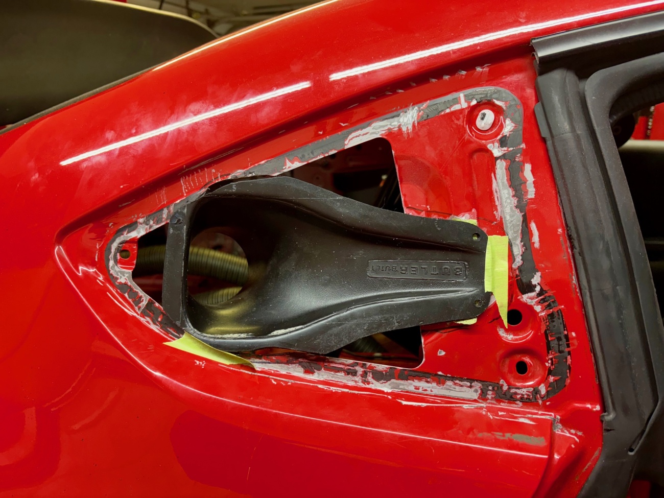

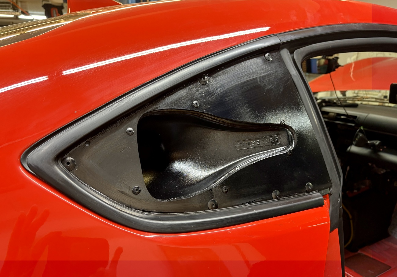

Today I finished the mod to the quarter window where I installed a NACA duct with a three inch exit. This will provide air to a cooler for the diff.
This was not an easy task as this NACA duct is pretty large for the available area and glass size.
Since I installed a full belly pan I believe I must deal with the heat the diff develops and that the airflow to it has been hampered by the pan. The oil cooler is part of the solution.
More pics to follow as I install the pump and cooler.

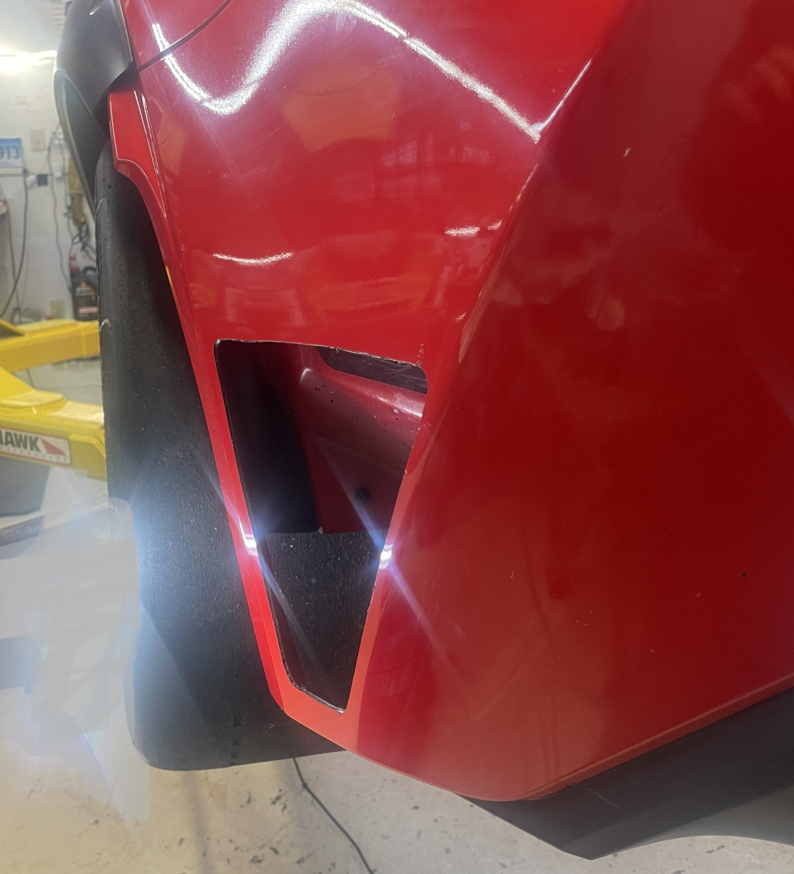

More freeing up of trapped air. This will complement the diffuser airflow.
Attachment 228456
