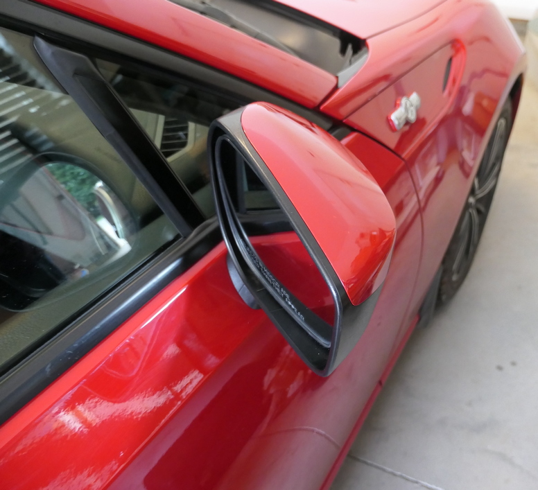

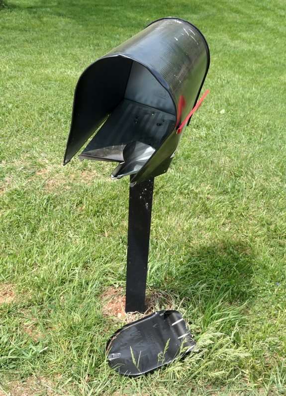

There is a narrow 2 lane country road with no shoulder from my house to the 4-lane. Some ahole in a pickup truck coming at me started to drift way over into my lane. On his cell phone?? Deaf, did not hear my horn? It was either hit him head on or take out a mail box. My passenger side mirror took out the mail box, destroyed the mirror, and shattered the triangular piece of glass. It could have been worse, the whole mirror could have been ripped off and damaged the door. Being the nice guy that I am, I told the mail box owner what had happened and offered to pay for it. He told me that this was the second time someone had hit it this year. The first time was a hit and run.

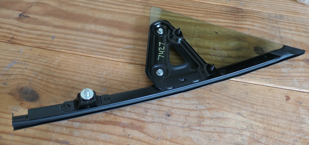

It cost me $40. for the mail box, $50 for a salvage yard mirror from eBay with a red shell, and $55. for a salvage yard triangle window from eBay. Both were in excellent condition.

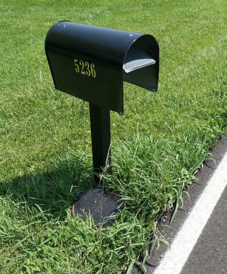

The mail box.
Attachment 227108

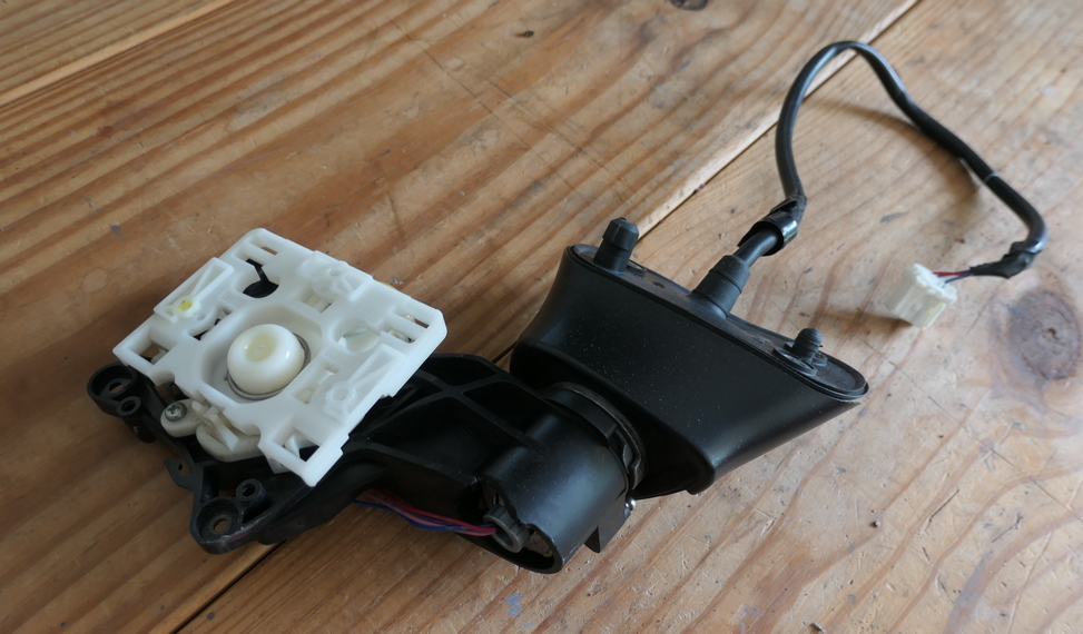

What was left of the original mirror
Attachment 227109
Salvage yard side window, came with frame attached
Attachment 227110

His new mail box, IMO, too close to the road
Attachment 227115
I had to dig deep into the repair manual to find the nut torques.
Front door window:
Bottom 12mm nut : 10 lb-ft = 120 lb-in
Top two 10mm nuts : 66 lb-in
Mirror
Three 10mm nuts: 66 lb-in. There's a rubber gasket on the mirror so do not over tighten these nuts.

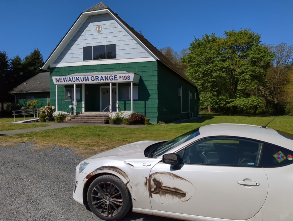

Thing is, on the way down there, coming into Bremerton,
A huge box truck was slowly passing me on my left and it seems that he forgot that I was there and swerved into my lane
making for annoying marks on my precious gem of a first gen.
Then he just continued on like nothing had happened.
There's a State Patrol office there that I reported the hit & run at,
but what kind of insurance adjustments will be coming my way is still hazy.
Attachment 227117

Hard to tell from the pic. Are those just scuff/paint marks or is the door and fender dented? If dented that's going to be an expensive fix.
