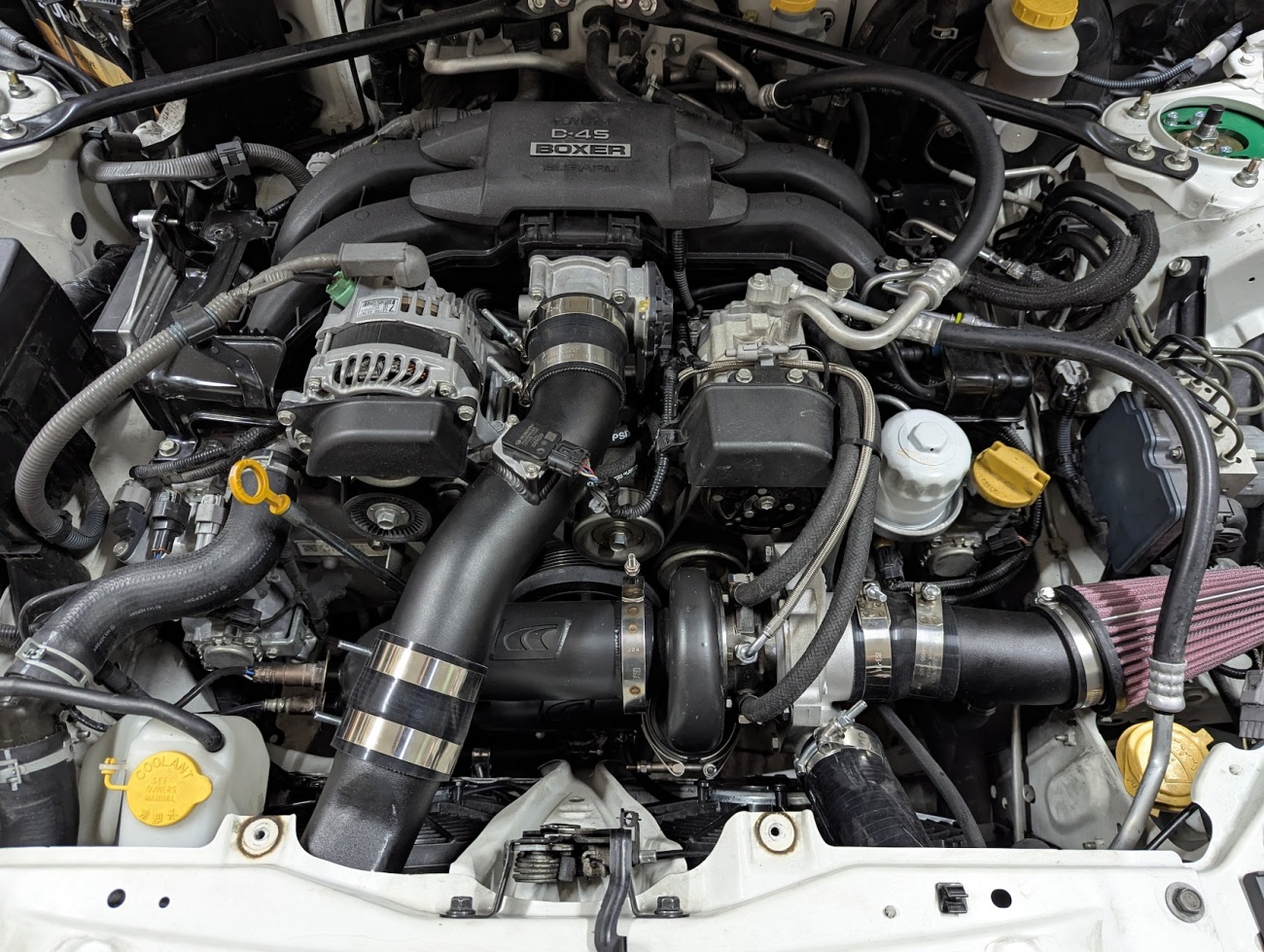

Hello all! I bought my BRZ brand new in Jan 2015 and she remained stock for most of those years but I've slowly been modifying her with the intent of adding boost and it's finally time!
https://i.imgur.com/gFHwYKs.jpg
I went with the JDL UEL recirculated turbo kit featuring the GT2860RS and CSG for Ecutek tuning.
I'm waiting on some new parts from JDL that should be here in about a week and figured I'd eat up some of my wait time with writing about my baby.
My goal is a fun, comfortable, fast car that works for myself and my wife. A sport-luxury coupe if you will. I'm aiming for 250-300WHP on 91 octane.

moonspoon 02-22-2025 10:57 PM
Install complete and I've fallen (more) in love with this car! It's so much fun to drive! It sounds amazing, it feels amazing, it _is_ amazing!
Attachment 226765
Overall the kit was fairly straightforward to install, a few hiccups along the way but it only took me two afternoons to get all the hard parts in.
Currently going through the remote tuning process with CSG.
I ordered a factory turbo'd PCV valve (11810AA141) that'll be popped in when it gets here too.
