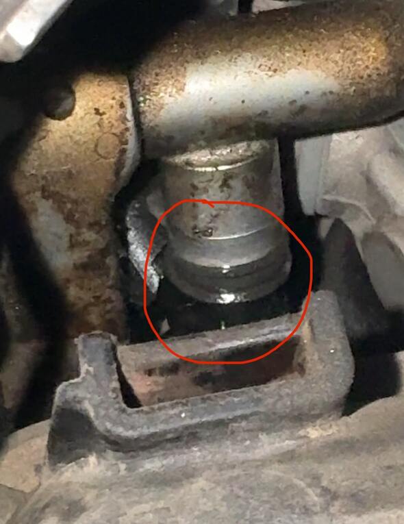

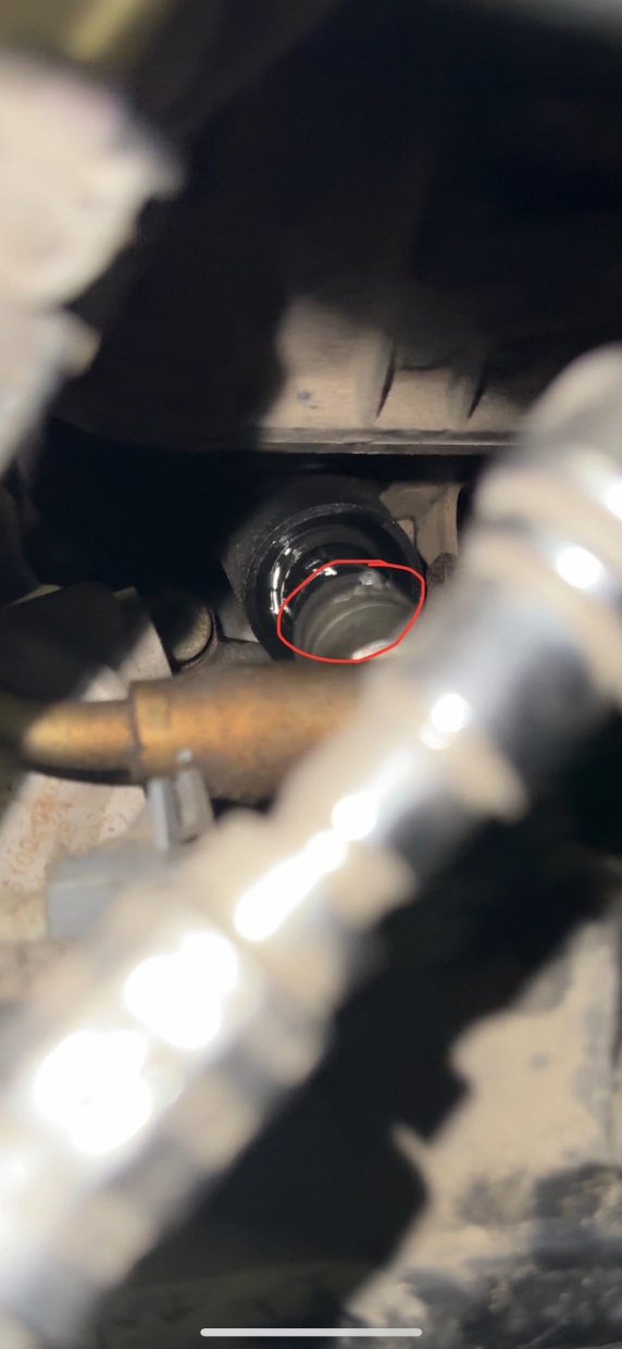

Long story short, I discovered that my drivers side injector is leaking at the seal's between the fuel rail and the injector itself. I was wondering if it's as simple as replacing the seals, or if it is better to just replace the whole injector.
Attachment 226505 Attachment 226507
whataboutbob 12-30-2024 10:25 AM
I'd start by replacing the seal(s) at the top of the injector where it mates to the fuel rail. It's really simple to pull that fuel rail and get to the seal(s).
