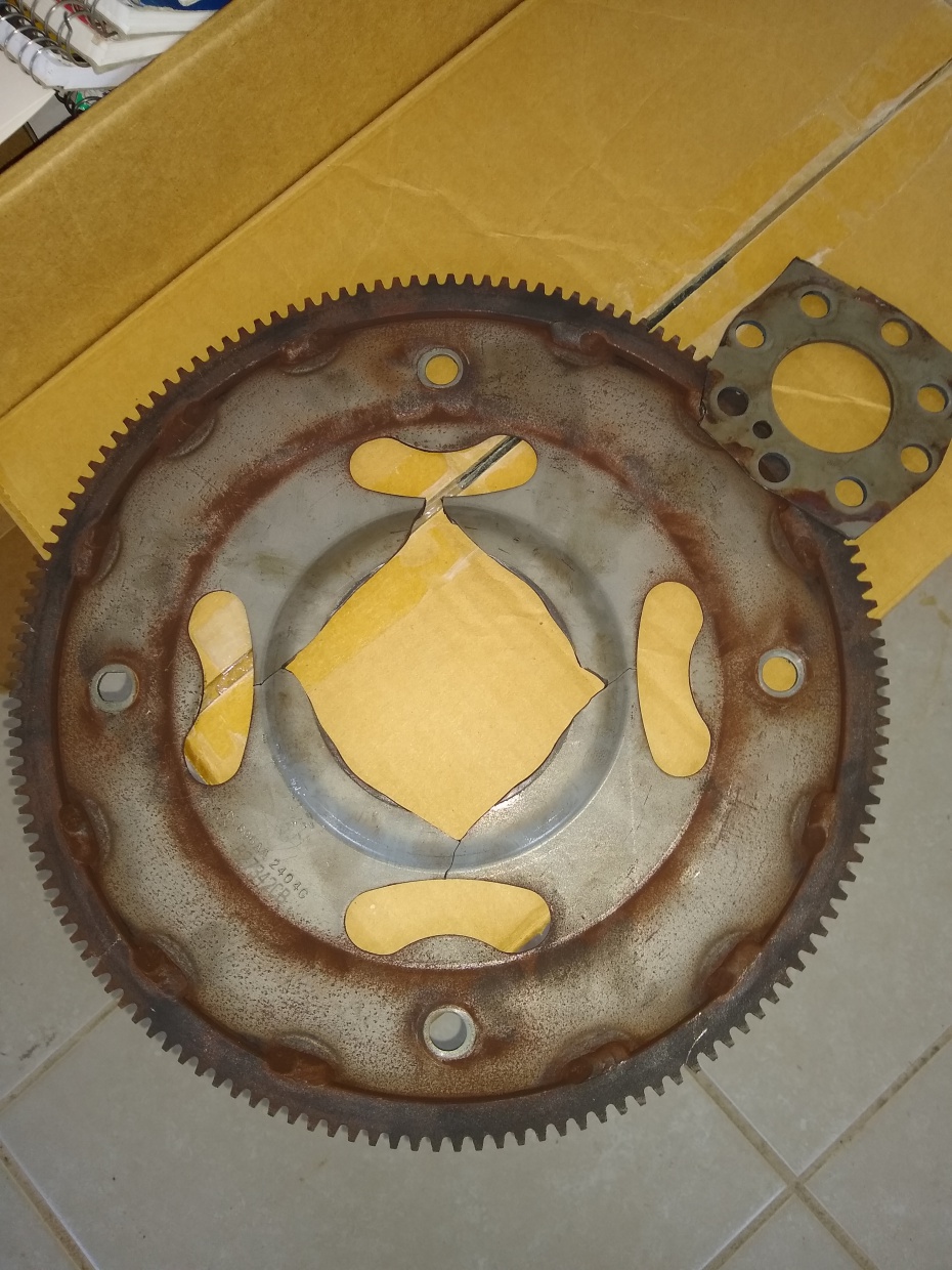

Or it could be something worse:
Attachment 224986
This came out of a Dodge Caravan with less than 100K miles on it. It made the same noises as you are describing...AND...still started and ran! Only difference is this had an automatic transmission.
Stranger things have been found.
