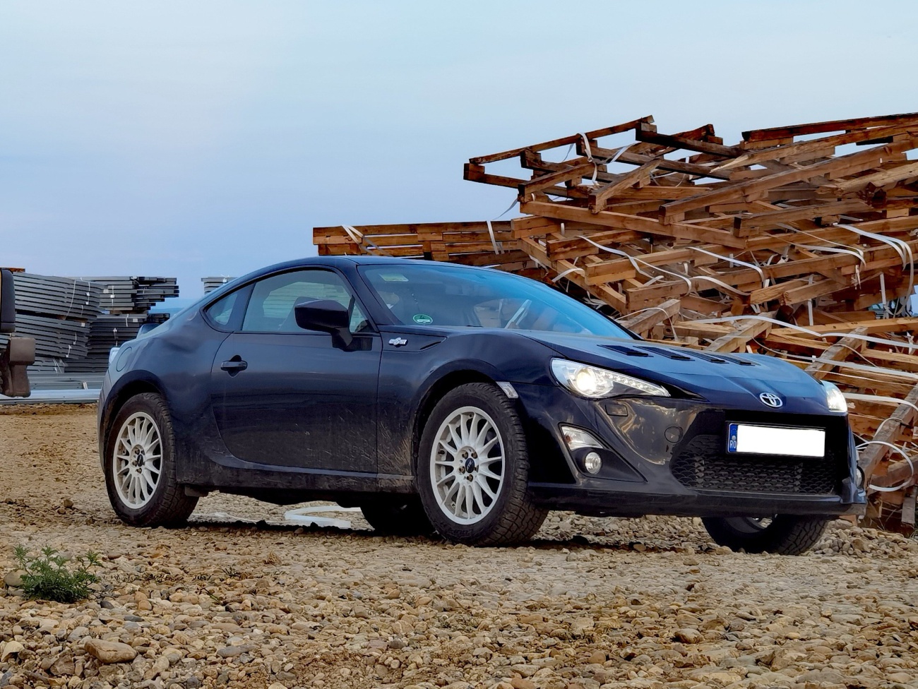

The car: '13 GT86, forged bottom end, boosted from a gtx2867 on a 1 bar (14.5psi) minimum setting. Current suspension setup, which I put together for daily street use and dirt road fun: Bilstein B6 shocks, Chuhatsu Multiroad lift springs, SPC front camber bolts, Pedders -camber/+caster top mounts. This year I'd like to do a few track days and local time attack competitions, and a few changes/upgrades are needed.

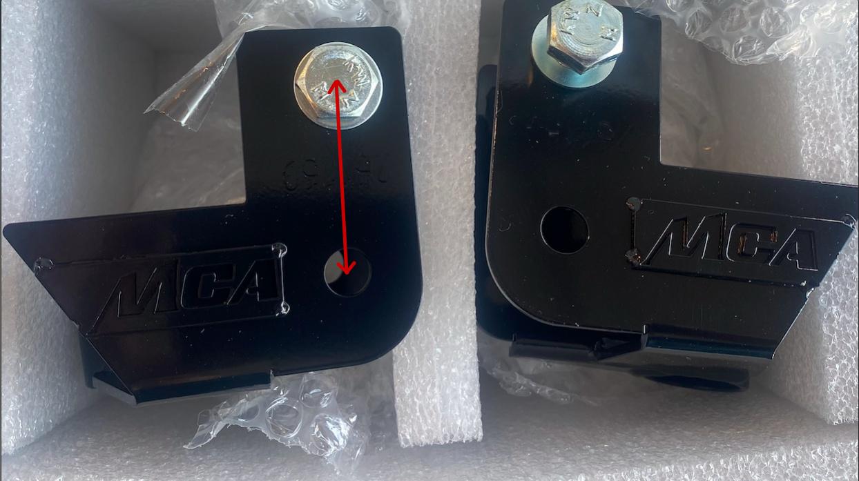

I would also like to experiment playing with anti-squat/traction mod bracket, but in the EU, everything doubles it's cost by the time it gets taxed and shipped so it's not within my budget. Hhere's a long shot though: Anyone that has them installed would care to measure and share by how much is the TCA pick-up point lowered? I can fab them up for a fraction of the cost... :)
Not sure if MCA published their offset, but the GPSports version of this lists a 60mm drop in the pickup point. You can also check the thread here for discussion about the MCA and others' traction mods.

Well, my guesstimate based on a crude photo edit is that the MCA's drop it by about 45mm.
Attachment 224390
IIRC, the bolt is 10mm so bolt hole most probably would be 11mm, 4x11=44 :iono:
From the photos, GP Sports bracket seem to have a higher drop, also it looks like the pick-up location is pushed towards the front of the car, most probably so that the wheel doesn't gets pushed towards the rear...
If I won't get more clear information I'll probably fab the brackets with a 50mm drop and see how it feels.

Ohio Enthusiast 03-24-2024 11:38 AM
Yep, looking at the pictures in the MCA site I tend to agree that it's quite a bit less than the GP Sport's 60mm. Your ~45mm feels about right.
Edit: actually, I measured my GP Sport mod (waiting to be installed) hole and it's ~12.5mm, so I assume the bolt is an M12. This would make the MCA drop closer to 50mm.

:D Just read this on the thread you suggested:
Originally Posted by Gforce (Post 2909903)
MCA traction brackets drop the front suspension pick up point for the trailing arms by 53mm. This leads to a 25mm drop from that point to the trailing arm pivot point at the LCA.
So anti squat angle is reduced by that difference, 2/3.
I suspect that some of the benefit of this mod lies in the reduction of toe change as well as reduction of anti squat effects.
