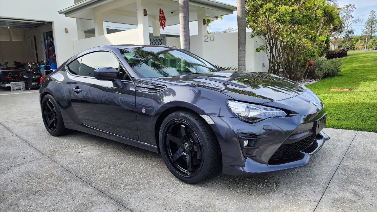

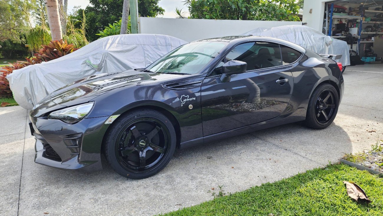

Oh no, it's another LS swap!
Anyway here's my swap. You may have seen me asking questions in the forum over the last few years to guide me in the right direction. It's now finished, registered, insured and already rolling on the roads in my area.
Started on the swap about three years ago with just 3,000 km on the clock. Owned the 2017 car since new. I've done about 300 more Kms since then. So it's still fresh and like new.
Everything works and it totally rips. AGT Engineering canbus translator is the key. I did have a few bumps with it (and the harness that AGT supplied) but I got there in the end, including with upgrading the firmware to the latest.
Thanks to Ash at 29 Automotive for doing the mod plate so I could get it on the road.
Thanks to Kye at Knight Family Motorsport for doing the Dyno tune.
Also a special thanks to Febest (Pacific Auto Zone) in Victoria. They were particularly helpful with information on axles and CV joints when I was going through the process of making my custom axles out of Commodore and Landcruiser parts. Not only were they helpful in sharing information and measurements when needed, the parts I needed were in stock and I always received them in record times and at great prices. Very rare for any business today.
FYI I am on the Sunshine Coast in Queensland, Australia.
OK here's a rough list of everything I've done below. All parts were new. I did all the work myself. If you have any questions about anything specific and want more pics or info, please ask.
Crate 6.2 Litre LS3 with mildly upgraded cam, pushrods and springs.
Sikky Aluminium oil pan with remote mount oil filter.
Sikky Aluminium offset steering rack bushings.
TR-6060 Transmission in MER ratios.
MGW Short throw shifter assembly.
Custom clutch master cylinder assembly with remote reservoir.
GM ZF 8.6 Diff in 3.45 ratio.
Custom 3" inch chromoly steel slip yoke drive shaft with 1350 uni joints and solid aluminium couplers.
Custom CV axles made from Commodore inner CV's, Hardened 80 Series Landcruiser Birfield shafts and 100 Series Landcruiser outer CV's milled and hardened to match the Subaru hub splines.
Chrysler 300C SRT8 360x32 front vented brake rotors and 350x28 vented rear brake rotors.
C7 Corvette Grandsport Brembo 6 pot front and 4 pot rear brake calipers.
Wilwood disc caliper handbrake kit.
Ozzy Tyres Hussla GT 18x9.5 wheels +50 offset with 265/35/18 Semi slick tyres.
Shockworks coilovers with 8Kg spring rate.
Whiteline sway bars, bushing kits, camber kits.
Custom Ford Mustang 3 row high capacity radiator with custom overflow tank, dual 14 inch fans on custom shroud and dual PWM controllers.
AGT Engineering Canbus translator and LS3 swap wiring harness with GM e38 ECU.
AGT Engineering engine swap mount kit for engine and transmission mounts to factory mounting points (no firewall modifications).
Custom over-the-radiator intake and K&N air filter.
Custom 1 & 7/8 inch equal length shorty headers, 400 cell cats, full 3 inch stainless system throughout, X Pipe, dual 26 inch Classic Chambered Powerstick centre mufflers, ebay clones of Borla S type mufflers and Helmholtz resonators.
Custom fabricated aluminium 78 litre fuel tank with Camaro ZL1 65 psi fuel pump hanger and PWM fuel pump controller. Rollover safety, vents, EVAP purge and all such fuel safety systems remain in place.
Bosch alternator.
4HP High torque gear reduction starter.
Denso AC Compressor with custom AC plumbing.
OK I think that's it. I've surely missed something but am happy to elaborate with more info and pics if asked.
Pro tip: Rename the PDF file extension to MP4.....
Enjoy!
Matt
