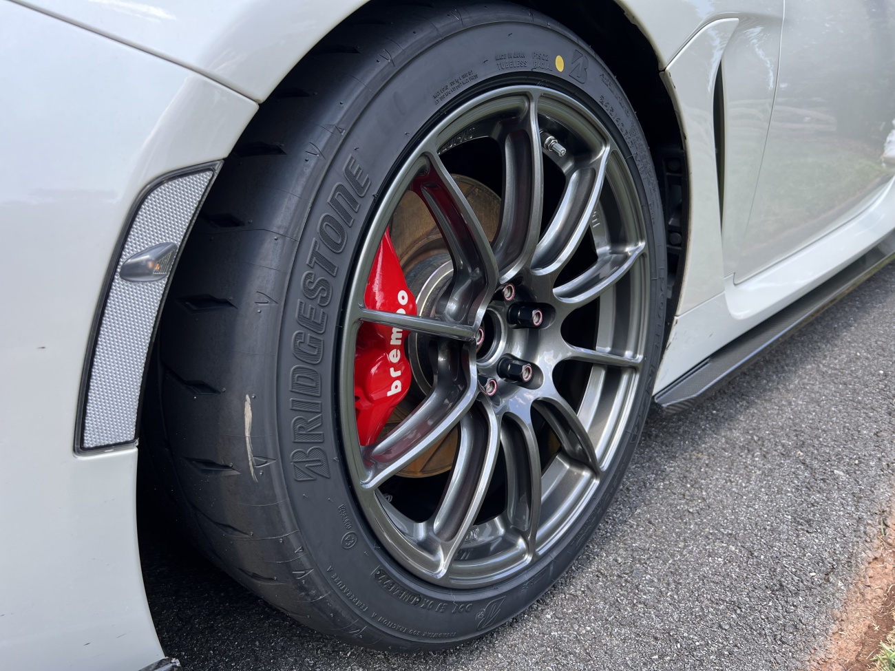

Wangspeed 01-14-2024 10:59 PM
3 Attachment(s)
Both the 6UL 17x9 +48 and the Apex 17x9 SM10RS +48 fit with the Brembo BM-4 calipers. The 6UL fits without a spacer. I never tried the Apex w/o a spacer.
Attachment 223654
Attachment 223655
Attachment 223656
