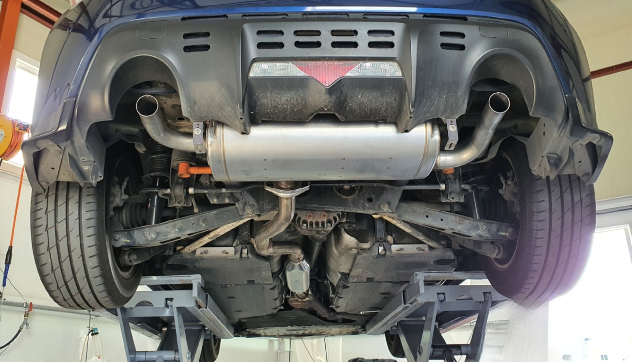

hi everyone
I read the post below, that the aftermarket catback exhaust for GT86 can be installed on a GR86.
https://www.reddit.com/r/GR86/commen...86_fit_on_the/
I assume it also means, the stock catback exhaust from GR86 can also install on a GT86 as well?
I understand the stock exhaust is not the ideal target if people are going after the sound, but I believe it would provide a back-to-quiet sound approach, and also no drone.
The review I read from a lot of aftermarket exhaust, more or less, it is likely to have drone issue and difficult to get rid of it. So the stock exhaust has the advantage on this. :w00t:
Any feedback will be appericated.

makinen 04-05-2023 12:49 AM
It fits perfectly catback-wise. Quieter than GT86 stock catback.
Attachment 219736
