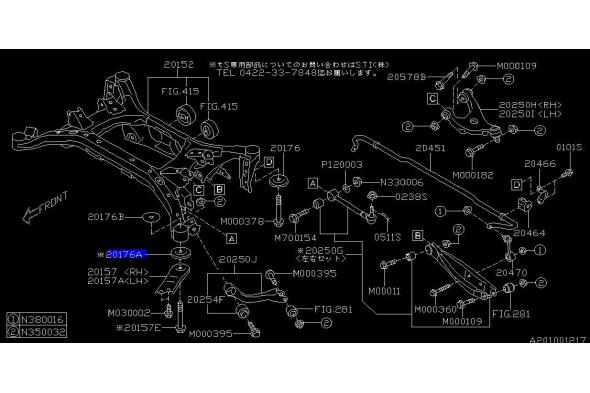

I've seen those sti bolts somewhere. Why would anyone need longer subframe bolts? Just to add braces?
norcalpb 12-06-2022 01:35 PM
They are meant to be used with the STi front lower subframe stoppers. But obviously there have been tons of people who have done other subframe inserts without extended bolts so I doubt it's a super necessary thing.
All I know is an STi engineer looked at the Subaru engineered bolt and said "not good enough" and that was enough to take my money lol.
https://www.japanparts.com/image/ima...&sx=590&sy=393
Highlighted blue part is the stopper, and you can see the bolts are different front to rear. This is a JDM 2015 TS diagram I believe.
