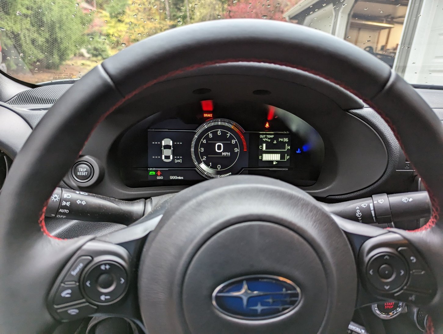

I've just replaced the front seats with race seats. The connections are actually pretty simplistic, and there are only seat belt (carried over) AND airbag plugs for driver, and there's also an occupant sensor for the passenger.
  • Airbag circuit resistance: I did use what worked for last gen BRZ, 3.3 ohm resistor, and it DID NOT work. Later, I measured the resistance from the airbag circuit using a volt-meter, and it was 0.3 ohm.
    • Has anyone also observed this? I've ordered resistors at that rating, but I am yet to try it.
    • I dropped the resistance to 0.6 ohm by parallel-connecting all 3.3 ohm resistors I had in hand, but it was still not enough to prevent the light from coming on.

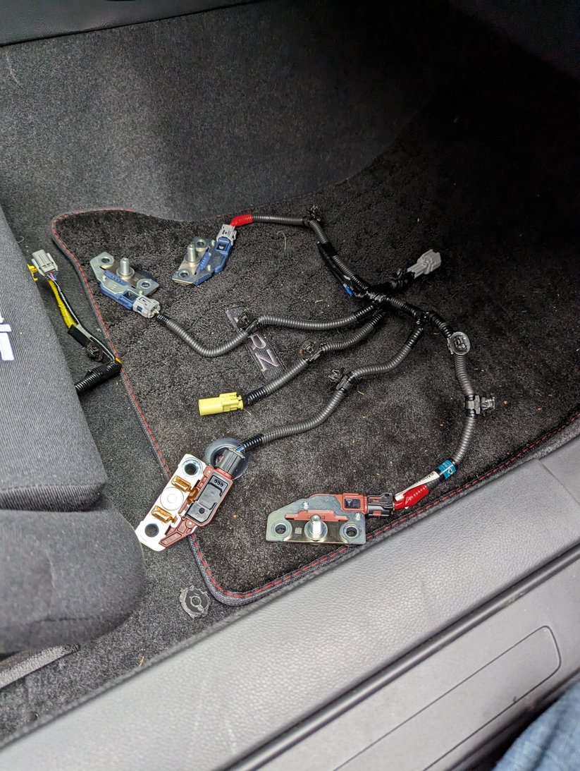

X25 11-06-2022 10:51 PM
Anyway, I ran out of patience, and looted my OEM passenger seat for the parts. In short, NO WARNING LIGHTS!

With everything connected, there're no longer any lights!!!

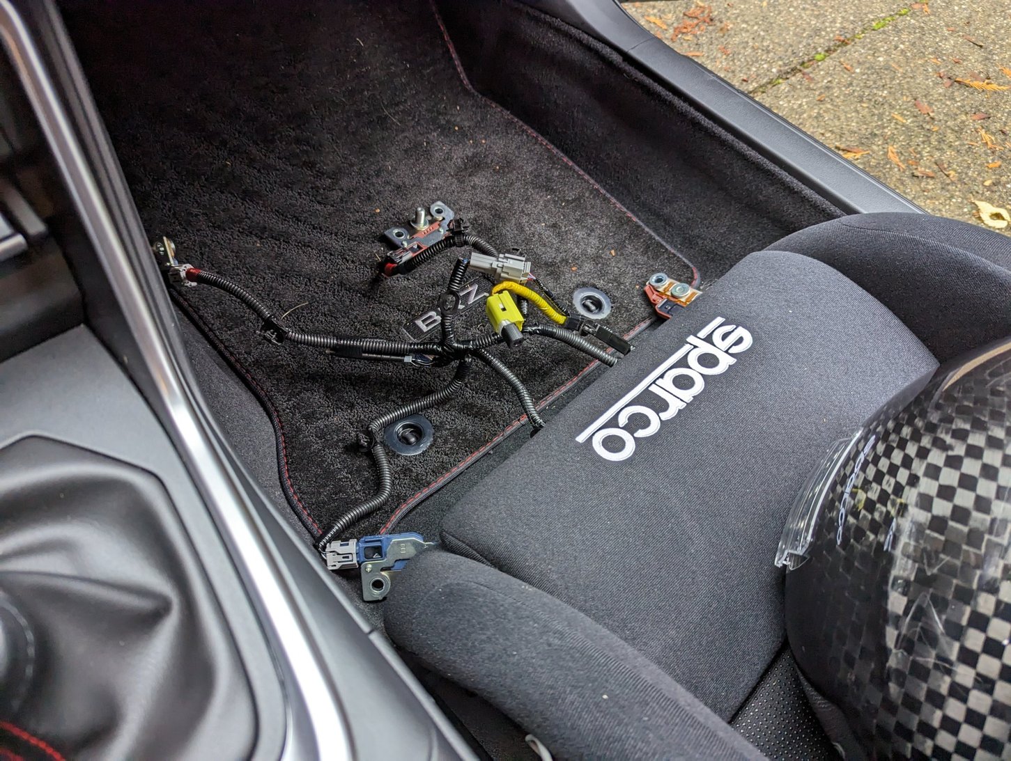

https://thumbnails-photos.amazon.com...Fh-iYJiH0THNlx

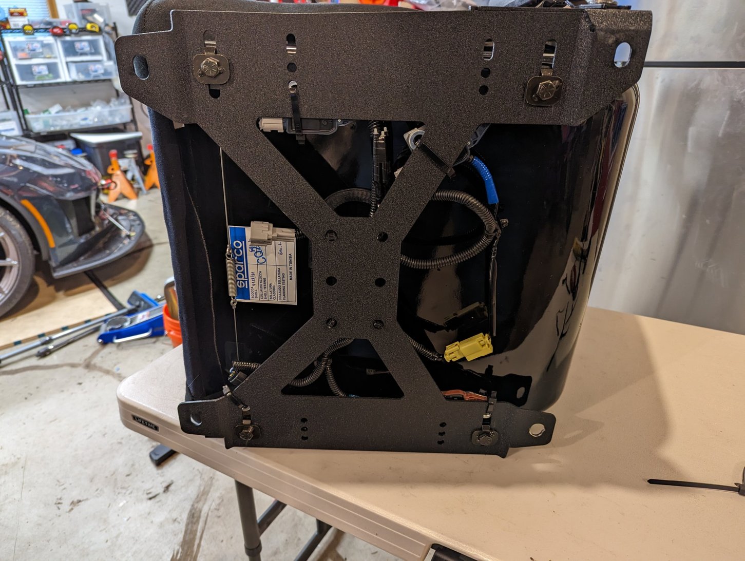

I fixed all the sensors by the race seat's base mount to make sure the sensors are not hurt by harness, etc. They are not very well protected as they are.

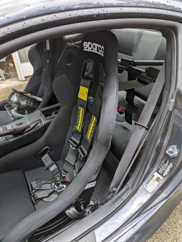

All done!!

I was wondering if fastening the sensors to the bottom of the seat body as shown in that picture was sufficient for them to sense the pressure of someone sitting in the seat and produce the airbag on light. If so, that would be an easy setup that would make me confident the airbags will work in an accident with a passenger.

grippgoat 04-01-2023 04:43 AM
Not with them just zip-tied to the bottom of the seat. However, the way they mount between the seat and sliders, it wouldn't be difficult for a company that makes seat brackets to make one that can accommodate the sensors, and aftermarket seats might be close enough in weight to get away with it.
There are two smaller bolts that attach each sensor to the sliders, and then one larger bolt that connects the sensor to the seat.
