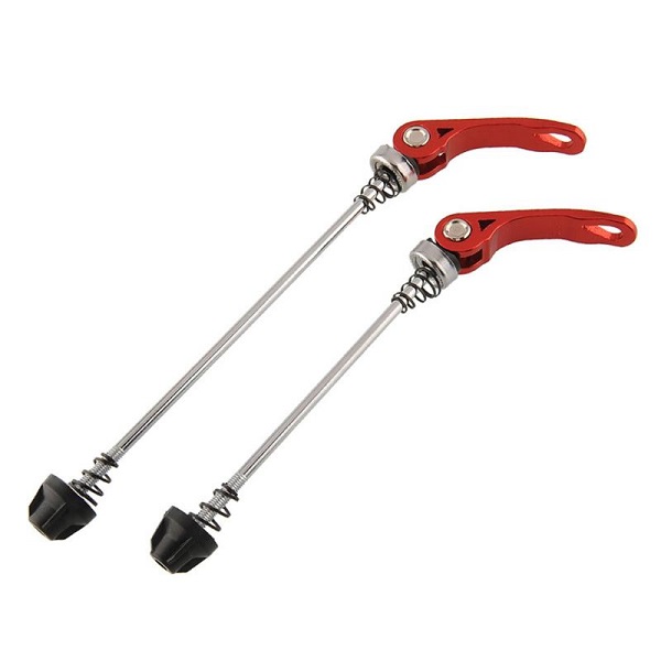

bcj 08-16-2022 12:32 PM
Bike wheel skewer would give at least a little clamping force.
Attachment 214498
