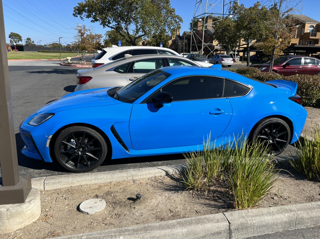

I picked up my ‘23 GR86 PMT in Neptune a few days ago on August 4th. This car will serve dual duty as a commuter and track car, although will likely be more track focused as I WFH frequently and have a very short commute.
Current Mod List:
Annex FastRoad Pro Coilovers, 7k/8k Swift springs
Cusco rear upper control arms
SPC rear lower control arms
17x9.5 ET40 Apex VS5-RS, 255/40/17 Kuhmo V730
CSG Spec pads, Castrol SRF fluid
Nameless Performance axleback exhaust (w/ optional 5” mufflers)
20% tint all around
As it sits now:
Attachment 219829

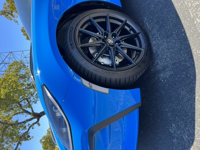

2 Attachment(s)
20% ceramic tint done today, and got my Apex wheels in yesterday. After I finish break in and do 1k oil change, I will throw on pads (Endless MX72 Plus) and probably the coilovers, but we’ll see. Going to do a few track days on stock tires before throwing on the Apexs, which I’ll probably wrap in RS4s or V730s.

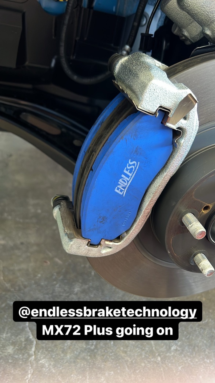

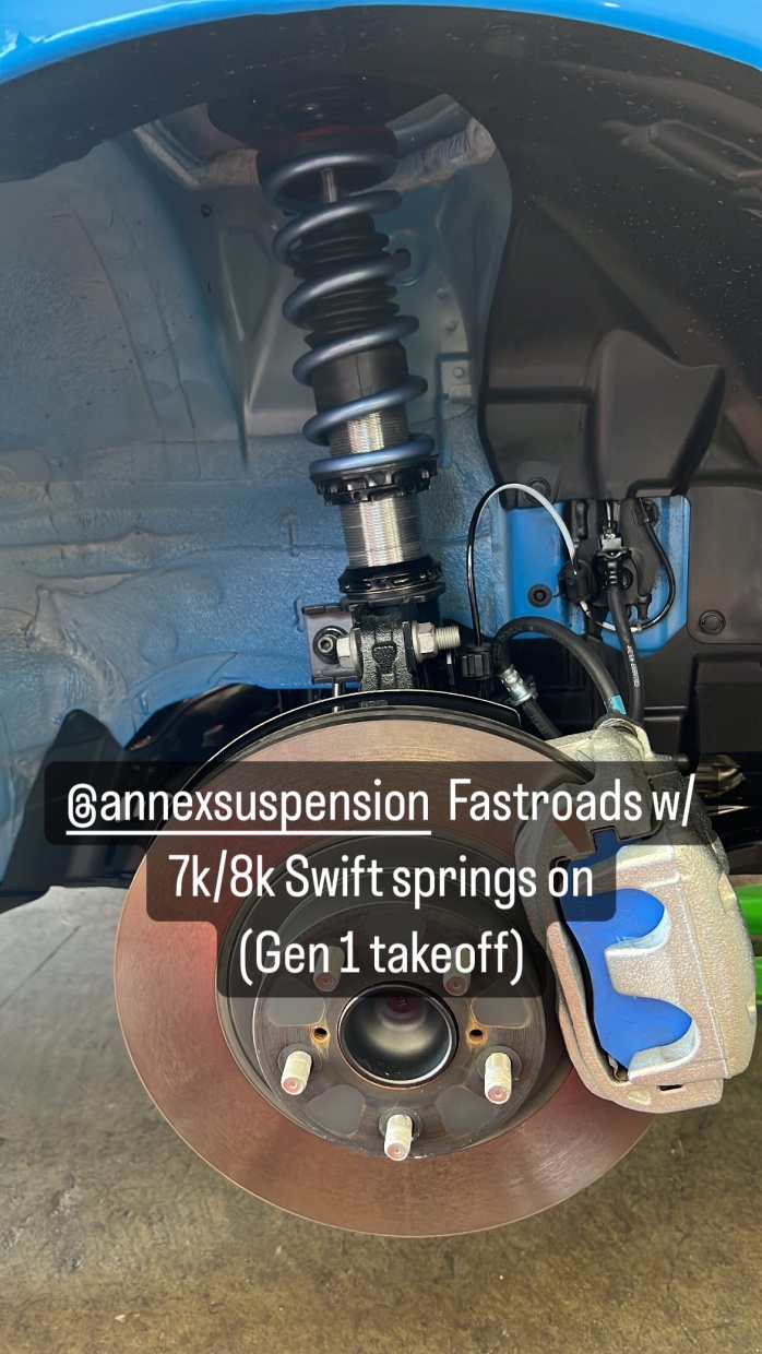

This weekend installed the below:
Annex Fastroad coilovers (Gen 1, 7k/8k Swift springs)
Endless MX72 Plus pads
Attachment 214631
Attachment 214632
Attachment 214633
Took me about 4hrs or so. I think if I were to do it again I could probably do it in 2-3, was a bit of a learning curve as this was my first time doing coilovers (although I’ve previously done some other suspension work on my GTI). First impressions after the drive home: very happy with the ride quality and noise. On nearly full soft (like 2/24 clicks) it honestly feels like stock. I’m not getting any unwanted noise either despite the solid metal front and rear mounts. Excited to try them on track in a few weeks. Still have to dial height in a little. I forgot to measure but it’s definitely about an 1” lower than stock at the moment.
