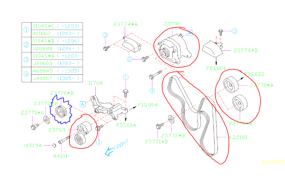

There is a intermittent rattle that is coming from my BRZ. At first I thought it was the alternator pulley, so I replaced the that, along with 1 tensioner pulley, 3 idler pulleys. Attachment 213191 , everything that’s circled blue and red I’ve replaced. There’s also i video i attached, the thing is I can hear it more clear underneath the car.

One of my family members made the original post about the issue I'm having.
Few Clarifications:
-Replaced the alternator with another used alternator from Ebay
-Replaced Belt
-Replaced 2 Smooth Idler Pulleys
-Replaced 1 Grooved Idler Pulley
-Replaced Tensioner
-Manual Transmission for the 2017 Series Yellow BRZ
I find that the rattle comes one after the car warms up after a cold start. Also, it's more obvious when the AC compressor clutch engages, but I found any large electrical load brings the rattle back (Ex: I turned off AC but then turned on seat heaters and defrosters and rattle came back).
I usually can only hear the rattle that comes and goes while idle sitting at a light.
I was going to try to track down where the noise is the loudest using a Mechanic's Stethoscope and possibly going underneath and removing the shield and seeing if I can find anything rattling around...
