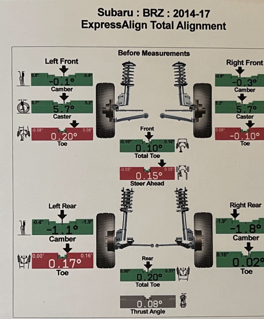

VR4Jr 06-17-2022 05:42 PM
3 Attachment(s)
I suspect the tires are a lot worse at a minimum. They slip much easier from a stop than the PS4S did. The Contis only seem to grip well when they’re really warm while the PS4S gripped like crazy regardless of weather or if they’d been warmed up.
Alignment before and after:
Attachment 212790
Before:
Attachment 212791
After:
Attachment 212792
Uploading the pictures from mobile, so hopefully they’re clear enough.

You went from little bit of rear toe-in (not excessive) to pretty much zero rear toe, but IMO like you say it's more on the tires.
FWIW I ran the same 245/40-17 Conti ECS tires on my car, and initially at the track the rear end *was* a bit more dancy-around on left-right transitions (versus serious 200tw tires). But the grip was there. By the time they were ~half-worn they were a lot more well-behaved and were as fast around New Hampshire Motor Speedway road course as Hankook RS-4 "Extreme Perf" tires. Honestly I think they are pretty great *street* tires, just not necessarily as razor-sharp as I'd like. *Especially* at full tread-depth.

No way in hell with a stock car and that alignment that you have oversteer. Im willing to bet my car that it is caused by how you are driving, rather than tires, or whatever other thing people are coming up with. Almost 0 camber up front on mcphersons? No way the front grips more than the rear.
