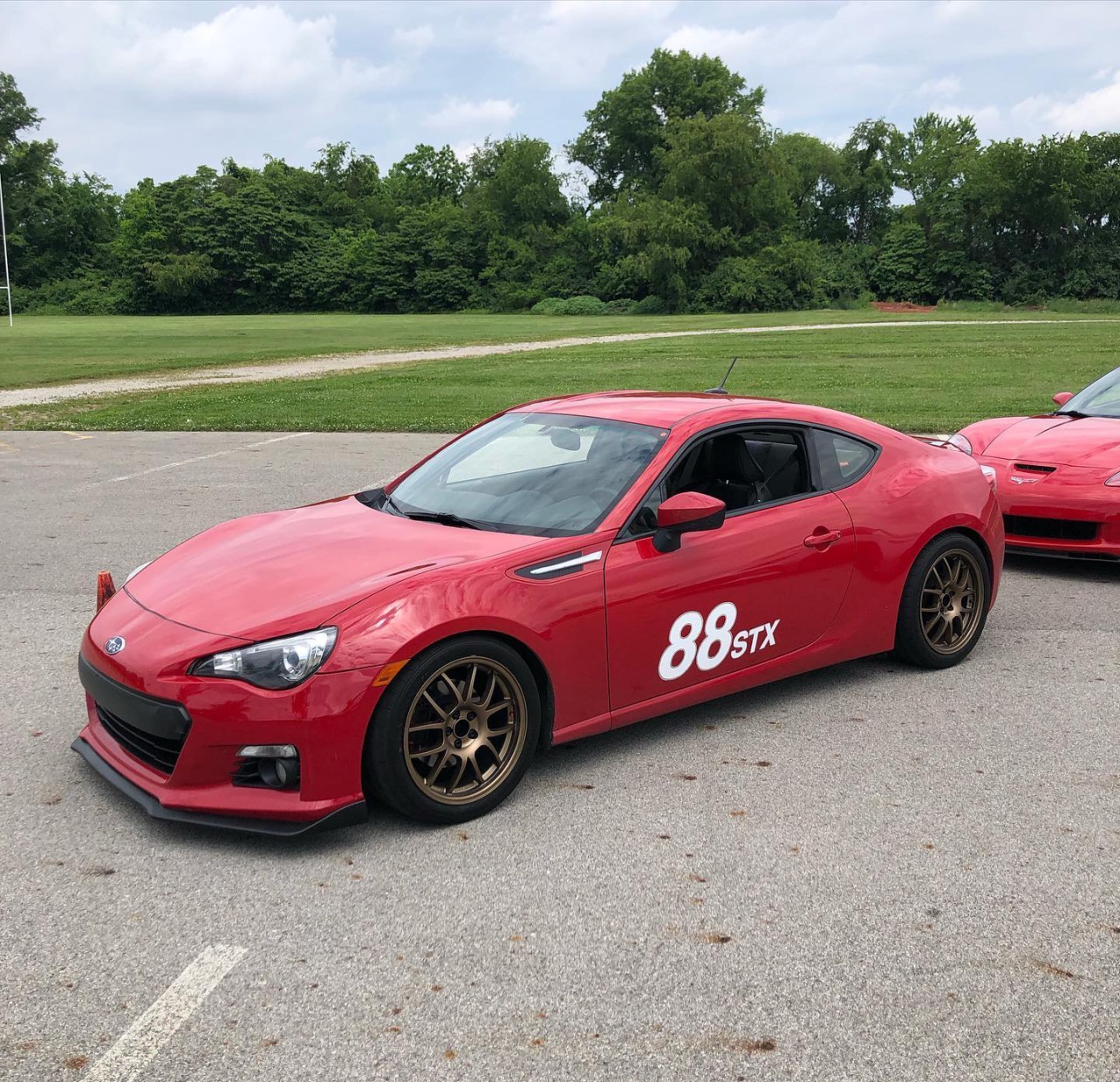

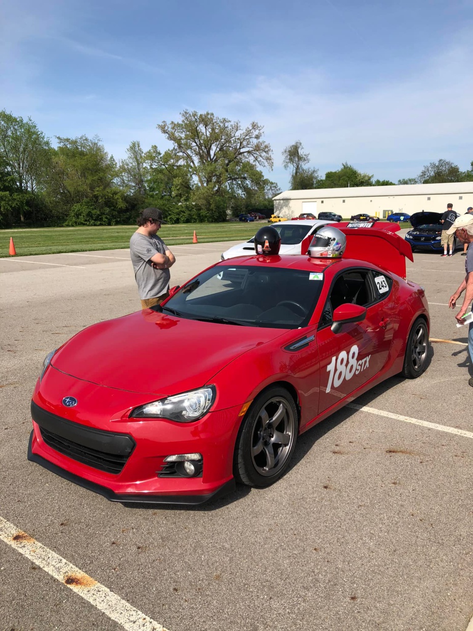

The plan all along was to toe the line between SCCA STX autocross and NASA TT5. SCCA TimeTrial T4 and Gridlife ClubTR were fortunate secondary possibilities.
SCCA ST classes require keeping one catalytic converter, so the hot ticket for power is to do a catless header and keep one cat in the over/mid pipe.
So I ordered a ceramic coated JDL EL 4-2-1 header and matching "Ultra Quiet" catted and resonated midpipe. That order took forever with catalytic converters disappearing from the world economy at one point during covid.
At some point I also scored a used and unmarried Open Flash Tablet tuner.
Wheel choice is also limited in ST classes, with STX being limited to a 17x9. Options aplenty, but I didn't lke any of the Konigs at the time and 6ULs were actively going extinct. Enter the Enkei PF05. 17x9 +40mm
Did I mention this is a 146k mile, northeast Ohio car that was sold to me with Bridgestone Blizzak winter tires installed? Evidence of the "Salt Life" below:
On the Tomei expreme Ti 80mm exhaust: I love the idea of a titanium exhaust. I actually liked the sound of it below 30% throttle and also above 5500rpm. The problem is that real life driving is none of those things and it made my ears bleed if I wasn't wearing a helmet... More on this later.

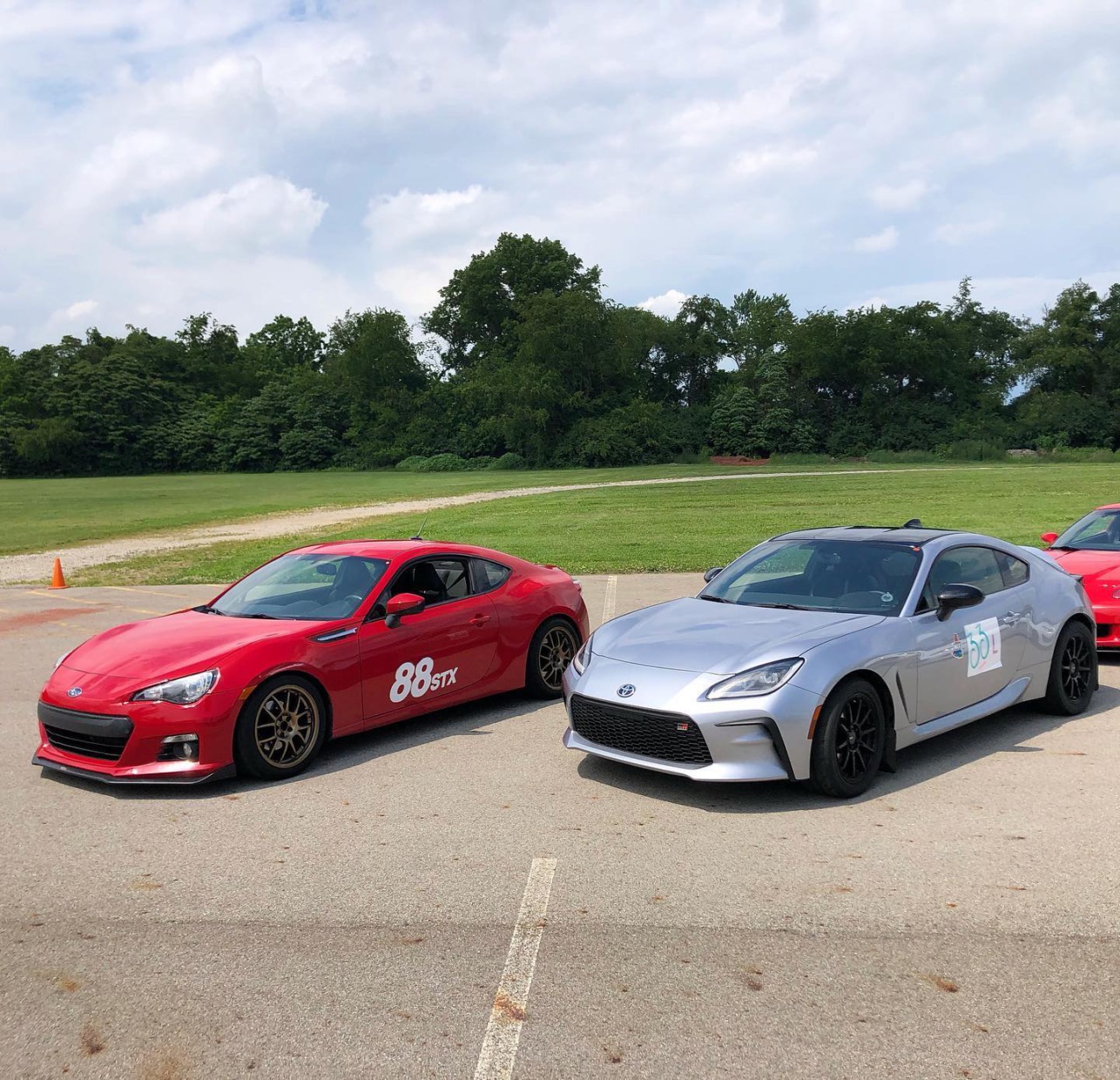

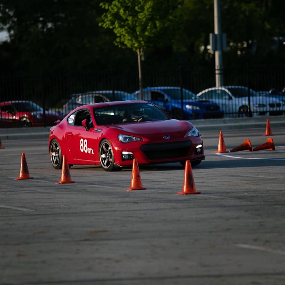

The local SCCA region introduced a weeknight PAX Challenge series, and I did OK at the first of which back in ~May.
I think I was top 10 PAX with the car as it sat, but that just wasn't good enough, so Autocrossification began.

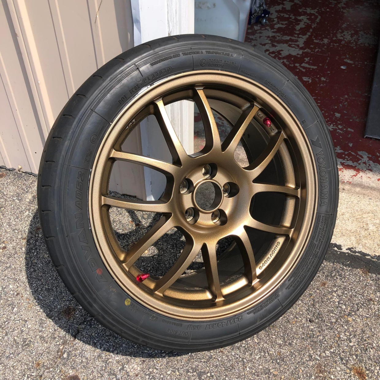

Primary issue to address was tires.

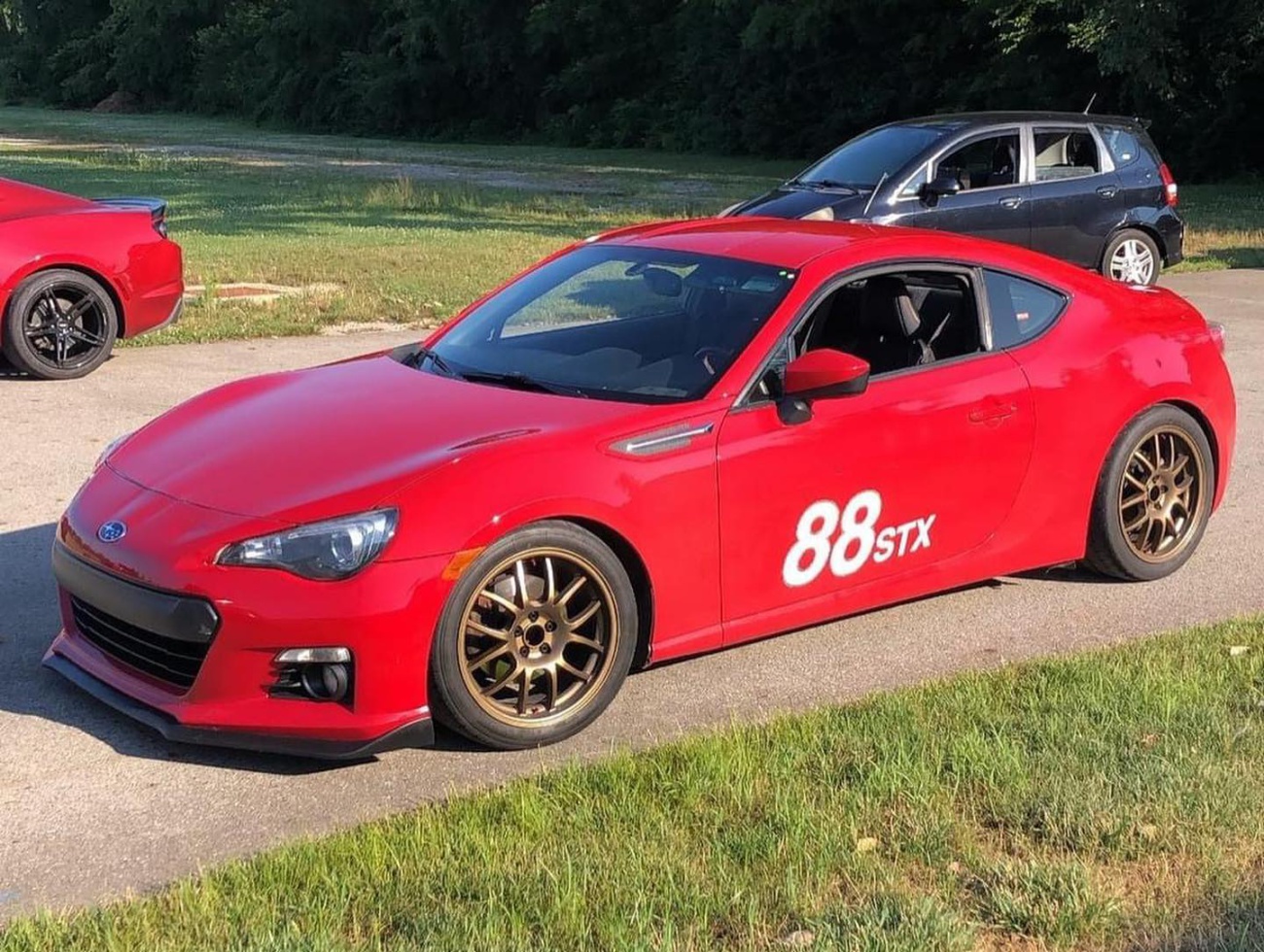

I had installed a set of RE71R scrubs from a buddies NC MX5 endurance racecar effort. They were made in 2016. They worked great for HPDE and street use, but were clearly lacking in freshness for any sort of competitive environment.
Being an eternal "value conscious consumer" I picked up a batch of used wheels from Blub(949 Racing's r&d car) as well as some 2019 AO52s from a local customer/buddy when I sold him some new ones.
The wheels were mostly all Charcoals, but with a few Berylliums and a Silver that were already rattle canned black to match. They needed a fresh lease on life, so they got further rattle can treatment.
Ultimately, one set received the scrub AO52s and the other some scrub 225/40/17 R7s from another customer for future NASA TT5 shenanigans.
Marked A and B after I checked them all on the balancer. Mostly straight A's for street tire duty went rustoleum metallic bronze, B's got faux Beryllium for race tires.
Attachment 213455
Attachment 213456
Attachment 213457
At the time of wheel swap, the whole car got lowered a bit more, front quite a bit to introduce some rake, as well as bumped back up to -4.2 front camber. The rear needs more camber as well, but in my interest of keeping it NASA TT5 legal, I am skipping the normal RLCA upgrade that STX cars would get and have a set of offset RUCA bushings sitting on a shelf waiting for install.

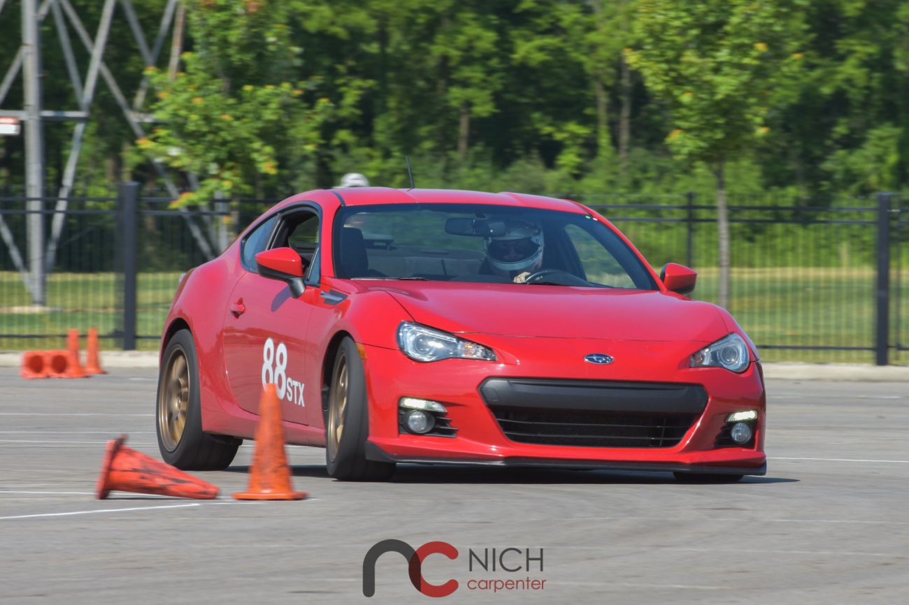

So with still old, but significantly fresher tires, how did it do at a normal SCCA STX points event?
Second(and third) in both STX and PAX. My codriver Brian finishing right behind me in both, but local Todd in a better prepped STX FRS edged us both out for FTD and class win. Todd has brand new AO52s, an OsGiken and some much more focused suspension, lightweight brakes and the allowed control arms for camber.
It was super fun battling with both of them all day, and pretty cool that an FRS on street tires took not just PAX, which is pretty understandable, but also FTD.

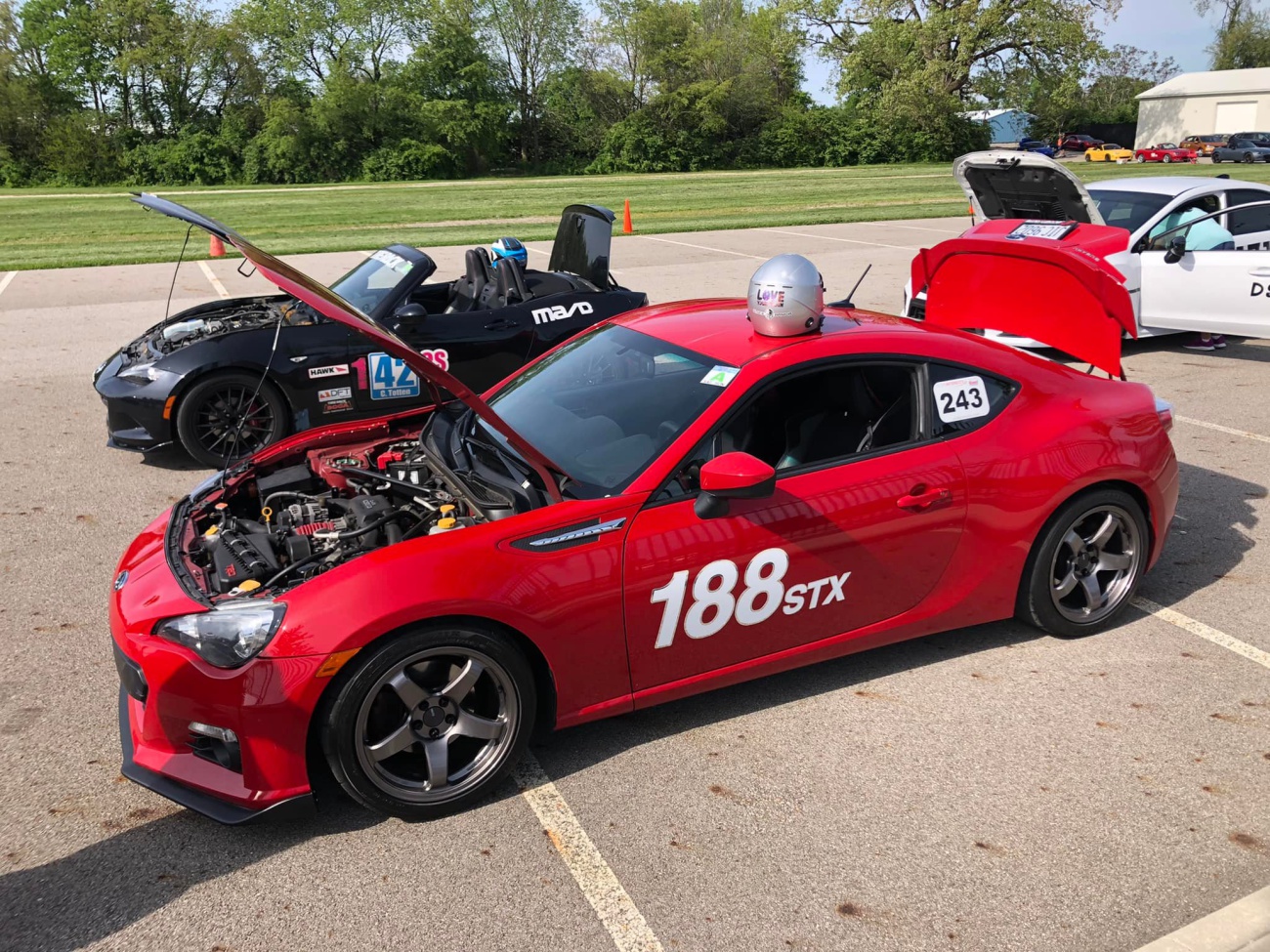

This past weekend was a regional Tour event, so local fast folks were mostly absent from the local event. I have missed 50% of the Points Events so far this year, and had an open weekend, so I took the chance to claw back some STX points on Todd.
No co-driver, and it was extremely evident that I was not able to get these 2019 AO52s up to operating temp. They had ~100 runs when Nick gave them to me, and this was the 3rd events i've done, plus a codrive at the last one, so they're properly baked at ~140 runs.
119 drivers, I was in group A, run first, work second. They ended up switching the day order to ABBA, so I had a crappy 4 hour break from run 3 to run 4. I sat on top PAX most of the day on my run 3, but Ryan(BMW MS Comp) took it on his run 6. I was able to put things together, and had enough tire heat, on my run 6 to claw back the STX win and overall PAX win.

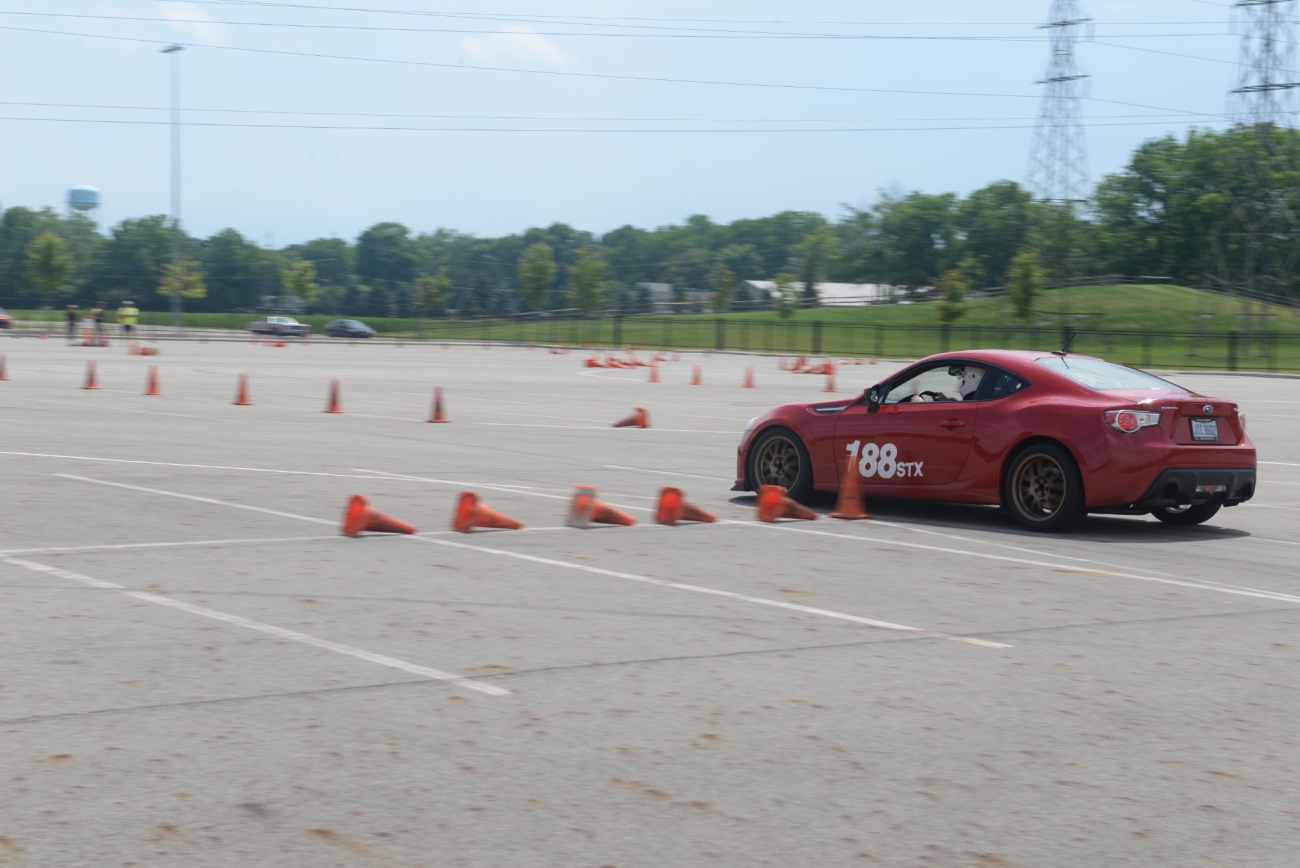

On Wednesday last week I spent the day installing the Xidas and resetting the alignment/setup.
I attempted to contain the variables by running the same setup as before, with just the springrate and damper change.
Balance was off, car was loose. It definitely turns better, too betterer.
My stock rear bar is long gone, so my only easy fix is to remove the rake and lower the rear end, or pull camber out of the front.
Local seasoned national tour STXer beat me by his smallest margin yet, and I'm still on a customer's 2yr old scrubs. We're getting there. I think with another event or two I can knock the rest of my rust off and win on scrubs before buying fresh tires for 2023.
I ended up 4th in raw time, 3rd in PAX, 2nd in STX. ~85 total drivers.
