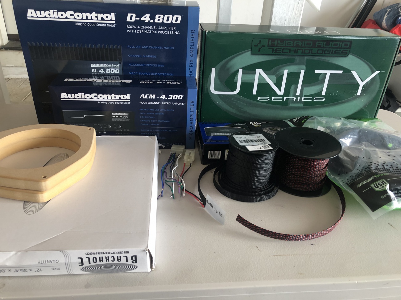

Today was gonna be the day that I get to ADD weight (instead of the ever so popular - Remove weight for track/performance purposes) to this beautiful car.
I started to collect the gear I wanted to install in this car.
Attachment 212131

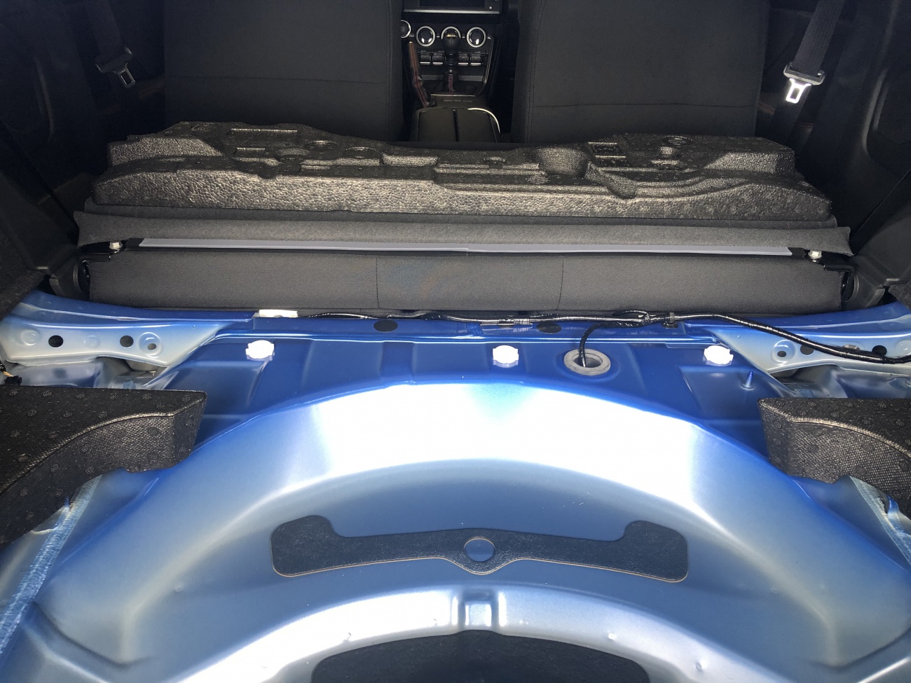

Then when I got under the carpet in the rear trunk, WHAT? No AMP??
How could this be? I guess I really got the BASE model for sure.
Attachment 212132
What gives? Guess I definitely need to go behind the Radio to get signal. Or maybe just the rear door speakers if they are there even.
Thanks for listening to my rant.
Mike
soundman98 05-23-2022 04:50 AM
Yeah, the base has no amp.
There's some speculation that the rear speakers get a filtered signal from the head unit, might not be the best place to tie in.
What is the plug in the corner by where the amp goes? I'm curious if they're using a similar vehicle harness and just bypassing the amp location...
But it should be pretty easy to grab a signal off either the head unit using a metra 70-xxxx and 71-xxx harnesses to make a pigtail, or jump over to tacotunes.com, and grab a tweeter wiring harness plug for the 16+ tacoma to get the signal after it leaves the head unit.
Also, previous gen install required different screws for mounting speaker rings like that. I just trimmed the adapters down on the corners with a router until the OEM screws grabbed.

I was wondering about that as well, it looks like its part of the electrical in the trunk to release the trunk lid in case you get stuck inside or part of the lighting back there. Dunno really. Ill try and trace it down.

soundman98 05-25-2022 12:36 AM
yeah, they should work fine, the only disadvantage is that there's only a small amount of wire coming out before it's all spliced together
alternatively, if you're just replacing everything including wiring, you could just connect to the speaker terminal connections on that adapter-- all it's really doing is shorting the connector to send the signal through the existing wiring to the door speakers. if you're re-wiring everything anyways, it won't be of any consequence to leave it that way.
