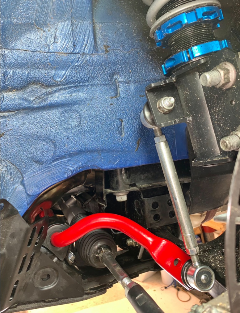

I'm waiting on Cygnus' specification, Fortune Auto, Performance X-1 Motorsport Edition Coilovers with high caster Cas/Cam plates, digressive valving and 7K Hyperco Springs.
I'm also waiting on the coilovers to install Voodoo 13 Rear LCA’s and RacerX adjustable, bump steer correcting, rear toe links at the same time.

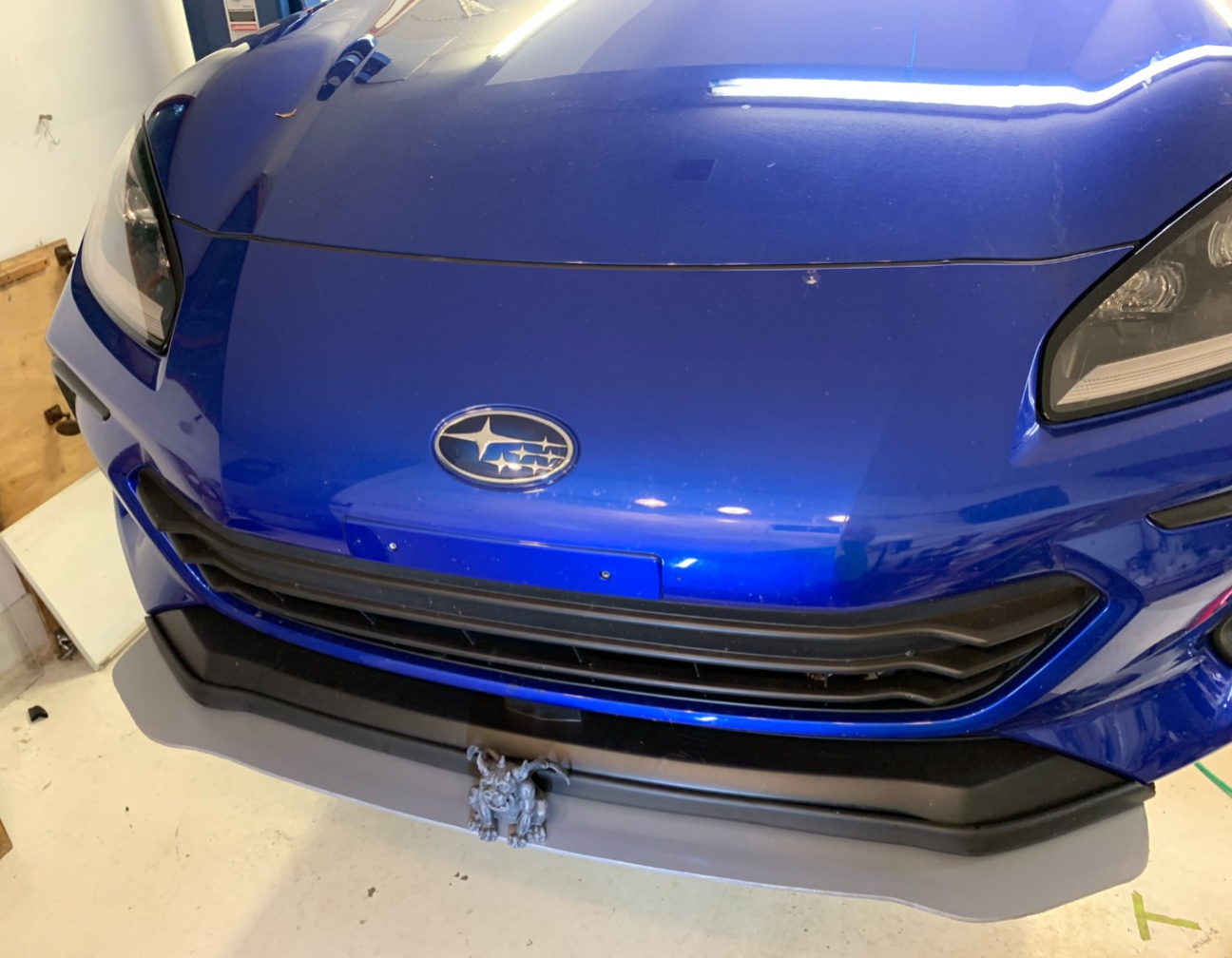

Alumalite Splitter Ready to Mount
Here's the finished 6mm Alumalite splitter I've made. It projects 5 to 5.5 inches beyond the front lip of the fascia. The front edge is sealed with Permatex ULTRA GREY gasket maker. A rubber trim will form a small dam where the splitter meets the fascia. I bonded in nutserts to the plastic piece in the fascial that stiffens the bottom. One custom bracket in the center of the rear edge and it is supported.
It weights next to nothing!

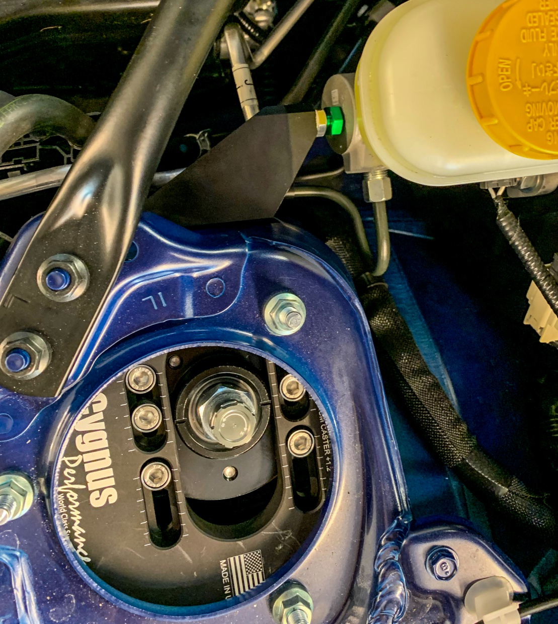

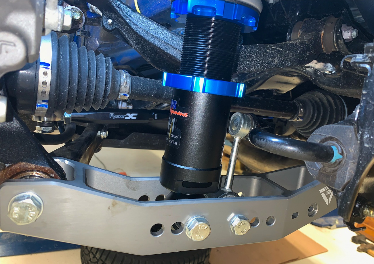

Scargod 03-17-2022 08:03 PM
2 Attachment(s)

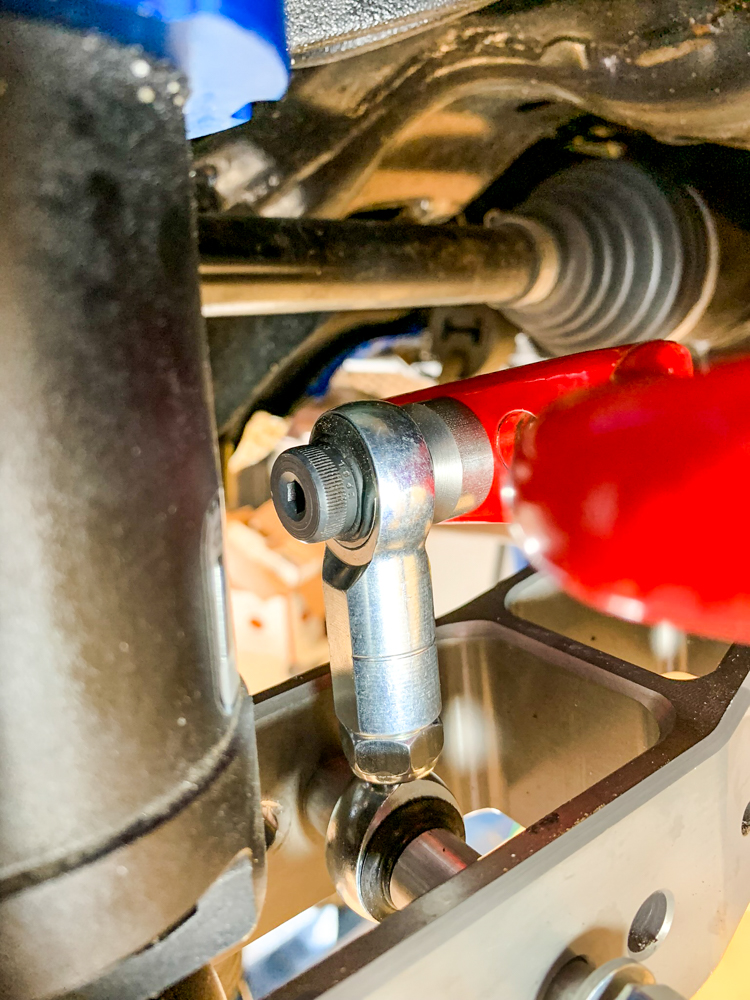

Caster and camber plates from Cygnus Performance. Below are Cygnus' Performance X-1 Motorsport Edition Coilovers. I'll show them when I get the height set.
The el cheapo master cylinder brace cost me $29.25 on Ebay. It's good quality and does the job. I did chose to use better mounting bolts with washers.
The other pic is the Voodoo LCA and RacerX toe link rods.

raisingAnarchy 03-18-2022 12:31 PM
Loved your build over on iwsti, super excited to see this here!
Do you intend to adjust caster? If so, what makes you want to do that? I'm very new to suspension tuning.
Scargod 03-20-2022 08:19 PM
Caster is something you almost can't get enough of. The "caster/camber" plates give me about 1.5° of additional positive caster that is non-adjustable. You could start slotting holes or reworking the shock tower.
I've been doing a rough alignment on the car since I've added a lot of new parts. Previously, I have always done my own alignments. This week I'll take it to a shop and see what they can do. A lot of alignment shops don't want to do race cars...
I couldn't get over, roughly, -2° camber on the front, left side. I was easily able to get -3.5° on the right! Tomorrow I'll put in a smaller diameter bolt up top on the knuckle.
I'm down to 3.5 inches of clearance in the front. That's about a 2" drop. I'm going to back it off to four inches. I wonder how high most speed bumps are?

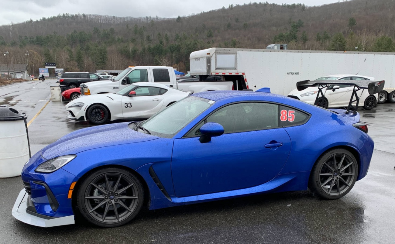

Scargod 03-26-2022 07:53 PM

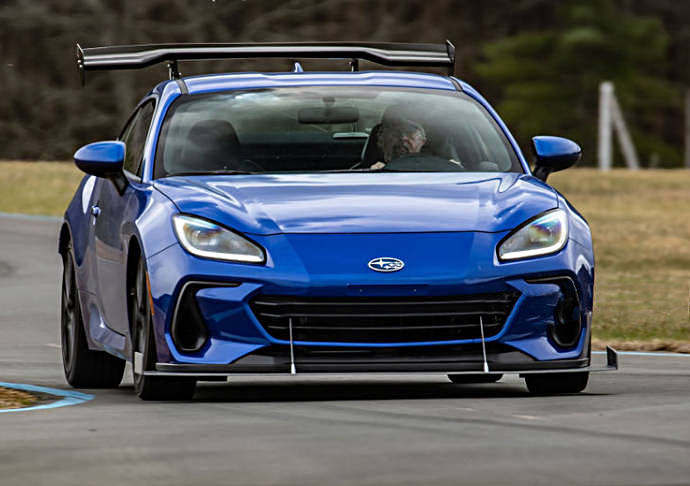

First Track Day!
My first outing with the BRZ. I did a car control clinic. That was interesting. I got some rear end movement out of it but mostly the front end wanted to plow, so it was self-defeating, in that it made noise (the Michelins are noisy!) yet it was not the fast way around the course.
The car did do better on the race track, even though it was wet. Of five laps I timed, my average speed was 75. This was at Lime Rock, a 1.5 mile course. Still, on slower turns it understeered.
I'm running G-Loc R12 pads front and rear. They were fine in the rain! Very predictable and consistent. A little noisy on the road as I drove to and from the track with them.
There were two other new BRZ's there! One was in my advanced group, but he was hindered by tires that weren't great in the wet.

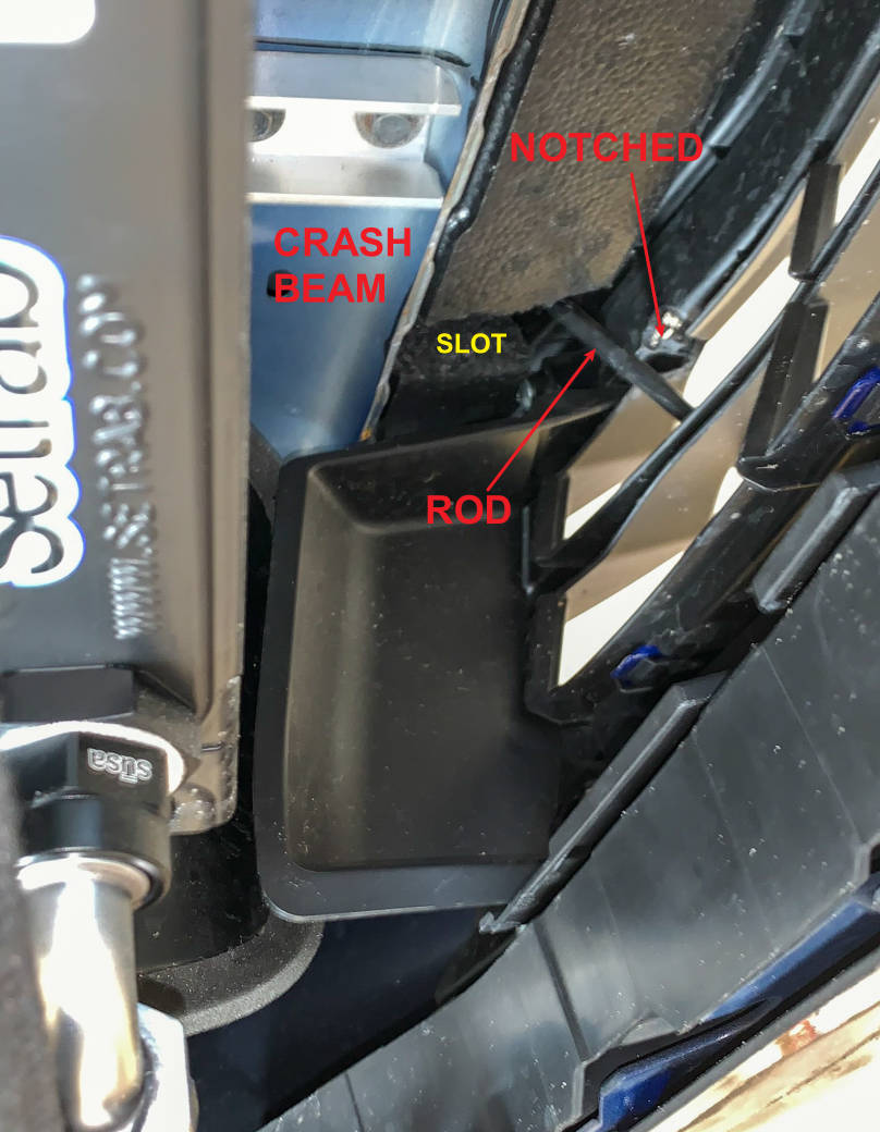

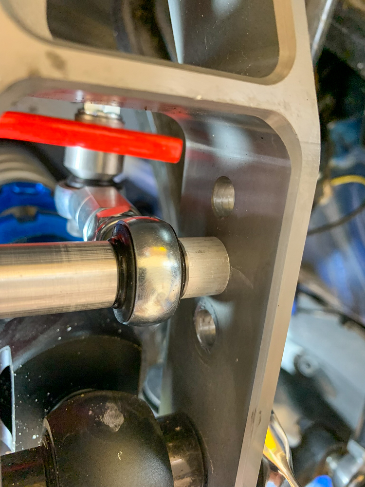

Are these splitter rods mounted to the flimsy plastic of your grille or is there more going on that tie it to your chassis that we cannot see?

Scargod 03-29-2022 05:24 PM
The CF rod is attached to the steel crash beam with this McMaster-Carr ball joint linkage. I drilled it out to 5/16" so I could epoxy the rod into it. The only issue with my design is that you have to figure out the length exactly unless you slot the beam or make a special bracket to attach to the beam.
The grille is slotted a little, but you do not see it from above. When the splitter is on, the rod is positioned more forward in the notch I cut in the grille.
You can also see one of my Setrab oil cooler mount brackets attached to the beam.
Attachment 210684
I did a track day and there was no issue with any of it.
I think I will add a threaded end to the upper end of the rods so I can unscrew them from the top mount once I have removed the splitter. Then I won't have to remove the fascia to get at them.

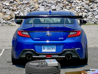

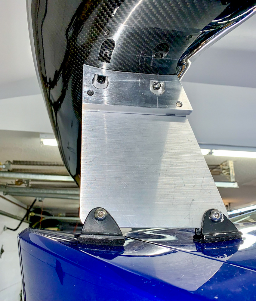

NoHaveMSG 04-01-2022 01:06 PM
2022 BRZ, Scargod's Mod's and Track Upgrades
Your wing is pretty high with a lot of AOA. That wing can handle being mounted below the roof line a bit. I run mine with the risers removed with less AOA, it was far too much with the standard riser setup and the car was considerably less drag limited on the straights.
Here is how mine sits. I’m not advocating running it as low as I do, but I believe reducing the height should help some.
