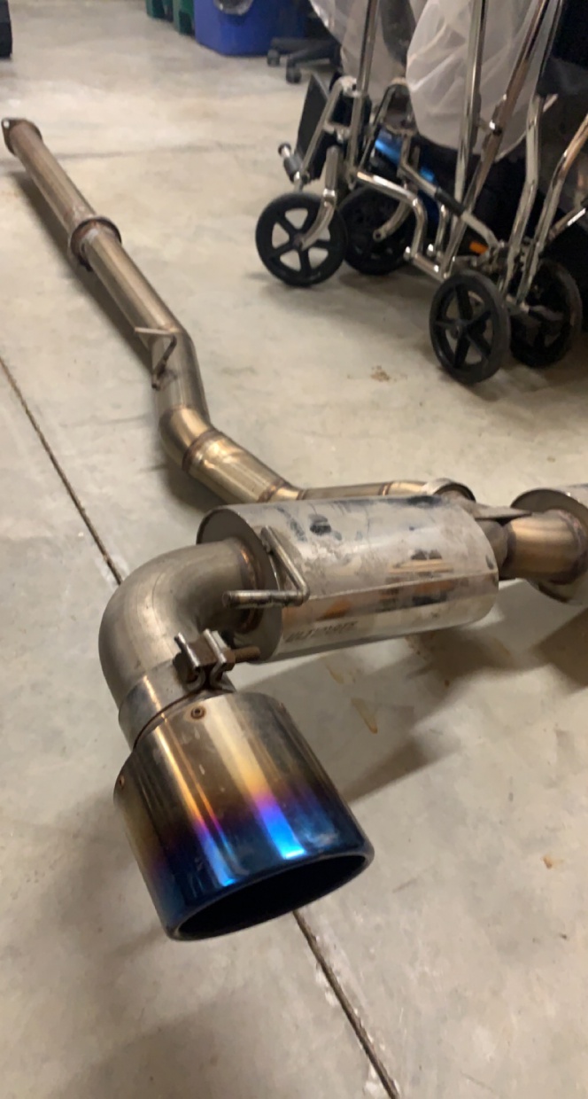

Just bought this used ultimate racing catback for my brz. Im planning on cleaning the mufflers and tips before I install it but once I start I'll probably just end up doing the whole thing. Just wondering what is the easiest way to clean/polish a stainless steel exhaust? would steel wool and some polish work?

The combination of Nevr-dull and then Mothers Mag & Aluminum Polish with a cloth has always worked well for me.
I haven't tried steel wool myself.

For dirty exhausts I used steel wool and cleaning vinegar as a rough pass, then mothers metal polish with a microfiber to finish. Sleel wool and polish works too, though on the tips a microfiber gave me a better finish.
+1 If you can get a mother's powerball and use a drill for final polish.
Cleaned up a unloved TRD exhaust over the summer using this method. Did it quick and dirty.

Flitz Metal Polish. Follow the directions for the material being polished. https://www.flitz.com/
