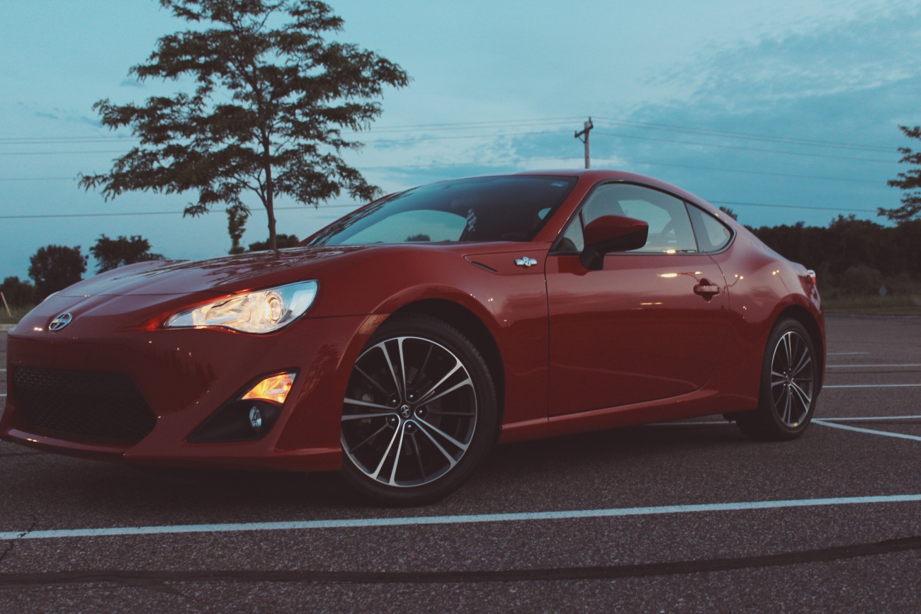

Hello! This is just going to be my build thread as well as track updates for anyone who cares. I got my M7Y 2016 FR-S in mid February of 2020 in Minnesota as my first car, turning 16 not long after. The car was in very good condition when we bought it, having just under 78k miles, and the only issues were some small paint chips around the car and some smaller scratches on one spot on the hood, not noticeable unless you are looking close!
What the car came with:
USDM TRD Sway bars Front + Rear (the red ones) - PTR1118130
USDM TRD Racing Exhaust - PTR0318170
Firestone FR740 tires - low quality all season tires
Attachment 222541
My initial plan was to increase some of the performance to make it more pleasurable while making sure it looked good and usable to the naked eye.
