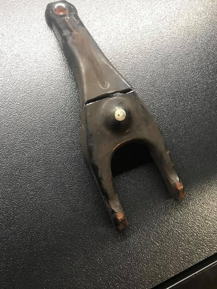

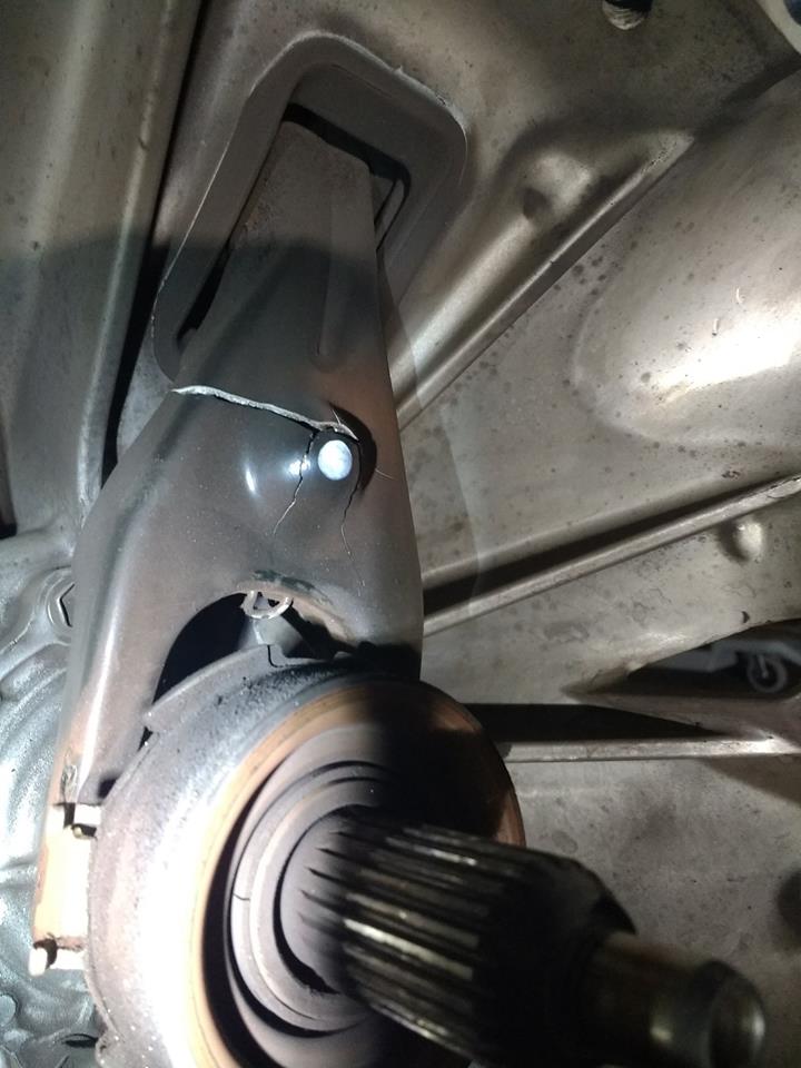

VerusEric 01-03-2022 04:48 PM
Originally Posted by FrickingReallySlow (Post 3492614)
Didn't see this in time, but the OEM fork actually went through 2 updates. With the latest one also being used for Gen2 which has to handle more torque and herspers so ppl might want to give the new updated version a try if they're not 300bhp+. Its 30531AA220 for both gens and only $26 instead of $175 for verus
Originally Posted by blsfrs (Post 3493037)
Anybody have a side by side comparison of 1st and 2nd gen forks?
I'll work on ordering one to compare to the factory units we have here.
Originally Posted by WNDSRFR (Post 3493043)
I have a 1st gen fork on my 200,000 mile "13 FR-S. On my third TOB but the fork is original. Works fine, lasts a long time.
I guess I could spend a bunch of money on an aftermarket part, but why?
You are one of the lucky ones. We've seen people with cars that are barely out of warranty broken in various locations. No rhyme or reason for the failures.
