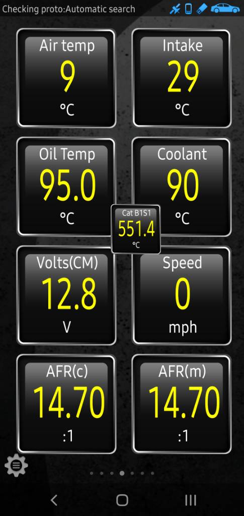

Car not starting in first attempt is a tune issue with fueling. Get it adjusted with delicious. Its hard to take a start up data log and analyse but speak to them as it should not happen normally. May be 1 in 100 times is ok.
For what to log , just buy torque Pro if you use android head unit or android phone and configure coolant temp, oil temp, AFR measured etc. Something like what I have
done. You will need a Bluetooth OBD2 dongle.
Attachment 206643

Thank you so much for the input so far, i will try to run some datalogging and post it here as @tomm.brz suggested
Also @Brz-123 does torquepro work with ecutek obd2 bluetooth donge or would i need to buy a different one?

It should work with and bluetooth obd2 dongle. The app is only few euros. Worth trying.
