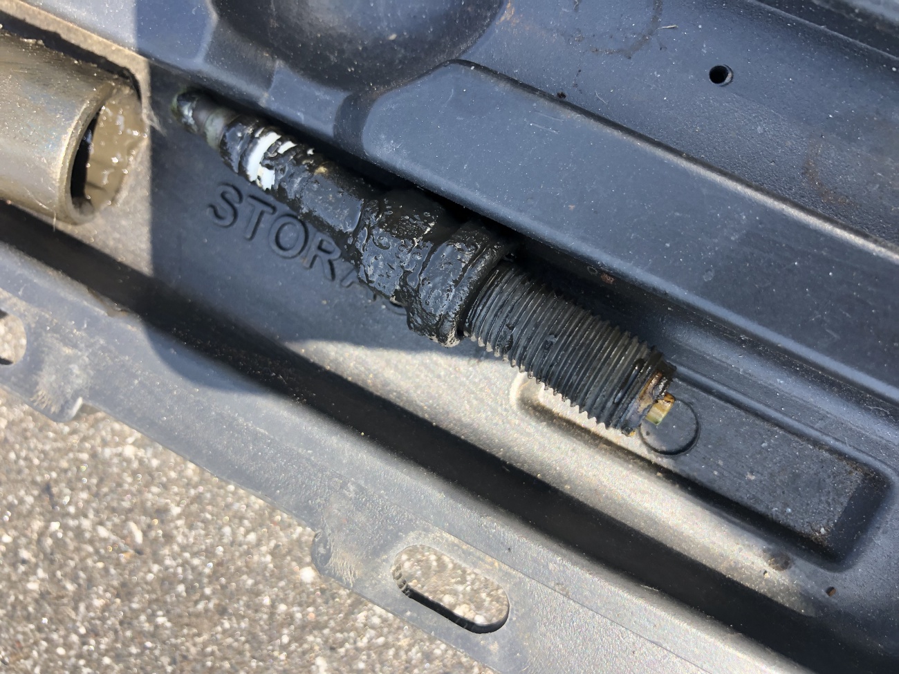

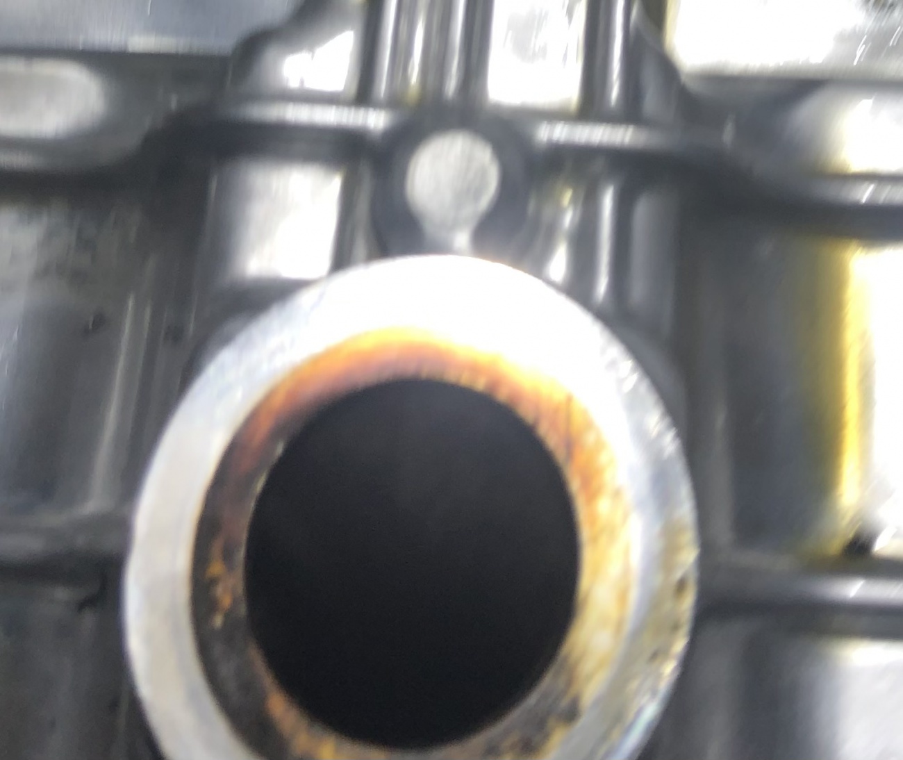

130k mile 2013 brz. Spark plug gasket on cylinder 4 is leaking on plug and coil pack, shorting the connection causing spark plug tip to explode.

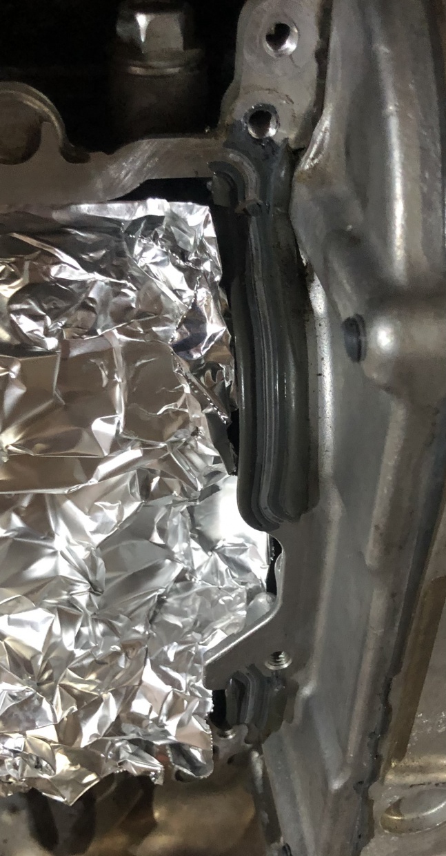

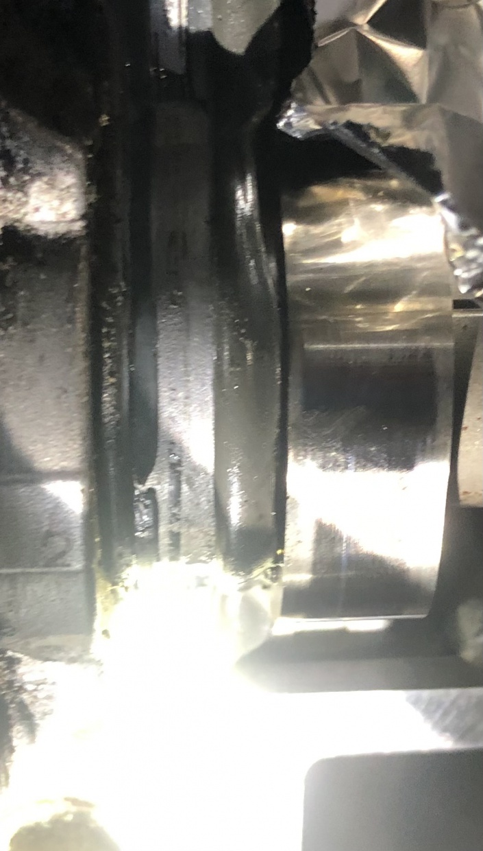

Update: pulled engine this week. I guess material on plug tube gasket just wasn’t thick enough to seal. Cleaned up and reinstalled. Used much less rtv than the factory. Looks like it was even on the cam lobe in last pic

Ummm. Hopefully all the pieces escaped and there is no engine damage. You MAY be able to replace the valve cover gasket and spark plug tube gasket without pulling the engine but it will be a PITA.

I would undo both motor mounts, lift the engine up by the oil pan till the motor mounts clear the cross member, and push it over to one side(make sure you don't knock the engine off the jack). Alternately you could also remove the motor mounts off the block so you could mess with the height to get the most space, but I am pretty sure lifting up will get you the most. That is how I did my brothers Forester. The issue with the FA is they use a bit of sealant on the valve cover gasket. So you would have to scrape that off, clean up, and reapply in that little space trying not to get any of the old stuff into the head. It's a PITA. 6 beer job, 4 while working, 2 for after while you are putting your tools away. If you have the equipment, it takes about the same amount of time to just pull the motor, fix, reinstall.

There is a gasket for the perimeter, and for the spark plug tube, but it uses sealant too in a couple spots.
