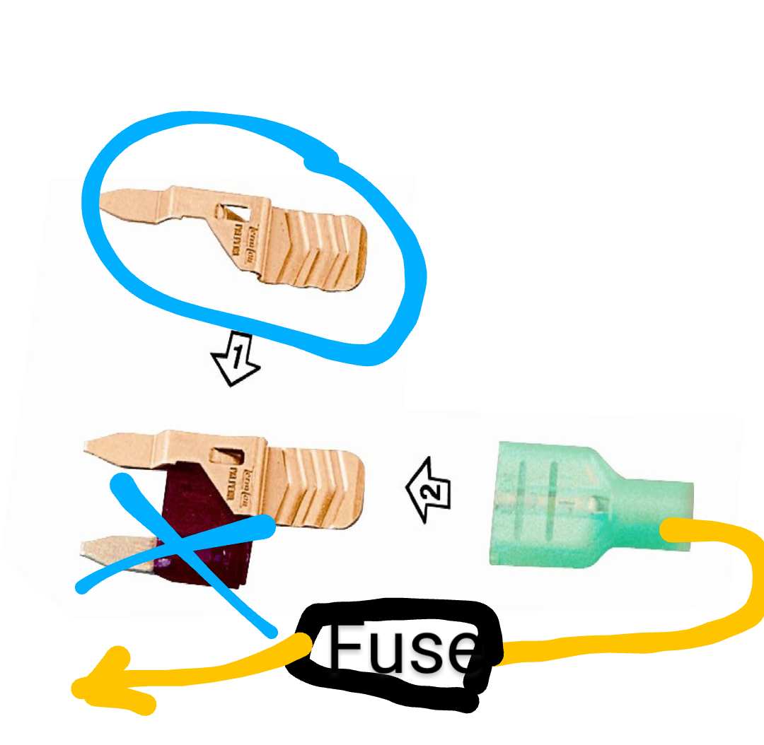

Do you have and know how to use a multimeter? Find an unused fuse spot in the engine bay fuse panel that is switched on while the vehicle is running and switches back off when you shut the car off, and tap into that circuit using a fuse tap kit such as this one,
Attachment 203692
and then by adding a fused wire to the hot side (as opposed to the load side) of the fuse position.
