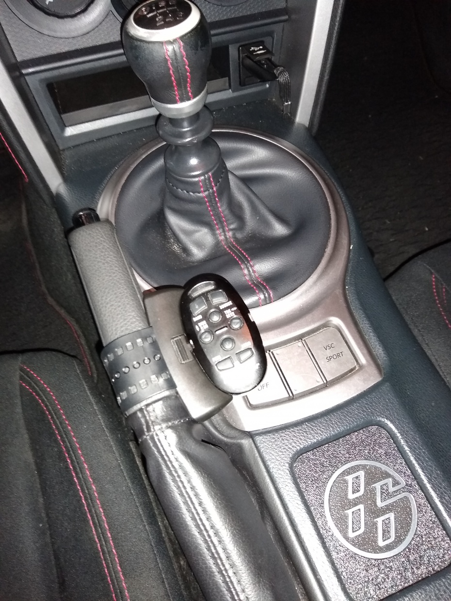

Doing a quick Google search on the model number you provided, I see that your head unit is a Kenwood product. Finding the installation and operation manual, for your unit, I see that it has an optional infrared remote available. It also has a Light Blue with Yellow stripe wire that is used for steering wheel controls. Getting the steering wheel controls working will be custom project with your car, you don't HAVE to mount your control on the steering wheel, though. You might try a location on the center console, and you might even be able to find a control with an actual knob to turn.
Some Bluetooth controls can control volume, but most only control the track functions.
Personally, I use an infrared remote that I can strap to the emergency brake lever to control my Pioneer.
Edit: As I look closer at the installation manual for your head unit (which covers several different models), I now see that your particular model DOES NOT have the light blue and yellow wire, so wiring in a remote like @Compelica did is not an option for you. If I were you however, I would pull the head unit out and physically look for that wire, you never know what the manufacturers will do from country to country.

Your head unit must have either that light blue/yellow wire or you'll have to use the jack on the back for you to hardwire a remote to it. Check for one of those two options first before ordering a control for it. You'll have to program the head unit to learn each button.
