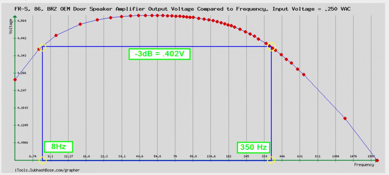

There are reports that this new Harman audio system architecture results in a significantly lower quality sounding overall audio experience. This is understandable seeing how prior to this change, the OEM door speaker amplifier would take the speaker-level signal from the front outputs of the older head units, filter them by removing the frequencies that are already being reproduced by the dash-mounted mid-range drivers (along with adding a subsonic filter for those ultra-low frequencies that can't be heard anyways), see post #17 in this thread here, https://www.ft86club.com/forums/showthread.php?t=145467
which talks about this frequency output curve that I plotted,
Attachment 202963
and amplifies that signal, sending it up to each 6-1/2" door speaker, resulting in a cleaner, slightly louder and more accurate sound reproduction.

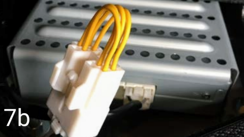

How do you know if you have this dealer modification? Lift the floorboard in the trunk and examine the door speaker amplifier and its two plugs towards the left-side seat back. If the 10-pin harness has been pulled out of the amplifier and a yellow-wired jumper harness is attached to it instead, and both door speakers are playing sound, you have this modification. Alternatively, if there is no 15-amp fuse in the AMP position of the underdash fuse panel, and your door speakers are still playing sound, then you have this modification. However, please note that there have been reports that some of the dealers making this modification did not complete some of the steps in the instructions when installing the Harman head unit, so be aware that your jumper harness may not have been properly connected to the amplifier harness or may not have even been installed at all. If THIS is the case, then your door speakers will not be playing any sound at all and the entire system will sound very tinny with almost no frequency output below 3,000 Hz. The dash mid-range drivers have a 6dB/octave filter in the form of a 100 microfarad capacitor attached to them for a high-pass crossover value of 3,975 Hz. See post# 69 in this thread here: https://www.ft86club.com/forums/showthread.php?t=7843

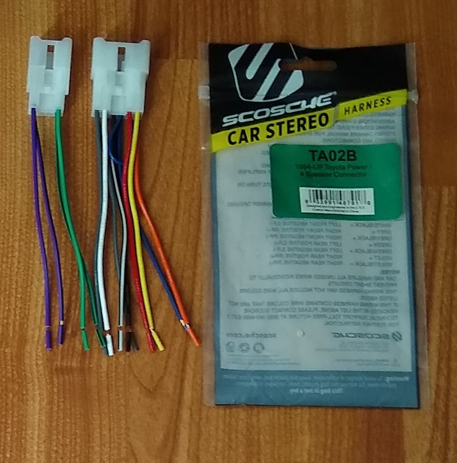

- One Scosche P/N (Part Number) TA02B, Toyota Car Stereo Adapter Harness (female plugs)
Attachment 203061
The 10-pin harness of this part will plug into the OEM power/front speaker harness in the vehicle. The 6-pin harness will not be used.

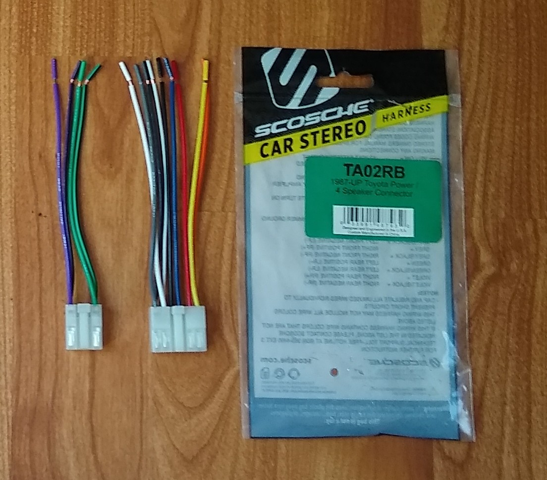

- One Scosche P/N TA02RB, Toyota Car Stereo Reverse Adapter Harness (male plugs)
Attachment 203062
The 10-pin harness of this part will plug into the Harman head unit. The 6-pin harness will not be used.

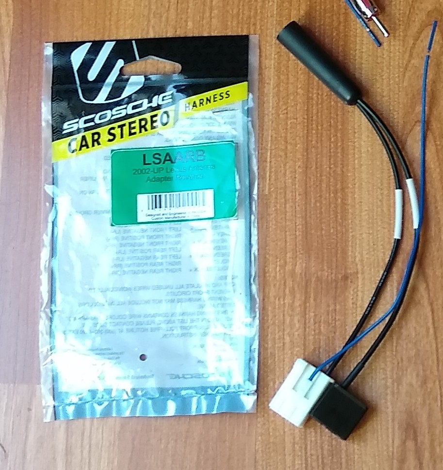

- One Scosche P/N LSAAB, Lexus/Scion/Toyota Antenna Adapter Harness
Attachment 203063
After optional modification, this will plug into the antenna/antenna turn-on harness in the vehicle.
- One Scosche P/N LSAARB, Lexus/Scion/Toyota Antenna Reverse Adapter Harness
Attachment 203064
After optional modification, this will plug into the Harman head unit.

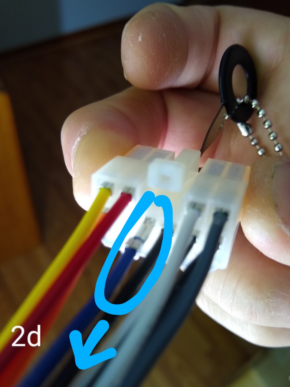

1) Remove only the 10-pin REVERSE harness (P/N TA02RB, male plug) from its package. I recommend leaving the 6-pin harness in the bag to be retained for future projects, you never know when you'll need the extra parts.

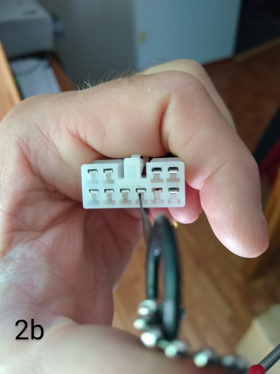

2) De-pin the blue wire from the molex plug. This can be accomplished by using your de-pinning tool or sewing needle. It may take several tries to find the right spot, but you want to release the tiny plastic clip that holds the pin in the plug from the pin side and lightly pull the wire out from the back side of the plug. I recommend holding the wire in a vise and holding the plug with one hand while you attempt to unclip it using the tool or needle with the other. Once you get the clip lifted up and away from the pin, the wire will easily slide right out. If you have to pull hard, the clip is not yet released, just be patient and gentle, but persistant. See the pictures below.
Attachment 203071
2a Blue wire and pin to be removed.
Attachment 203072
2b Hold plug in one hand in same orientation as in this picture, use tool at an angle just underneath and towards the metal pin in order to catch the plastic clip.
Attachment 203073
2c Once plastic clip is caught, push the clip away from the pin by pushing the opposite end of the tool up.
Attachment 203074
2d Once clip releases the metal pin, wire will slide easily out from the back.
Attachment 203075
2e Blue wire de-pinned from male harness. Set this aside for now.

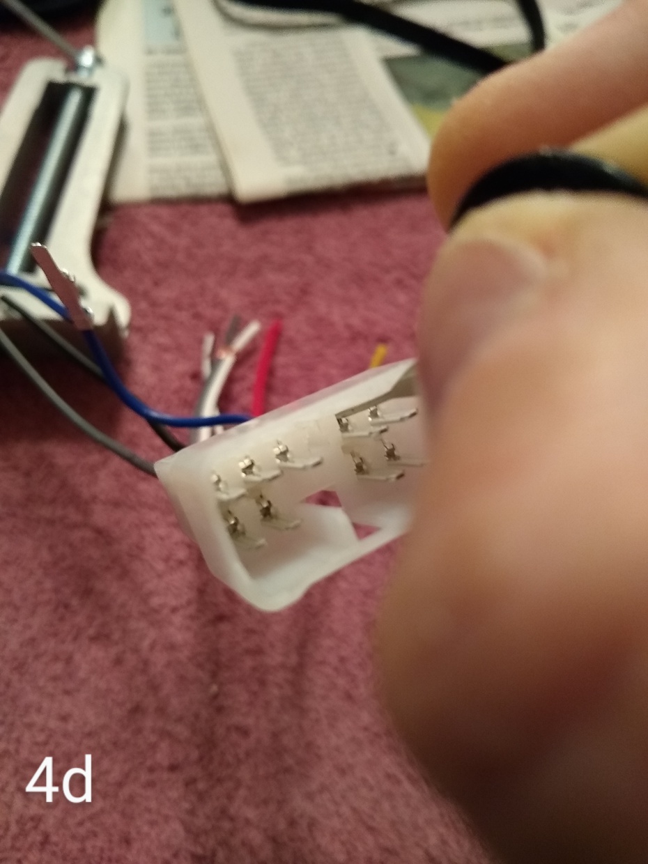

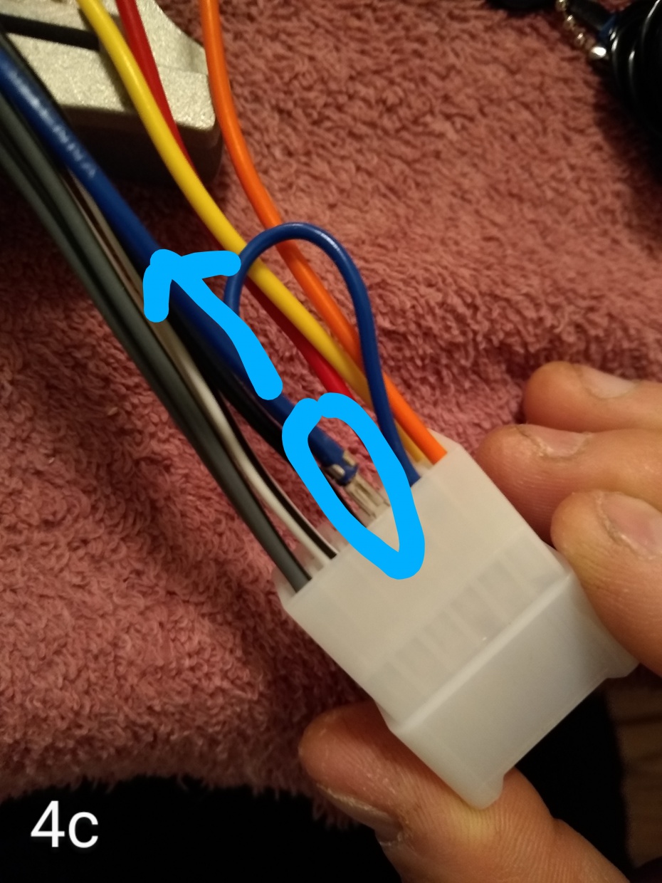

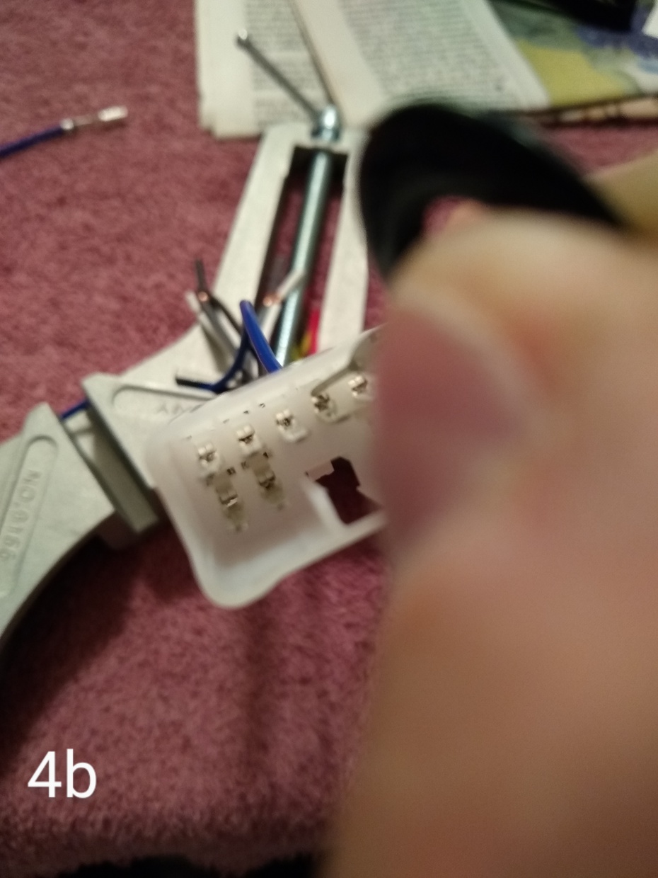

3) Remove only the 10-pin harness (P/N TA02B, female plug) from its package. Retain the 6-pin harness also as you did in step 1.
4) Using the same procedure as in step 2 above, de-pin BOTH blue wires from this harness. See the pictures below.
Attachment 203078
4a Two blue wires and pins to be removed.
Attachment 203079
4b De-pin the double blue wired pin first from the harness.
Attachment 203080
4c It should slide right out once you push the plastic clip out and away from the metal pin.
Attachment 203081
4d Now de-pin the thinner blue wire from the harness.
Attachment 203082
4e Remember to push the plastic clip away from the metal pin.
Attachment 203083
4f It should also slide easily out.

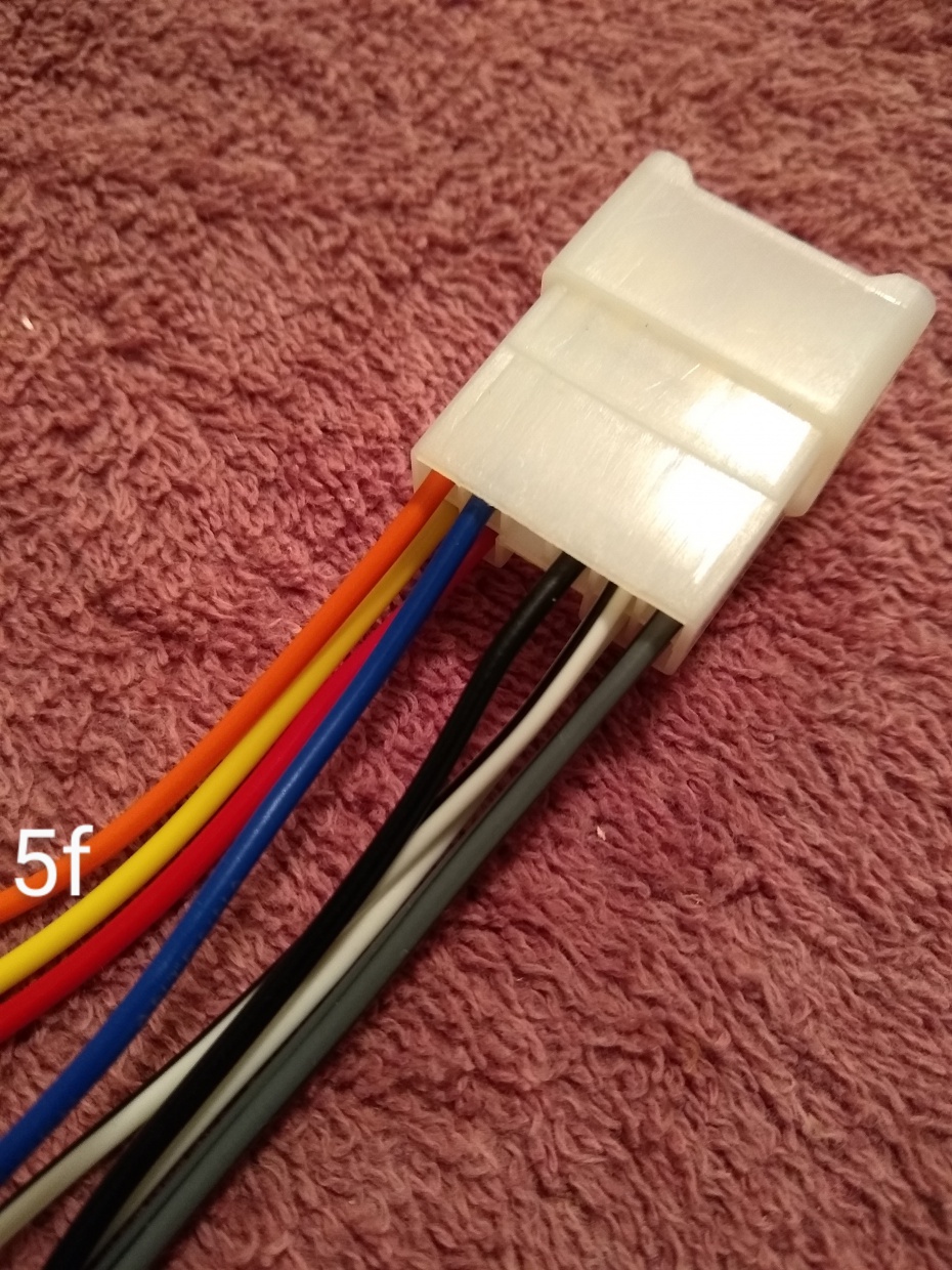

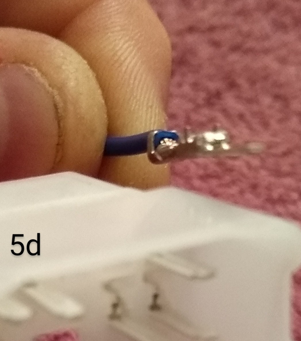

5) Once you have both pins/wires removed from the plug, cut the shorter wire off from the double-wired pin as close to the pin as possible, see pictures 5a and 5b. Paying close attention to the orientation of the plug and the pin in pictures 5c and 5d, reinsert the longer of the two separated blue wires back into the plug in the position next to the orange wire as can be seen in picture 5e. This completes the modification to the female harness, picture 5f.
Attachment 203137
Attachment 203138
Attachment 203139
Attachment 203140
Attachment 203141
Attachment 203142
5f Female harness de-pin/re-pin is complete. Set this aside.

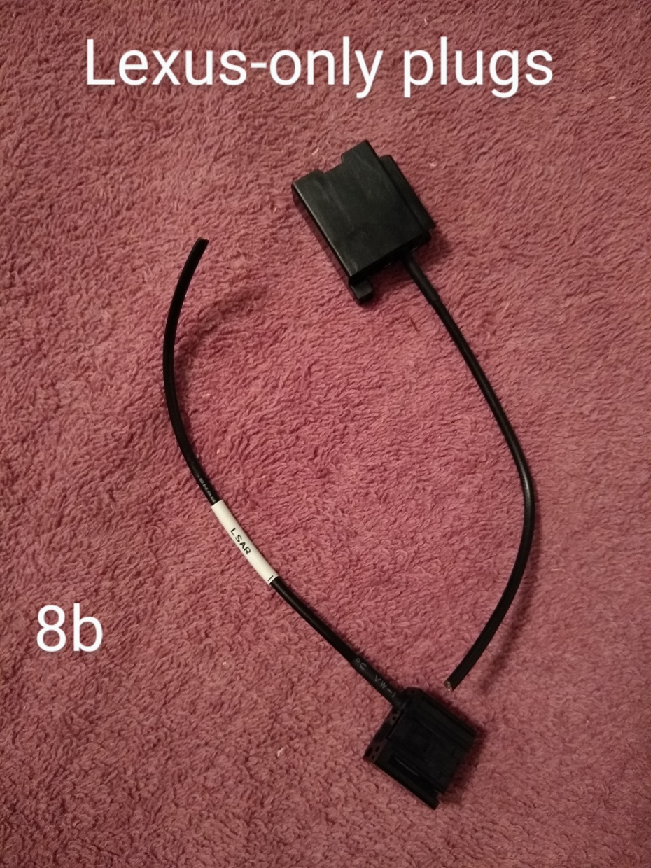

6) Remove the antenna adapter harness and the antenna reverse adapter harness from their respective packages.
7) At this point, you can either decide to plug the black Lexus-only male and female plugs together and skip on to step 9, or for a cleaner finished product, you can continue on to step 8.

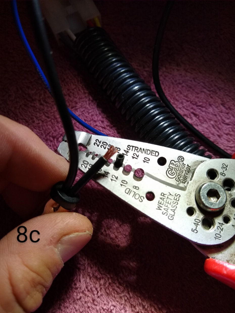

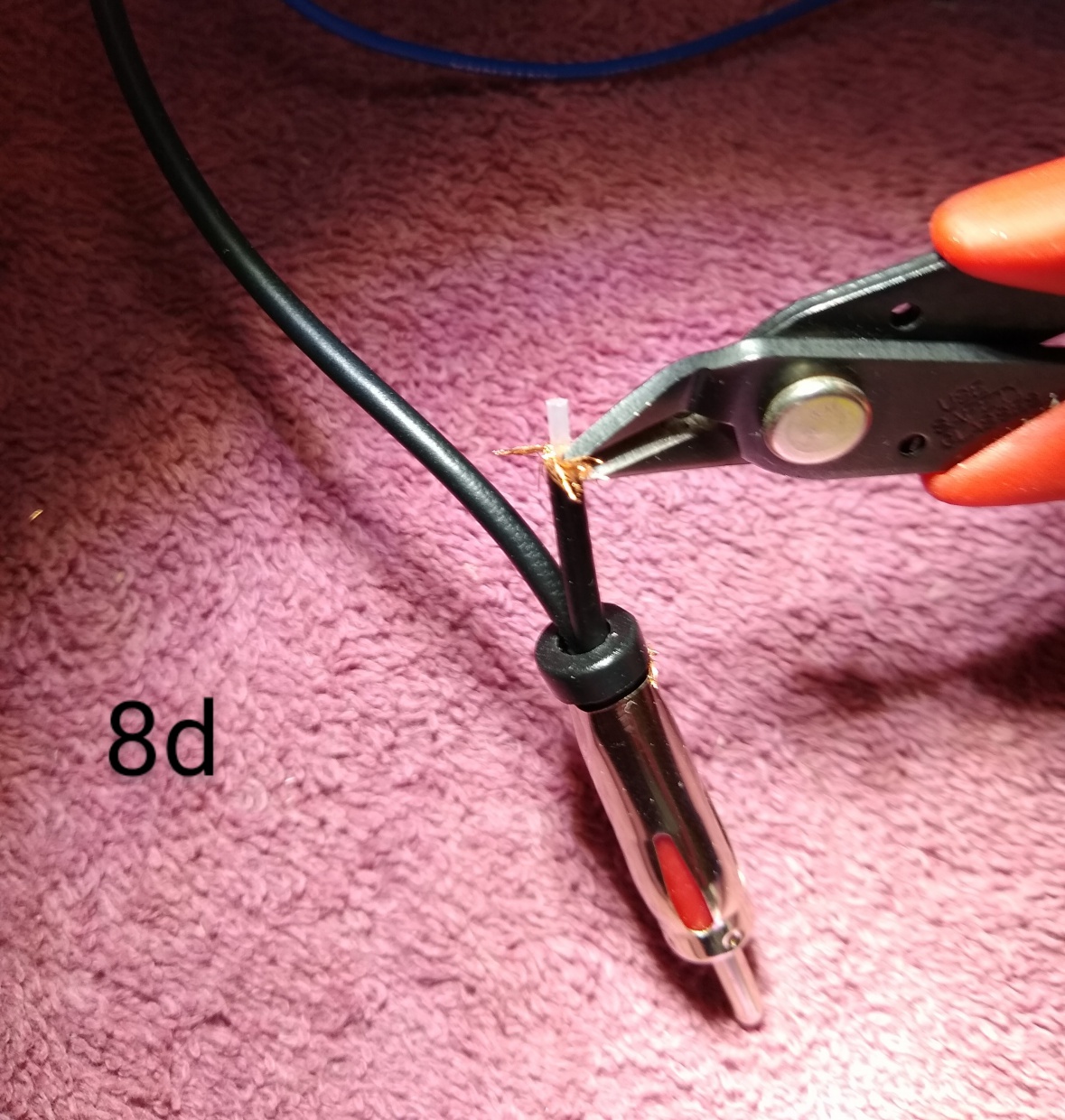

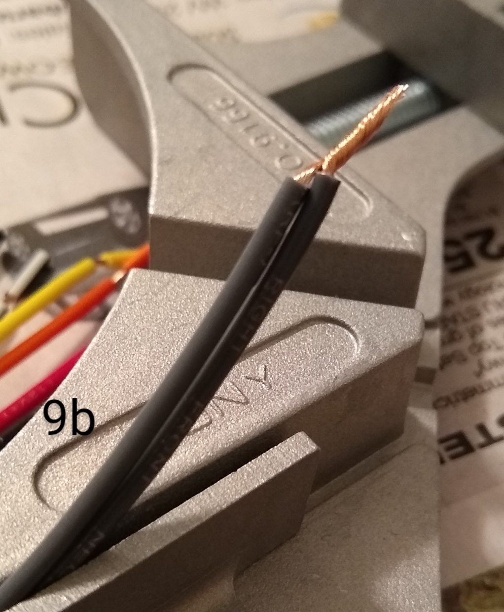

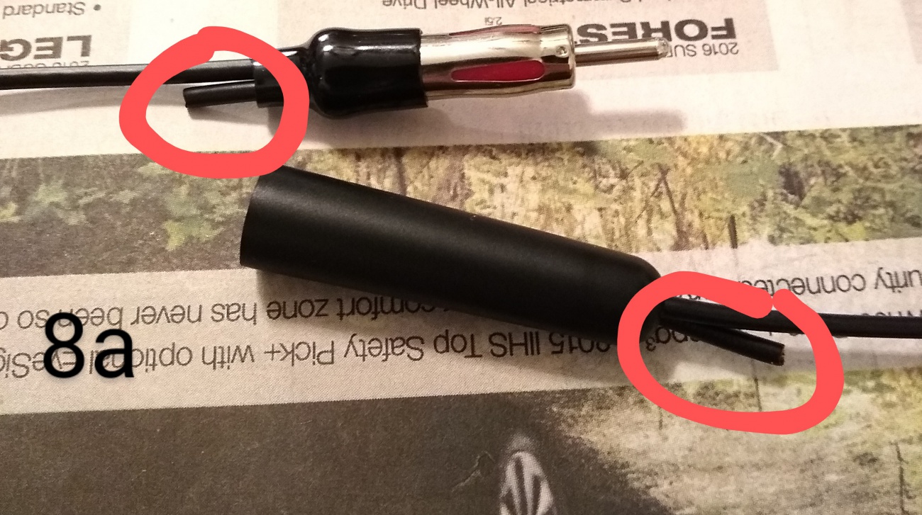

8) Cut the Lexus-only black male and female plugs from the Motorola antenna connectors, leaving about 3/4" of antenna cable sticking out, pictures 8a and 8b. Strip the outer cable insulation of both "stubs" about 1/4" back and cut the outer shield conductors down to where you cut the outer insulation, pictures 8c and 8d. This is so that the inner antenna conductor wire and outer shield conductor wires can't touch each other, picture 8e. If they do touch, you will have no AM/FM reception. Heat shrink the two stubs, picture 8f.
Attachment 203105
Attachment 203106
Attachment 203107
Attachment 203108
Attachment 203109
Attachment 203110

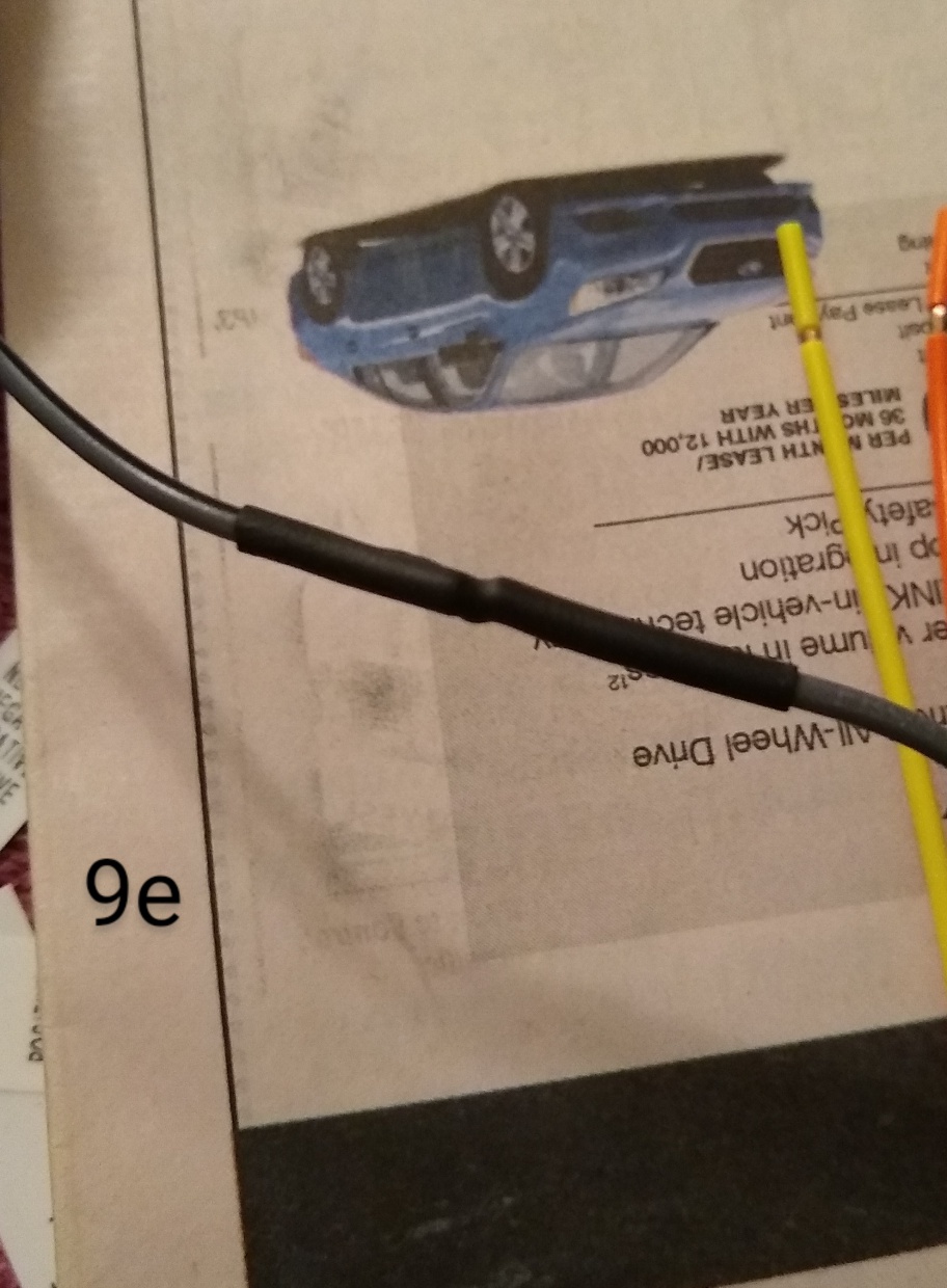

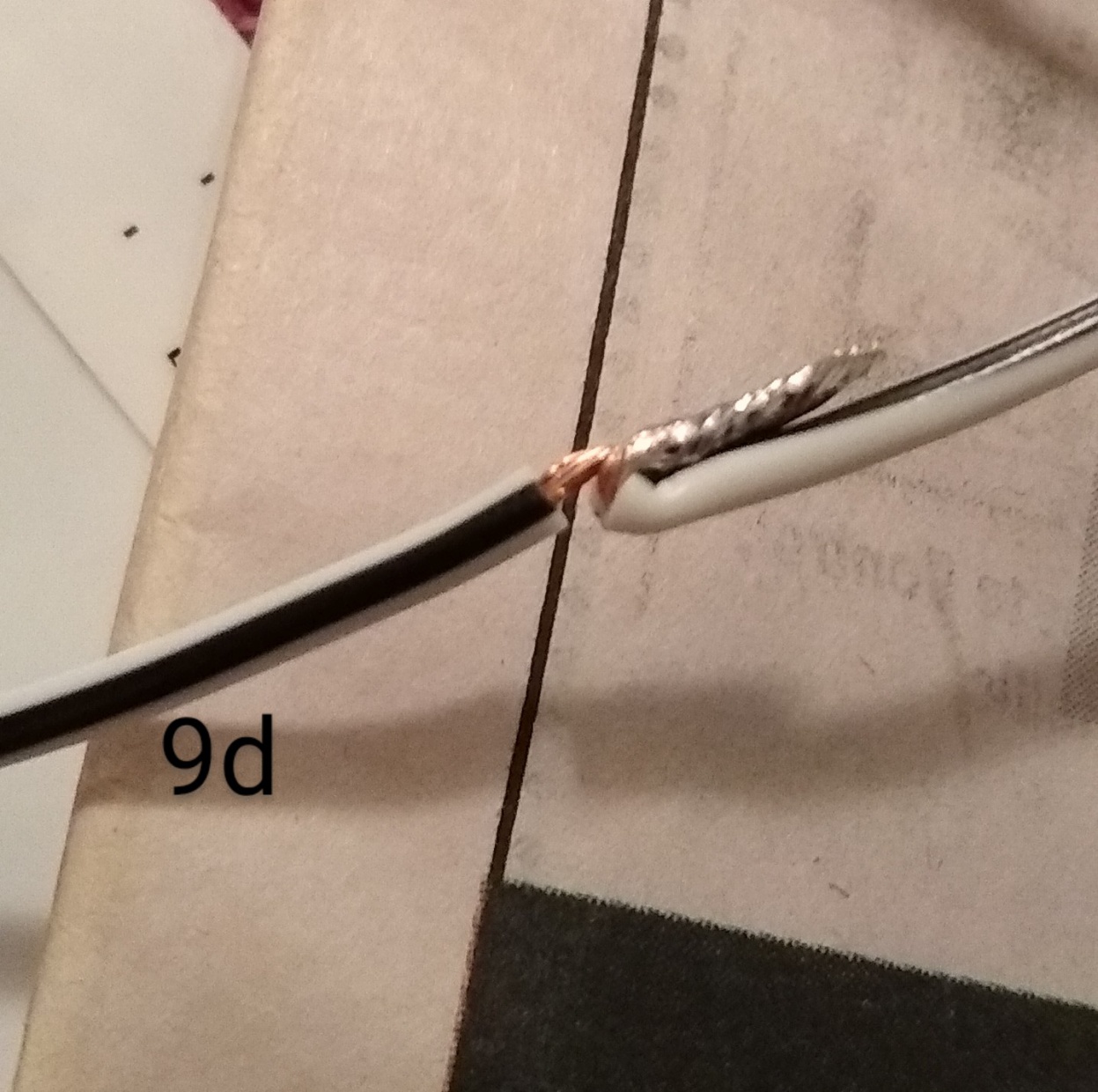

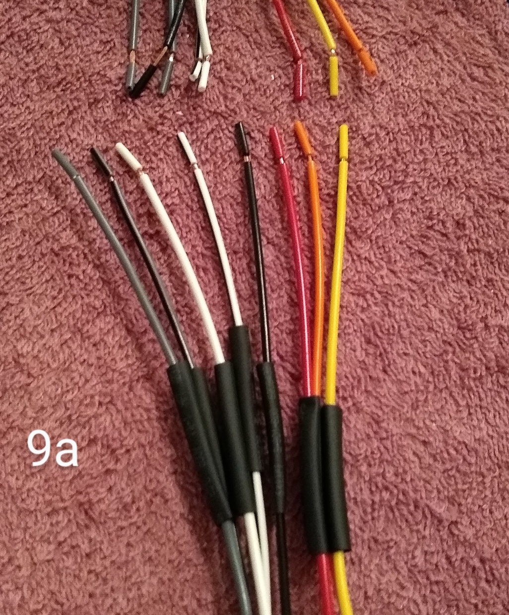

9) Grab some 1/8" heat shrink tubing and cut enough pieces about an inch and-a-quarter long to slide over each wire on one of the 10-pin harness plugs, picture 9a. Begin soldering each color-coded wire from each of the two 10-pin harnesses together. My preferred method is to twist the wires together 9b, solder 9c, then bend one of the wires back 9d, and heat shrink 9e. All three of the blue wires between the 10-pin female harness and the two antenna harnesses will also be soldered together. Use your favorite soldering tool and preferred method of soldering and heat shrinking. During the soldering process, orient the female plugs on one side of the assembly and the male plugs on the other, picture 9f.
Attachment 203146
Attachment 203147
Attachment 203148
Attachment 203149
Attachment 203150
Attachment 203151

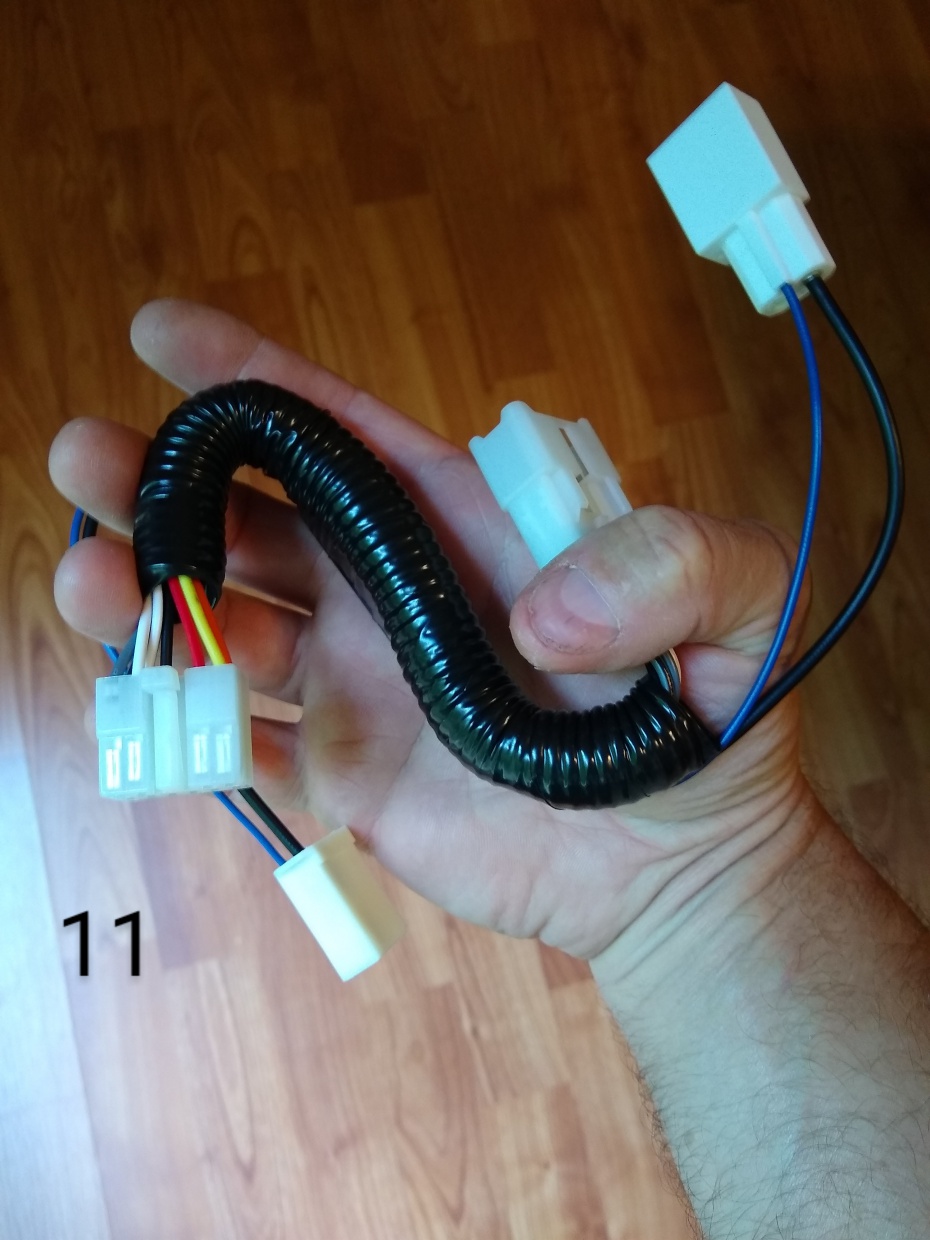

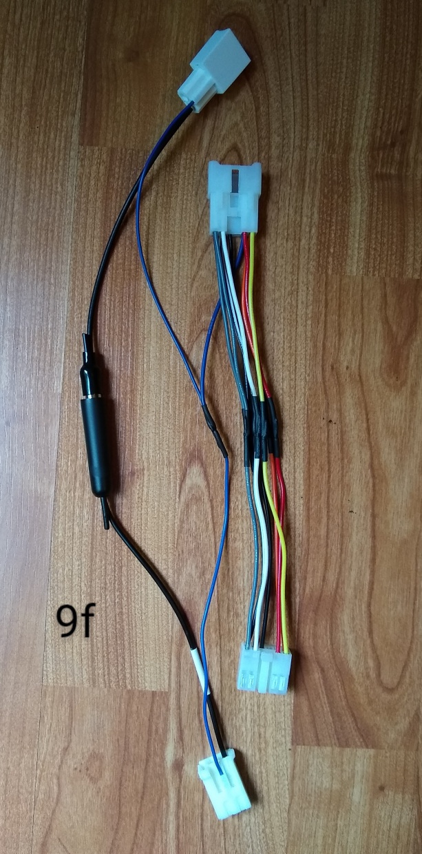

10) Finish your new amplifier re-Integration harness assembly by sliding some 1/2" split loom wire conduit over all of the wires, leaving most of the blue wire and the antenna cables free as you can see in picture 10, to allow the new harness to be plugged into their respective plugs and receptacles. Wrap it up with some electrical tape for a finished product. I labelled the head unit end of the harness because I'm sending this one to Tcoat.
Attachment 203153
11) Your new harness should also be fairly flexible for installation behind the Harman head unit.
Attachment 203173

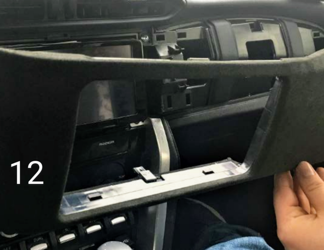

12) Now on to installing the harness. Using your plastic trim removal tools, remove the dash trim from around the OEM Harman head unit.
Attachment 203175

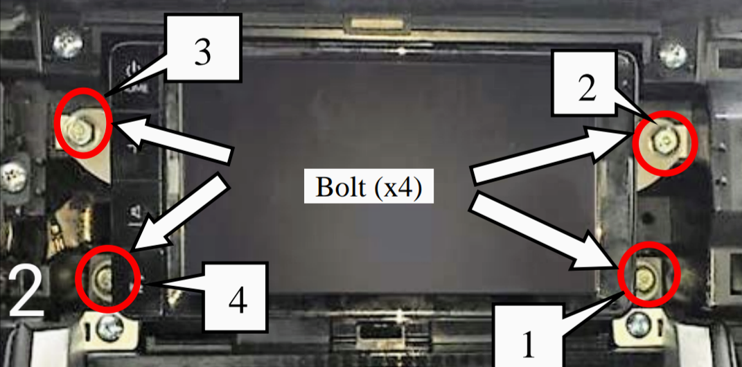

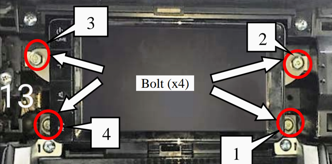

13) Remove the four 10mm bolts holding the Harman head unit in place,
Attachment 203176
and cover your shifter and dash area underneath the head unit with a towel or pillow to keep from scratching either the dash, head unit, or your shifter. Slide the head unit out of the dash opening.

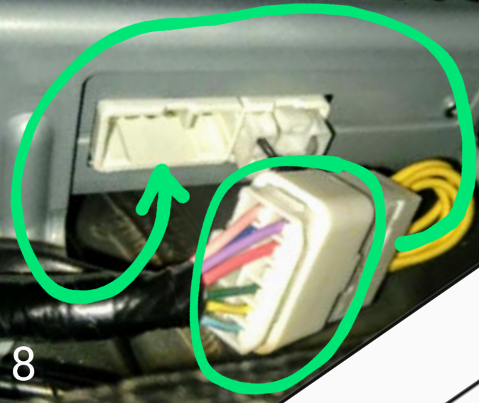

14) Unplug only the antenna connector and the 10-pin connector from the back of the head unit, then allow the head unit to lay on the towel or pillow.
Attachment 203177
14 This is the older OEM head unit from my 2015 FR-S used as an example only. Your Harman head unit will be similarly configured in the back.

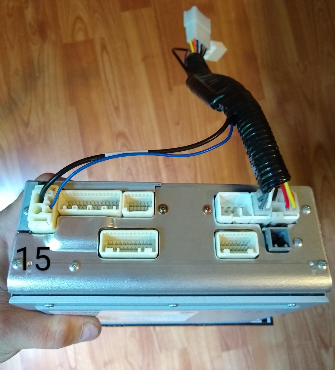

15) Install your newly assembled harness between the vehicles' 10-pin power/speaker and antenna dash harnesses, and the head unit, into their respective plugs and receptacles. They'll only fit one way so you can't make a mistake here.
Attachment 203178
16) Making sure all of the connectors are properly secure, slide the head unit back into the dash opening, resecure it with the 10mm bolts, and snap the trim back into place.

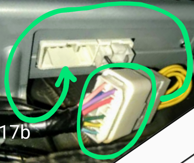

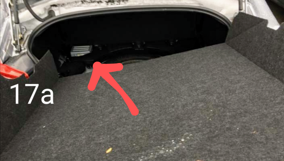

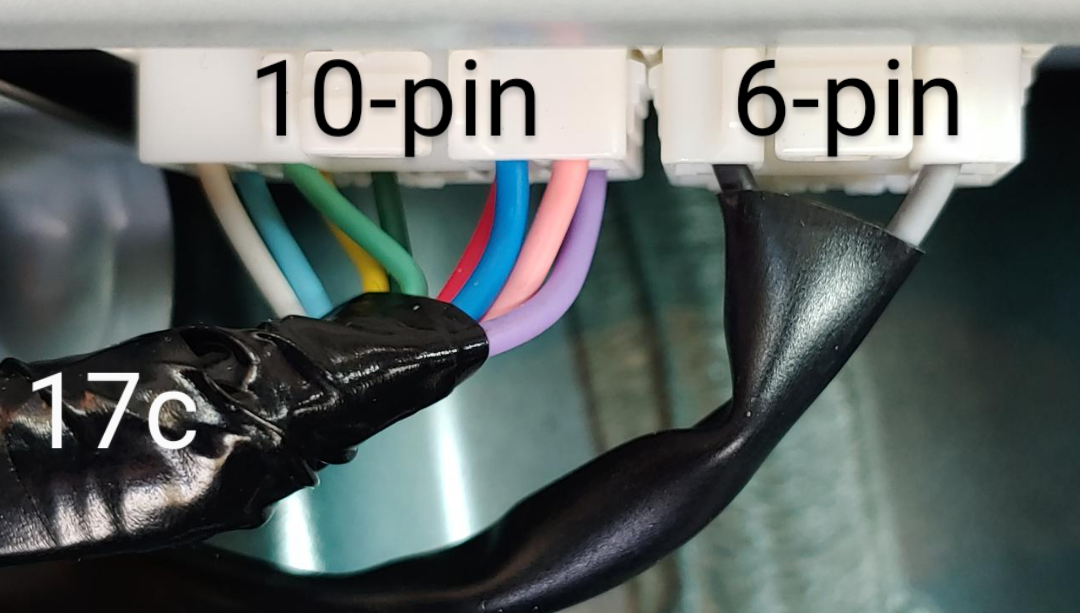

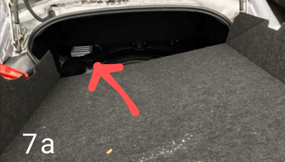

17) Lift your trunk floorboard to access the OEM door speaker amplifier,
Attachment 203179
unplug the yellow-wired bypass/jumper plug from the 10-pin amplifier harness if it was installed, and plug the male 10-pin amplifier harness into your OEM amplifier.
Attachment 203180
Make sure the 6-pin amplifier harness plug is also plugged into the amplifier.
Attachment 203181
You will no longer need the bypass plug, but retain it so that you can reinstall it just in case you have to take your car in for warranty service related to the audio system, though I predict that you will never have to do this, as most dealer technicians will be clueless as to how this Harman system is supposed to be set up.

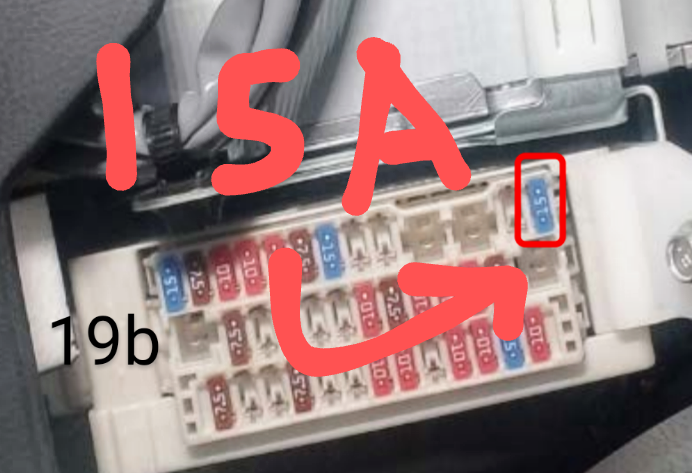

19) Install a 15-amp fuse into the AMP position inside the under-dash fuse panel,
Attachment 203182
Attachment 203183
You're all done! Enjoy your new and improved OEM Harman audio system. Turn it on and give it a listen.

1) Disconnect the vehicle's negative terminal from the battery. Remove the dash trim from around the OEM Harman head unit.
Attachment 202539
2) Remove the four 10mm bolts holding the head unit in place,
Attachment 202540

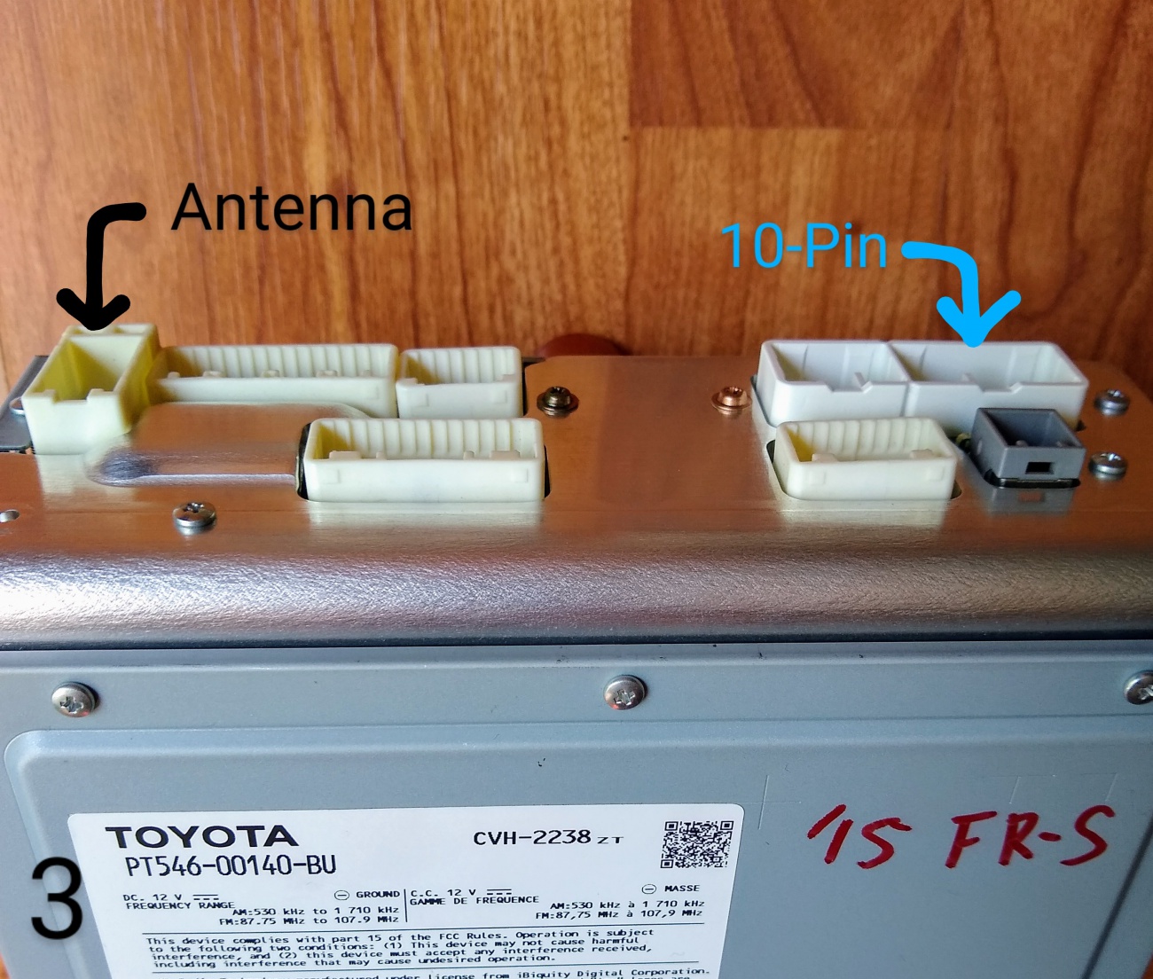

3) Unplug only the antenna connector and the 10-pin connector from the back of the head unit, then allow the head unit to lay on the towel or pillow. In order to allow yourself more working room, you may want to completely remove the Harman head unit from your dash opening. If you do, make sure to take notes of how many plugs you remove from the head unit, and where each of those plugs are supposed to go.
Attachment 202541
Note that this illustration above is my personal OEM head unit from a 2015 model year. Your Harman head unit will be slightly different, with possible differences with the individual plugs, but the 10-pin connector and the antenna connectors are the same as the older head units, which will be the only plugs we will be working with during this procedure.

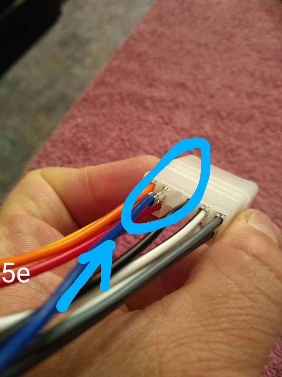

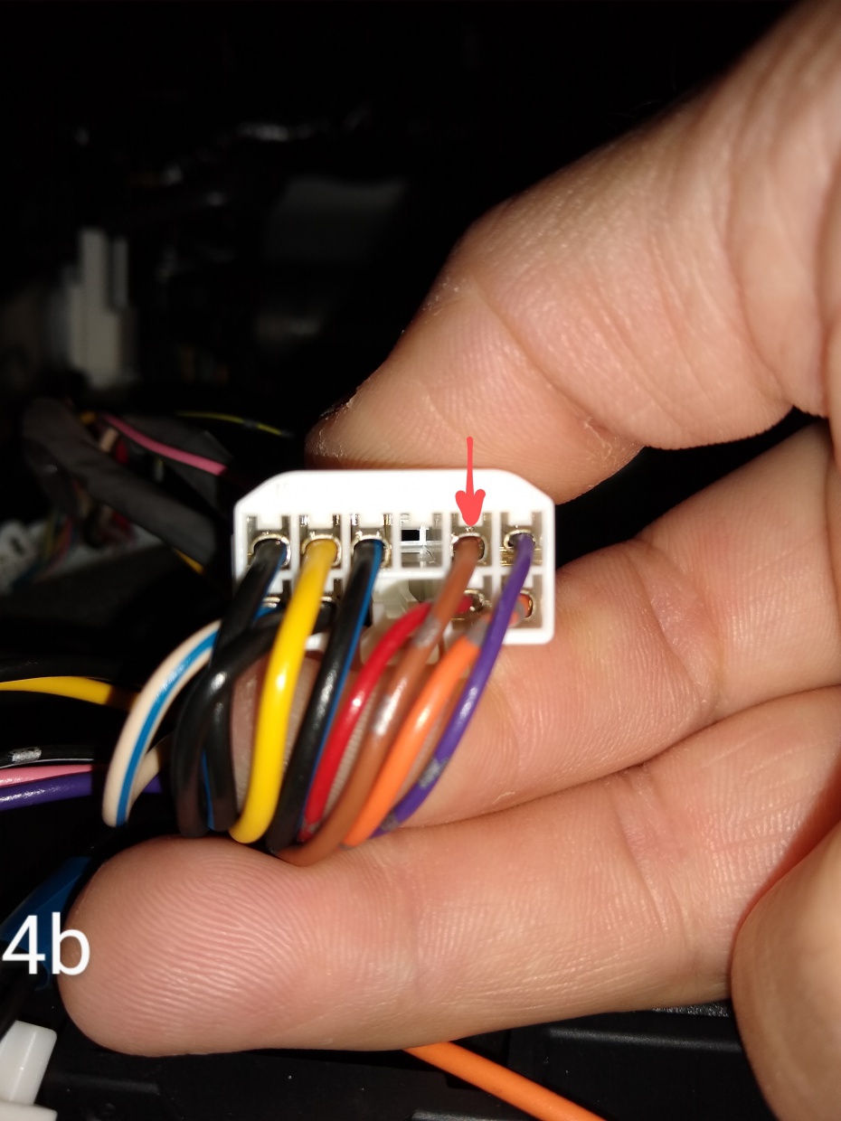

4) Either de-pin the wire from the ten-pin plug as indicated in the pictures below, or cut that wire about 1.5 inches (3.8cm) from the back of the plug.
Attachment 202542
Attachment 202543

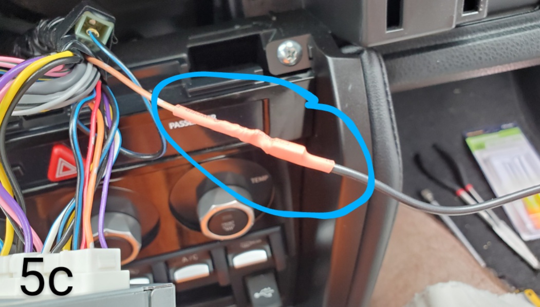

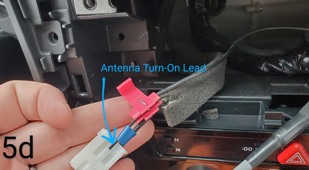

5) Connect that wire (the vehicle-side end of the wire, NOT the plug-side end) to the antenna turn-on lead using a T-tap-style wire connector. It may be necessary to extend the wire first by a few inches, just to give yourself a bit more working length. Use the right tools and materials for a similar electrical repair job to make your connections and to protect the no-longer used wire on the back side of the ten-pin plug, in the case that you cut it instead of de-pinning it. You choose the materials that you are most comfortable with.
Attachment 202544
Attachment 202545
Attachment 202546
Attachment 202547
6) Make sure all your connections are secure and insulated properly, then plug the antenna and ten-pin connectors back into the head unit. Slide the head unit back into the dash.
7) From the trunk opening, lift the trunk floor board up and out of the vehicle to gain access to the OEM door speaker amplifier on your left-side up near the base of the rear seat back,
Attachment 202548
The OEM door speaker amplifier has a ten-pin receptacle and a six-pin receptacle. You should see at least the ten-pin connector unplugged from the amp, and a bypass plug plugged into the ten-pin connector instead.
Attachment 202549
8) Remove this bypass plug from the ten-pin amplifier connector and plug the male ten-pin connector into its matching amplifier receptacle. Make sure the 6-pin connector is also inserted securely into the amp as well. You will no longer need the bypass plug.

10) Install a 15-amp fuse into the AMP position inside the under-dash fuse panel,
Attachment 202552
Attachment 202551
and reconnect the negative battery terminal.

Tcoat 07-21-2021 04:51 PM
OK so...
Package arrived today totally baffling the wife since she had not ordered anything and I always get her to order my stuff so nothing was expected.
Installation time.
Locate trim tool 20 - minutes.
Locate 10mm socket - 25 minutes
Fine a suitable towel to drape over everything - 5 minutes
Disassemble trim, remove bolts, drop HU, remove plugs and install adapter, remove amp bypass plug, steal spare fuse from under hood, install fuse, reinstall trim and turn on car - 6 minutes and 37 seconds
OH
MY
FREAKIN'
GOD!!!!!!!!!!!!!!!
It no longer sounds like a tin can filled with marbles! The door speakers now have sound independent of the dash and they are actually woofers again.
If you are on the fence about doing this just do it. Do it now!
So, so so, many thanks to @FR-S2GT86 , @oddrelic and anybody else that contributed to this project!
