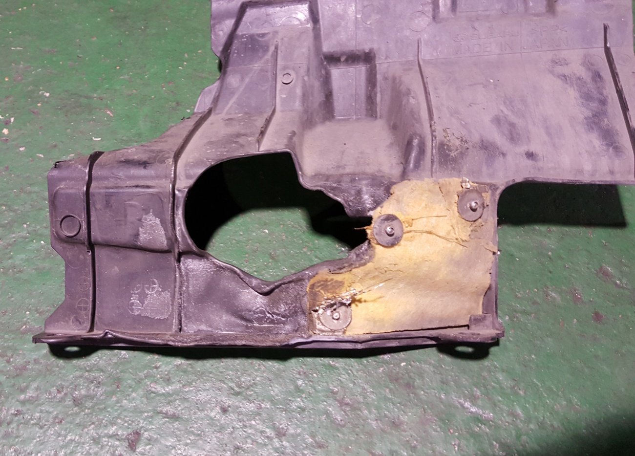

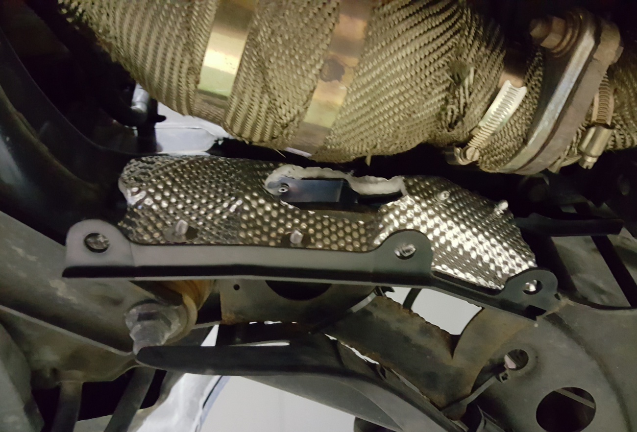

makinen 06-19-2021 08:06 AM
2 Attachment(s)
The earlier version of our twins has smaller heat reflect cover than the later versions.
I experienced the same melted plastic cover, so changed to new part and substituted the heat reflector with DEI's.
Attachment 202138
Attachment 202139
The new part numbers are,
UNDER COVER-SIDE,RIGHT
56440CA032 (56440CA030; 56440CA031)
COVER, ENGINE UNDER, RIGHT
SU00306486
