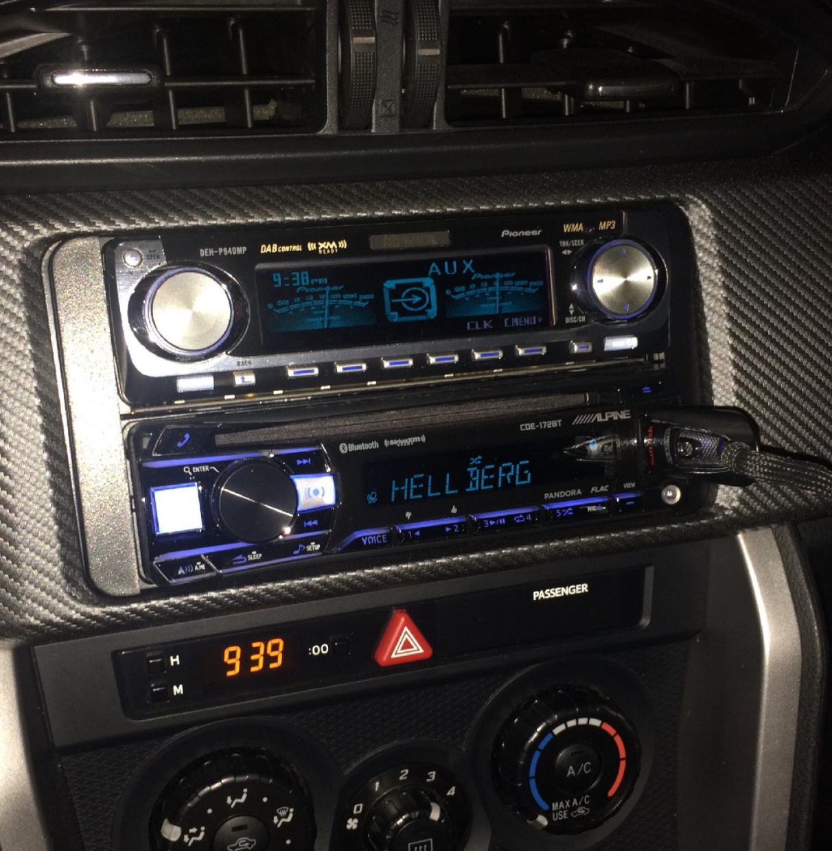

I had this single DIN Pioneer unit (top)
Attachment 200787
mounted in the glove box of my Torino about 12 years ago, and the Torino had a smaller glove box than my FR-S so I expect that it can easily be done.
That Sony unit that you're looking at does not have an internal amp for speakers. Be prepared to install additional outboard aftermarket amplification if that's the one you choose. It's considered an audiophile quality head unit.....
