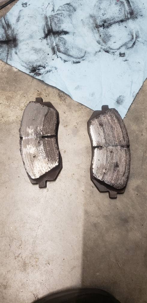

Hi everyone. Long time lurker, first time poster.
I'm hoping someone can help me out. I was recently at Sebring International Raceway for a High Performance Driving event and near the end of the event (5th of 5x 30 minute sessions with a minimum of 1 hour rest in between) I felt abruptly increased brake pedal effort, decreased braking performance, and noisier braking. My pedal was still firm and I was able to just stand on it harder to stop nearly as quickly, but something was obviously wrong. When I went to swap back to my street pads, I noticed that the track pads looked terrible. I believe they are glazed? This was my second track day on these pads and they were only used on the street to get to and from the event which was less than 100 miles each way. I did my best to bed the pads into the rotors with increasingly aggressive braking without stopping (and the cooling ducts blocked) the night before the event as I had previously and they felt great until they suddenly didn't. The only differences from the previous track event where I had no issues to this one were stickier tires (previously Michelin Pilot Sport 4S 215/45/17) and a master cylinder brace. The rear pads look perfectly fine.

Not being able to activate ABS with ds2500 is a problem, something is wrong there, doesn't matter what tire. Hopefully just a thorough fluid flush.
Assuming there's no driving issues (long and soft on the brakes puts more heat into them then short and hard) step up the pads, it does sound like you glazed them, raybestos st43 is the go to srs bzns pad, lots of options out there. Ds1.11 is good but there are pads that handle heat better.
BBK would make sense if you need to stick with ds1.11 for some reason, but it only spreads the heat on a bigger pad, it doesn't change the energy you're dumping into the system and you may need a tougher pad anyway.

Cheers, nothing stands out in the vid, time to try a new pad imho.
Real brake ducts will help, pipe the front bumper inlet to the disc, shouldn't break the bank.

I'm willing to bet you just got a bad batch of brake pads.
Contact Ferodo about the situation and they will probably send you replacement ones.

You shouldn't have an issue with DS1.11 pads. However, if you were running with the nannies on, you will abuse your brakes more. The main tool the nannies use is individual wheel braking. The meat ballast in the passenger seat will use more brakes as well. Perhaps you are just becoming more experienced and using more of the car? Upgrade to the AP Racing Sprint kit. You will be glad you did. The pedal feel and consistent performance are incredible. I was one of the best mods I did to my car. I don't believe a simple brake pad change will get you satisfactory results. At least not at Sebring. Sebring is tough on brakes. And everything else on the car for that matter.

Sebring is a pretty rough track that can murder brake setups quite easily. There are other pad compounds available outside of the Ferodo application that will function well for your application and don't need ducting to work.

Look at CSG pads to be honest.
Grady 04-13-2021 06:53 PM
Yep you exceeded the ability of your pads. Good news is you did not exceed the ability of your brakes(No brake fade/no boiling). CSG will be able to get you a better pad. Make sure your fluid is changed often and good quality. With better pads you next weak link could be the brake temperature.
