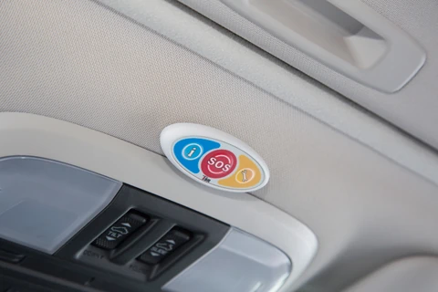

Turns out battery was drained by ISR system which couldn't connect through concrete garage walls and drained above average power. ISR (autonomous emergency notification device) is mandatory in EU for all new vehicles so my BRZ has it added as external module which probably isn't integrated really well with car circuitry and doesn't care about draining battery.
ISR is small device like this, attached to ceiling:
https://ocdn.eu/pulscms-transforms/1...LNAeAAwsOBoTAF
Case closed.
