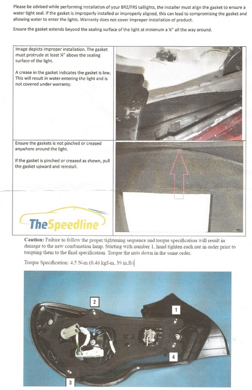

Whatever method you use to dry these out you will probably get water spots on the inside of the lights.
I had a dent in my trunk fixed. They had to remove the original tail lights to fix it. After they re-installed them, incorrectly, they washed the car and got water in the tail lights.
After removing them, I pored a small amount of distilled water into the light socket hole, rotate the socket counter-clockwise to remove it, and rinsed the inside several times. I used my wife's hair dryer to dry the inside of the lights. No water spots.

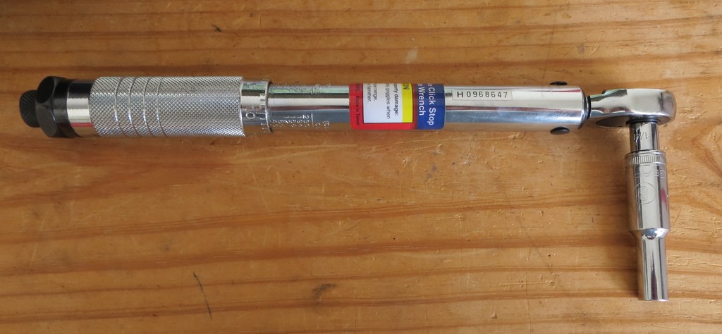

Three years ago I replaced the originals with Valentis. So far no leaks. If installed correctly and the bolts torqued to spec they should not leak.
Attachment 196929
Cheapo Harbor Freight torque wrench and 20% off coupon
https://www.harborfreight.com/14-in-...nch-63881.html
https://www.hfqpdb.com/view_coupon/54104
Attachment 196928

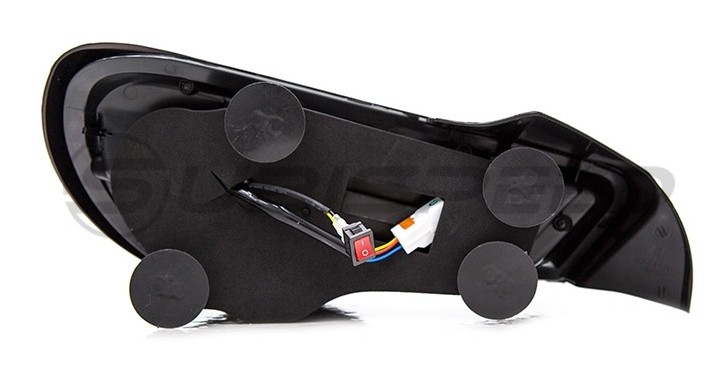

Originally Posted by yoursecondguess (Post 3403037)
I don’t think there’s a light socket for me to pour water out of unfortunately.
Right, forgot these are all LEDs, but there is a cross cut (see pic) where the wires go in that you maybe can add and remove distilled water with a plastic syringe and, if needed, a small plastic hose. Yeah, sounds a little crazy adding water when you are trying to get it out.
Attachment 196949
