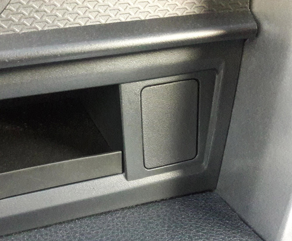

Nails 11-19-2020 11:32 PM
Originally Posted by Mtl135i (Post 3384049)
Sweet. What did you do at the original USB location ? Any pictures of that.
Thanks
I also moved my USB to the center console and ended up removing the old stock location in the dash. I filled the hole with a blank cap. It is a good color match to the rest of the dash. Here is a photo:
Attachment 194971
I purchased the part off ebay and here is a link:
https://www.ebay.com/itm/FOG-LIGHT-S...-/301875813666
