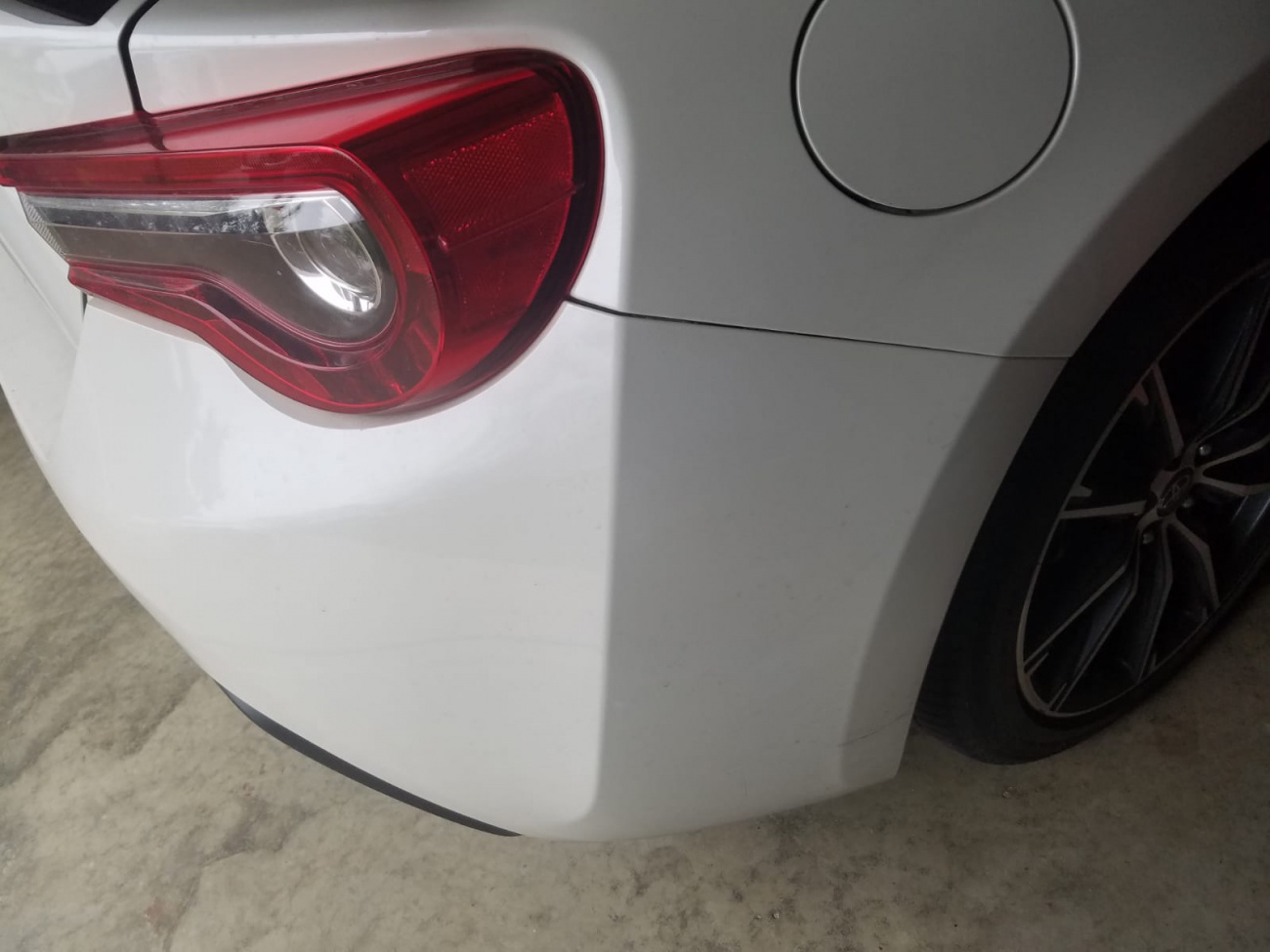

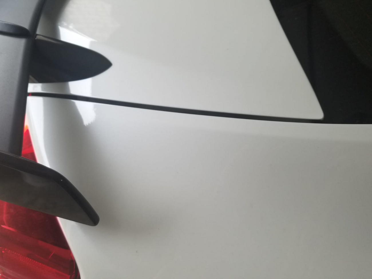

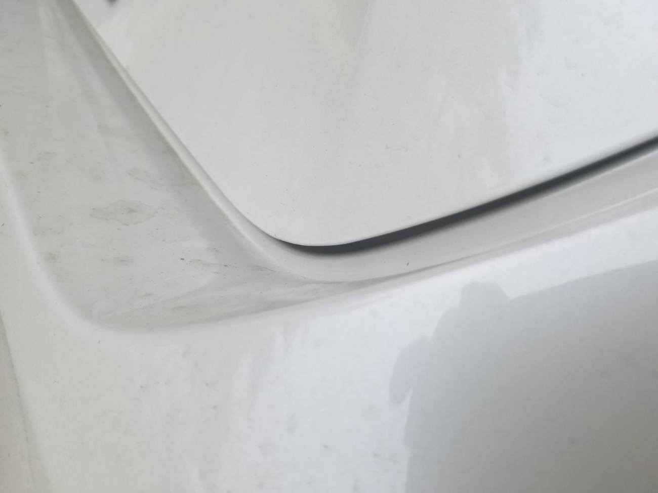

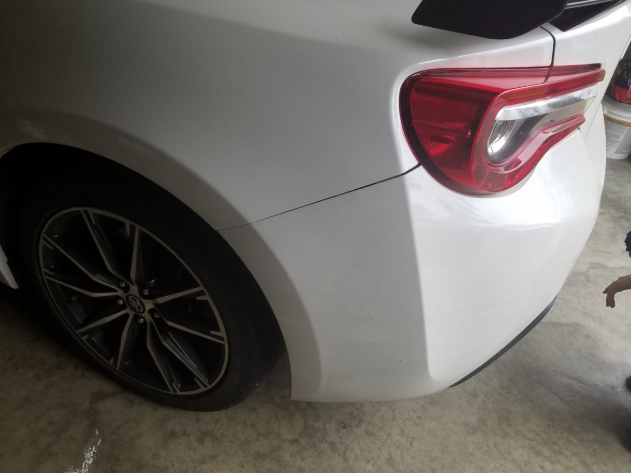

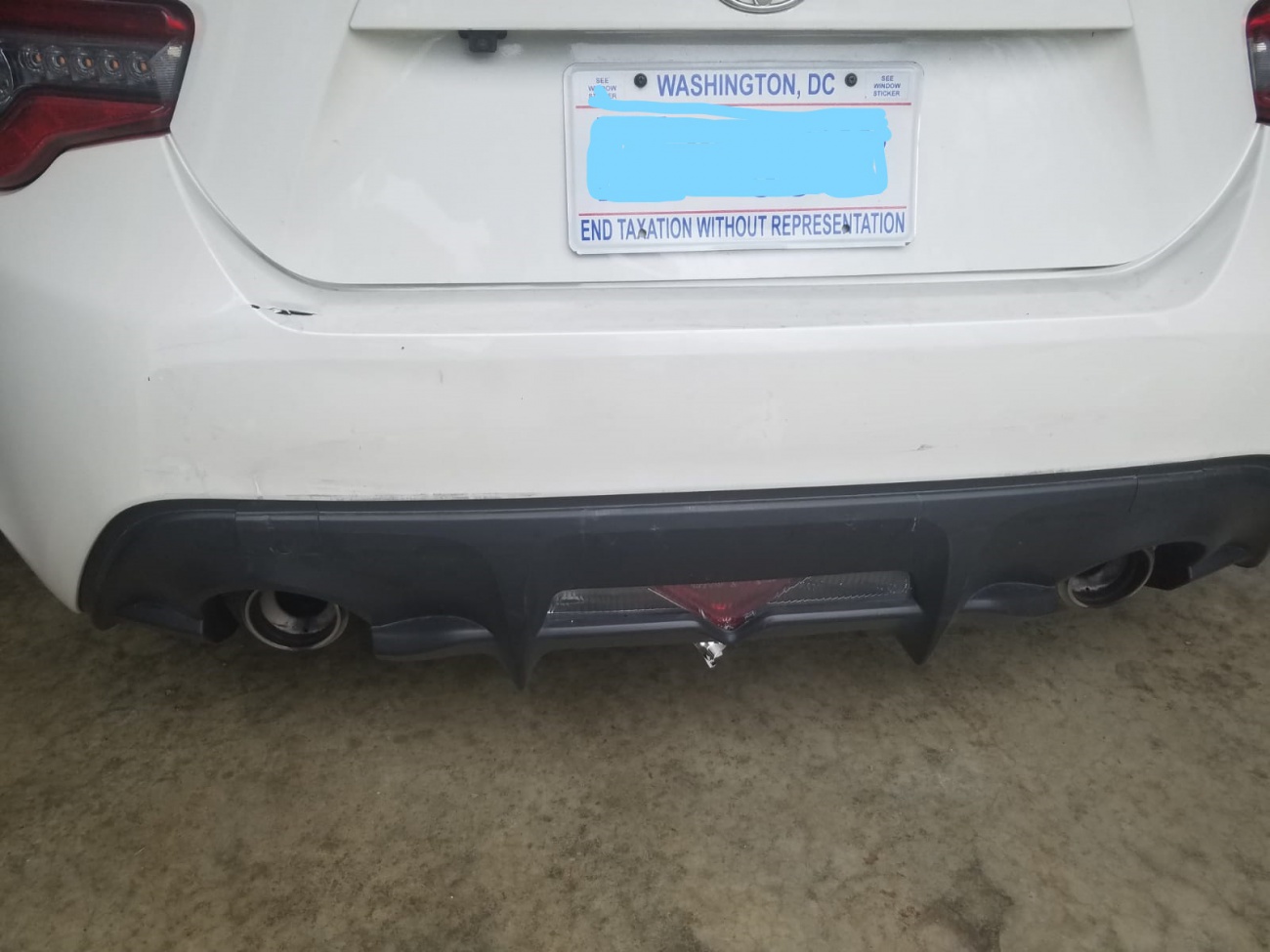

Well, it happened. My 2018 GT86 Black Edition was rear-ended while I was at a stop sign. The driver was kind enough to admit they weren't paying attention and gave me their insurance information. Looks like the insurance is going to cover the damages.
I was wondering if anyone thinks there are some structural damages based on these pictures? The impact seemed much harder than the pictures show (my wife and I suffered whiplash) and the trunk seems to protrude out and doesn't align with the rear panels the way it used to.

Sapphireho 10-26-2020 10:09 AM
Body shop will figure that out for ya.
ArrrBussiere 10-26-2020 11:35 AM
I am a repair manager at a body shop and I can tell you that there is most likely NOT structural damage, but there is a good chance that behind the bumper there are hidden damages.
Impact bars and absorbers are safety items, so any damage what-so-ever to them and it is an immediate replacement, no questions asked.
If I were to take a guess:
- Rear bumper needs to be taken off and inspected. From the pictures, it looks like repair work would be easily do-able but if there are torn tabs then it is a replacement
- Lower rear valence needs to be replaced, those cannot be repaired
- Impact Bar most likely needs to be replaced (we have no absorber)
- Rear bumper guides might need to be replaced (plastic brackets from bumper to quarter panel)
There MAY be some damage to the rear body panel, which will require a small amount of repair work, but that can only be done after the DFR (Disassemble For Repair) where they take the rear bumper off and reassess damages.
Hard to tell from pictures but it appears that the only bad gaps are from bumper to quarter which is a good indication that the rear body panel either has none or very limited damage to it

Spuds 10-26-2020 12:14 PM
This looks entirely cosmetic to me. Maybe bumper bar, and internal supports for the bumper/trunk lid but those aren't a big deal to get fixed.
Dake 10-26-2020 12:40 PM
I'd go with ArrrB up there - looks mild, but our rear bumper cover can hide alot due to its flexibility.
It's likely not structural, but it is probably worse than it looks.
Dave-ROR 10-26-2020 04:43 PM
This. Look at the rear side of the spare tire well to see what damage there actually is to the structure, or just take the bumper cover off. It's likely pushed in there.
