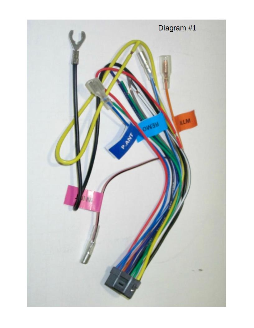

1) "Harness A" is the harness and plug supplied along with your new aftermarket head unit, and which plugs directly into the back of it. Usually, (but not always) there is only one plug/harness assembly included with the head unit which will consist of all four speakers, and all of the power and ground wires. This harness will be brand and model specific to the aftermarket head unit and is not going to be interchangeable between other stereo brands. They MAY be interchangeable between SOME MODELS within the SAME BRAND, but not always. If you don't have this harness, you won't be able to use your new head unit in your FR-S, BRZ or 86 or ANY OTHER vehicle for that matter. You won't even be able to bench test your new deck without it. Diagram #1 is an example of “Harness A”.
Attachment 191561

To summarize what I have explained about the harnesses and antenna leads so far, we have:
"Harness A" = aftermarket head unit
(see Diagram #1 above)

First, look at your "Harness A". Does your harness have a blue wire with a white stripe? Does your harness have a solid blue wire with no stripe? Does your harness have BOTH a white-striped blue wire AND a solid blue wire? Both of those wires are +12 volt OUTPUTS from your new aftermarket head unit (if indeed your “Harness A” has both wires). They are very similar in appearance and function, but the difference between these two wires is WHEN they supply their +12 volt power to whatever they are connected to.
EXAMPLE #1: “Harness A” of my Alpine head unit has two +12 volt, turn-on OUTPUTS. It has BOTH a solid blue wire AND a blue wire with a white stripe. The SOLID BLUE WIRE connects to a power antenna, and will ONLY supply +12 volts when the source is switched to the AM/FM tuner. If any other source is being used, or if I turn off the head unit with its’ power button, or turn the car off using the push-button or ignition key switch, the +12 volts on that SOLID BLUE output wire is de-energized. On the other hand, the BLUE WIRE WITH WHITE STRIPE connects to an amplifier turn-on lead, and will supply +12 volts WHENEVER my Alpine head unit is turned on, REGARDLESS of the audio source that I am listening to. This makes sense as it keeps the amplifier on at all times until I turn the Alpine head unit completely off with the power button, or turn my car off with the push-button or with the ignition key. Note: My FR-S has only a key to start and stop the engine, no push-button. Your vehicle may have either the key or the push-button.
EXAMPLE #2: “Harness A” of my Pioneer Premier head unit has ONLY a blue wire with a white stripe. This BLUE WIRE WITH WHITE STRIPE connects to an amplifier turn-on lead, OR a power antenna, OR BOTH. But just as the Alpine head unit in my first example above, WHENEVER my Pioneer Premier head unit is powered on, and REGARDLESS of the source, this blue wire with white stripe will continue to supply +12 volts to whatever it is connected to, and will de-energize ONLY upon turning the head unit off or turning off the car. Pioneer in this case, has elected to design their head unit to power on BOTH an amplifier AND a power antenna simultaneously with one +12 volt turn-on OUTPUT. It’s not right or wrong to design their head unit this way, it’s just more simple for them to do so.
