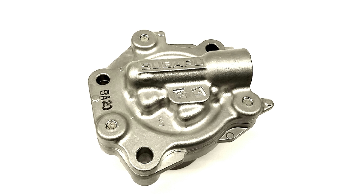

I used the factory wrx oil pump that runs off the cam to pump oil through a oil cooler.
The factory wrx oil pump is a scavenge pump for the OEM turbo.
One of the aftermarket turbo kits for the brz comes with the wrx pump.
I also used a electric fuel pump for oil scavenging on my gsxr1000 turbo I built. Had to build a oil box below the turbo and run a breather to it. Without the breather the turbo would stop spinning at idle with the pump running. I figured it was sucking the turbo bearings dry which caused it to stop spinning.
solidsnake11 07-16-2020 07:57 PM
. I never had a problem with the silicone hose drain on my fa20 or any turbo car, truck or bike I used it on, rubber on the other hand would only last a month or so before it turned to gel.
This is the OEM WRX pump

If your talking about the wrx pump, just for the turbo.
It would require an adapter plate and hose running to the turbo. The pump returns through the head so it sucks the oil through the line and pumps it into the head. The turbo might need a small box like the factory setup and my bike with a breather line.
My fa20 and the gsxr1000 had oil cooled turbos.
I just know when I turned the pump on the bike it would stop the turbo at idle, soon as I turned it off it would start spinning again. After I built the box with the breather the pump didn't effect it. I was just letting others know to check it, if they run a scavenge pump on the turbo.
A lot of the remote mount turbos have the little box returns on the turbos and so does the wrx.
