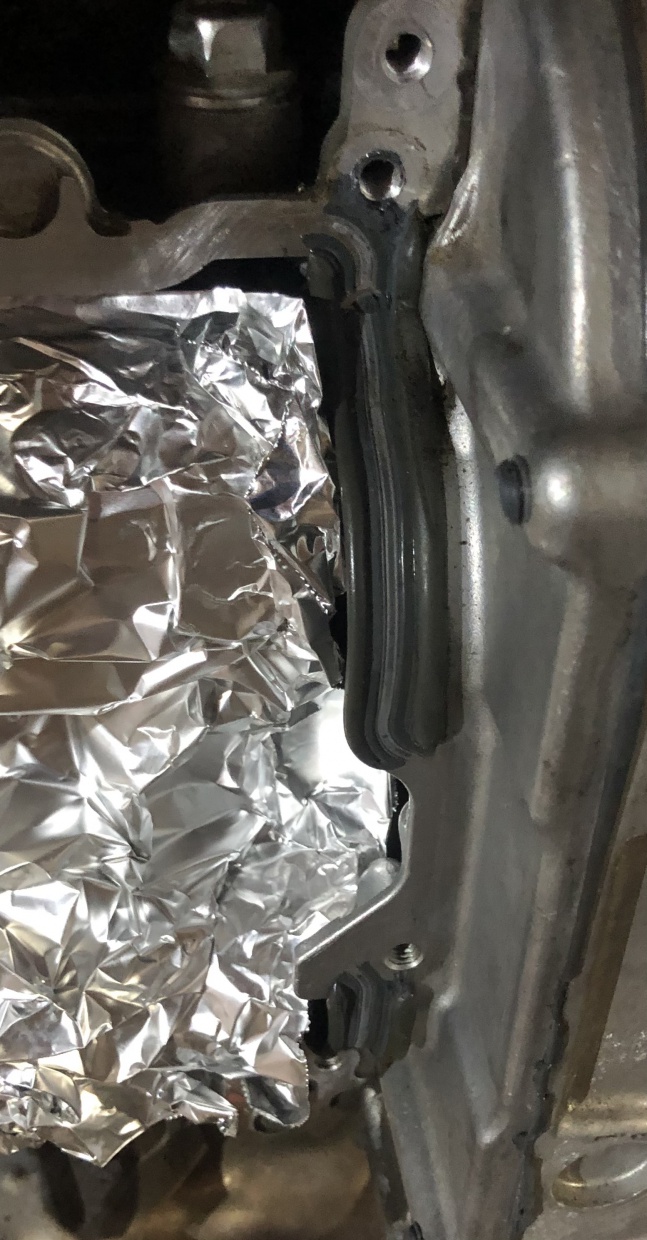

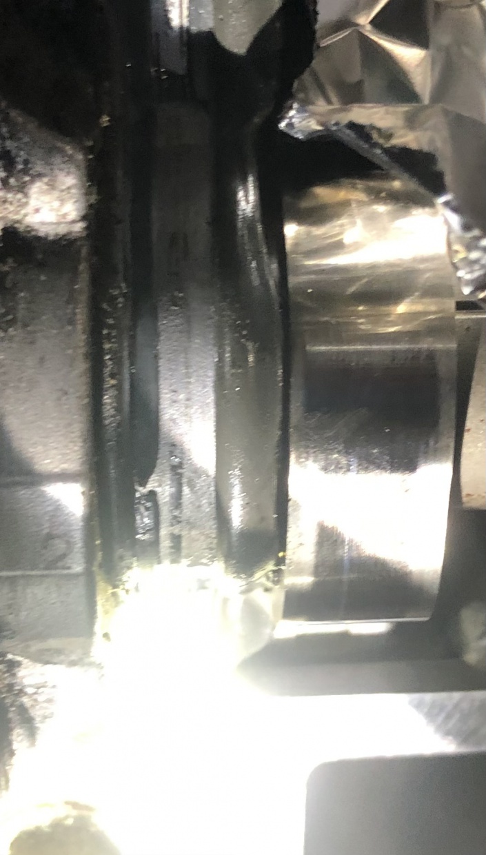

BrZ_Good 12-24-2021 03:33 PM
2 Attachment(s)
Here’s the factory seal on mine. Seems excessive, but effective. It was the plug tube that failed on me. Looks like even touched the cam, I put a smaller bead. Attachment 208093
Attachment 208094
