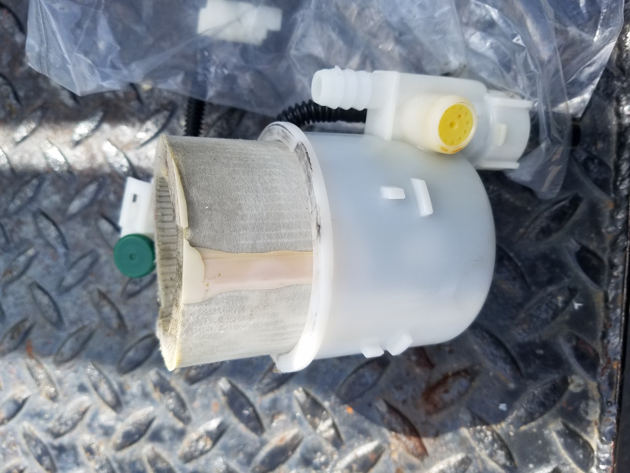

Fuel filter is part of the hanger assembly and is "no serviceable". I considered it myself but a plugged filter accounts for poor pressure, but not the rapid loss

May still be the filter its in the tank. The filter is the part the fuel pump slides up through.
Attachment 189790
