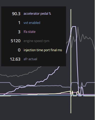

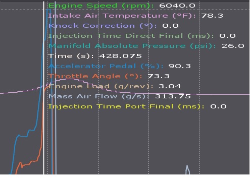

solidsnake11 05-27-2020 07:43 PM
2 Attachment(s)
I looked at the logs closer and its fuel cut?
6040rpm at 3.04 g/rev
90% throttle and 0 ms fuel
Attachment 188681
Attachment 188682

tomm.brz 05-28-2020 07:39 AM
ok,
tune is ok but there is a bug , probably because you patched it with Racerom 12
i had problems with rr12 too, not exactly this, anyway
LFA state changed to a different value, and accelerator is over 85% (that s trigger for launch and flat as standard value) exactly when some sort of fuel hard cut entered, LFA means LaunchFlatfootAutoblip, it s a debug code for ecutek support
It just seems a weird random bug
Delete racerom12, put rr11.1 ,.... if it cuts again, try disabling launch control
if it cuts again, switch to A01G or A02G with rr11.1
