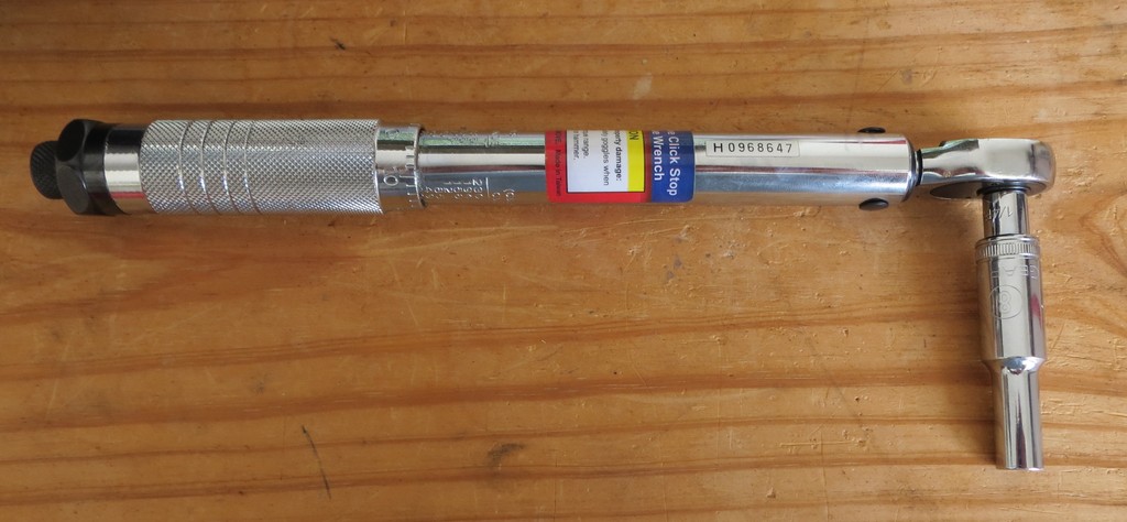

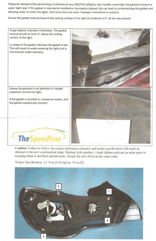

I bought mine and have them for a 3 months. Now we're getting a bit of rain in Cali and my driver side is getting condensation and flooding my trunk. The fitment is off and water is leaking through. Im assuming all the other people who have had trouble with it their LED and whatnot is experiencing the same.
I wasn't aware of the water until recently and mold started growing in there from my car washes.

Last time I'm going to post this on this forum.
Attachment 186484
Attachment 186483
https://www.harborfreight.com/14-in-...nch-63881.html
Got mine for $14. with a 30% off coupon.
