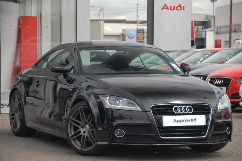

Well, I had my eye on this little TT at my local Audi dealer, but I might just forget it and wait for the FT86:-
http://i194.photobucket.com/albums/z...ine800x600.jpg

Ughk. TT = not serious about handling. They're also way too big and heavy for my money. Go pick up a copy of the latest EVO and read "The Knowledge" and they'll point you in the right direction for a coupe', if that's what you want. For TTS money you can get an Evora or 370Z, something that actually handles good.
